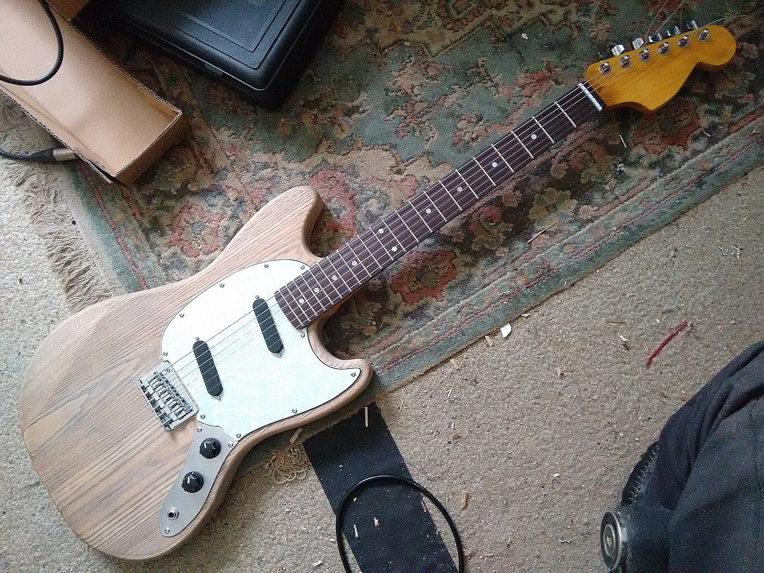

    So first thing is to lay on a watery application of ebony Timbermate.
    A positive to take away is that it highlights any undesirable scratches and defects for sanding out.
    cheers, Mark.

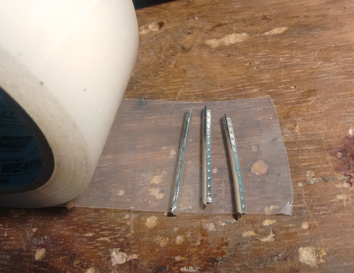

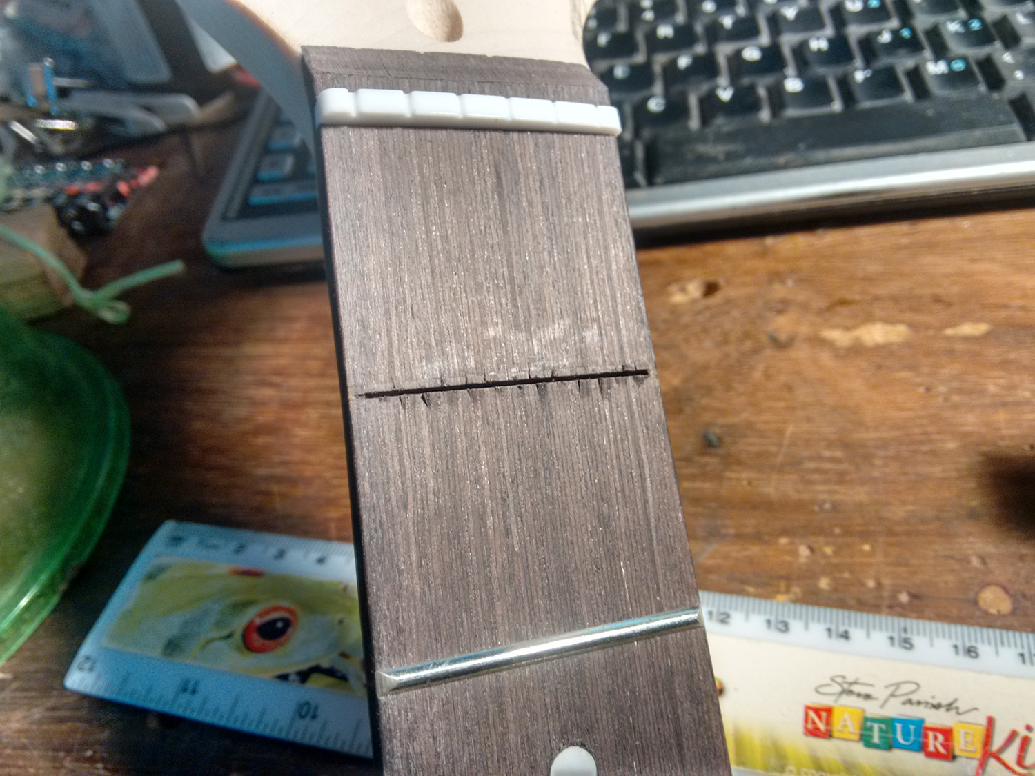

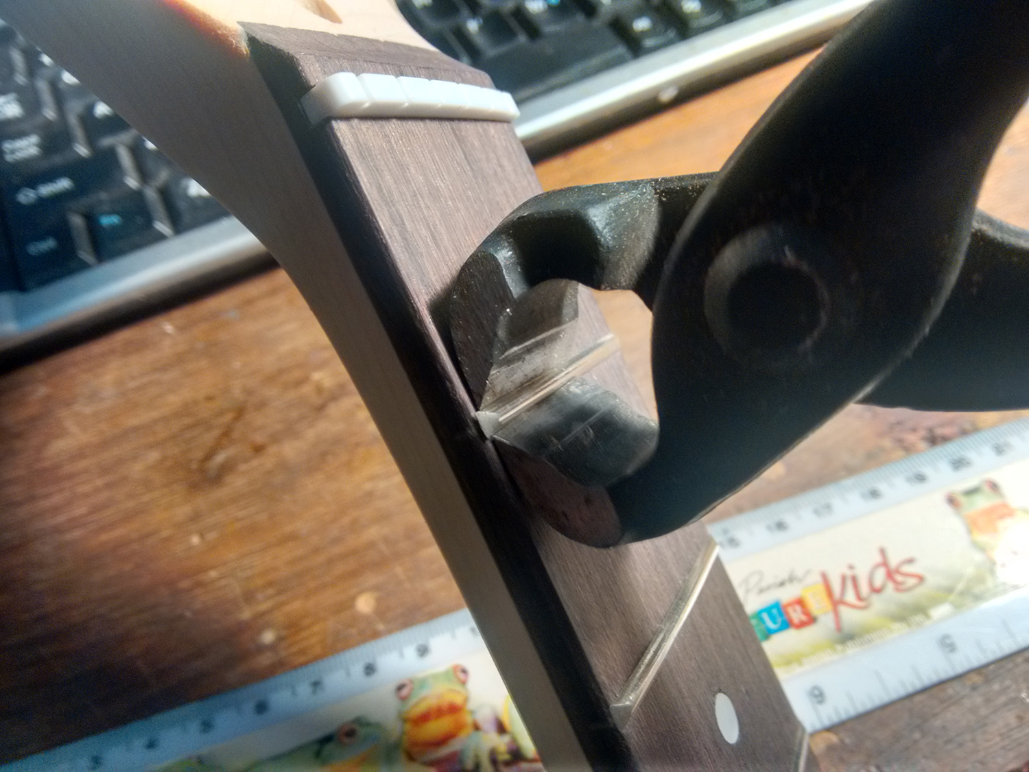

    Let's pull some frets...
    Minimal damage...but remember it's mostly sanded out.
    Keep them in order whilst we go..
    cheers, Mark.

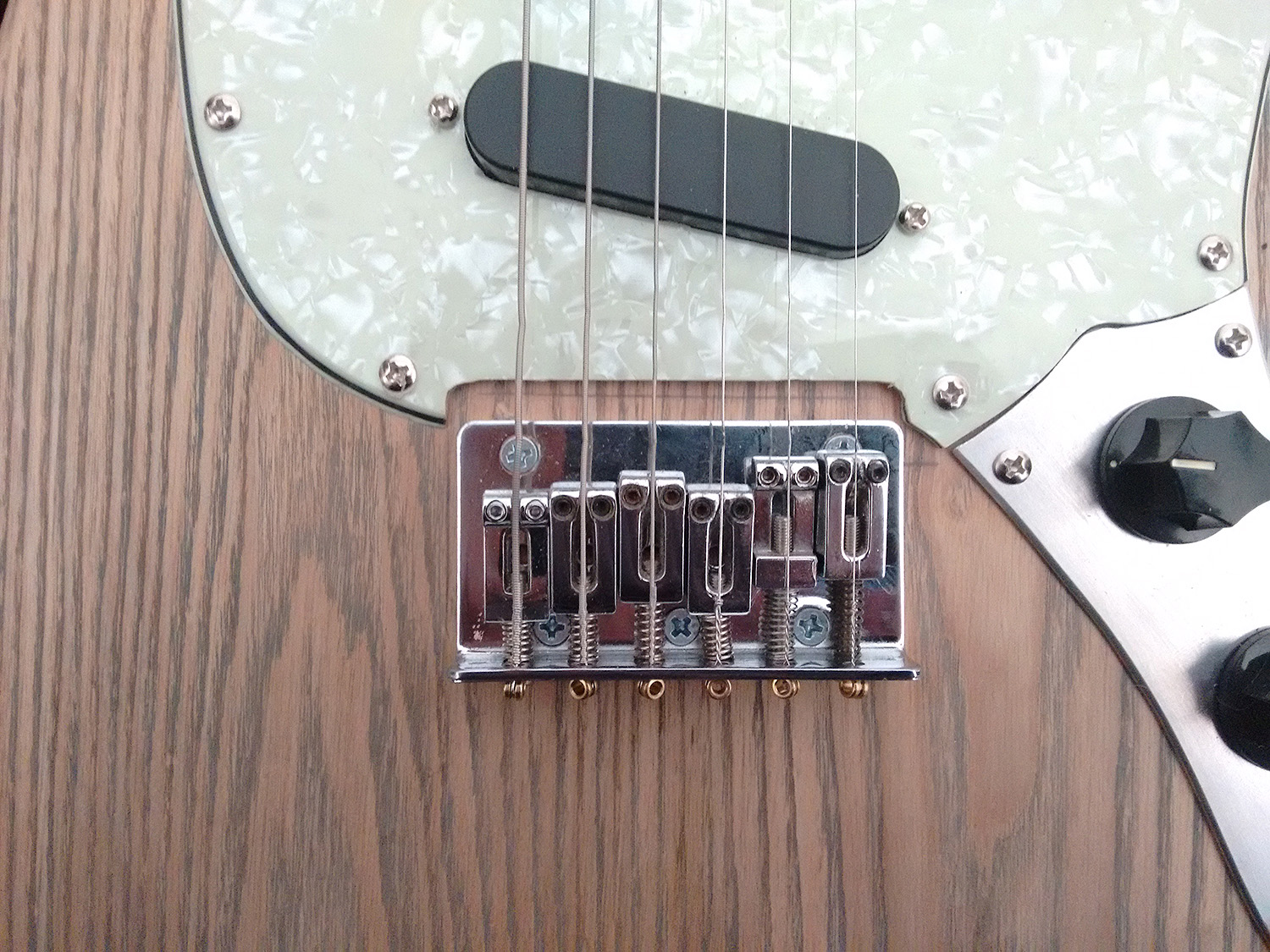

  6. #16

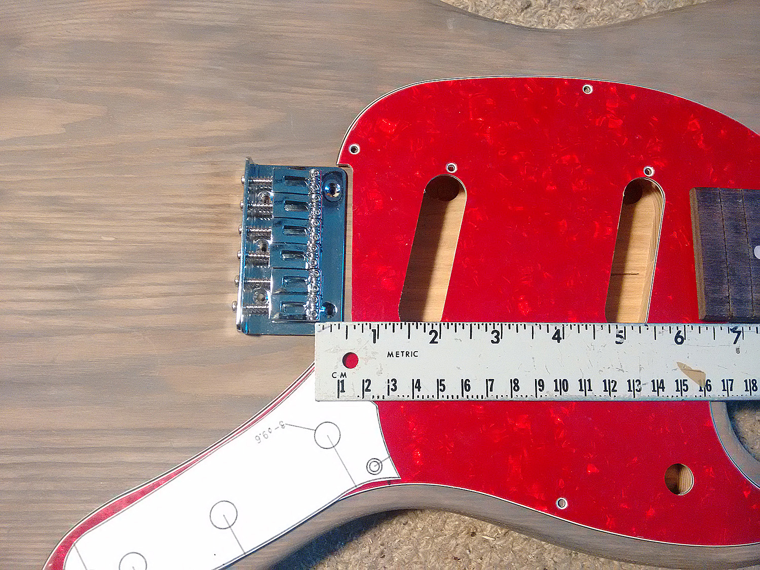

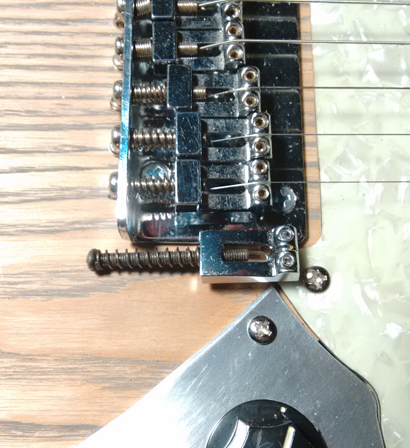

    So to get some perspective regards to scale length...
    Seems to be correct with the bridge over the pre-drilled holes.
    Strange
    cheers, Mark.
    Strange
    cheers, Mark.
    That was the same for me,Mark.
    However once intonated the lowE&A were screwed tightly back.
    I reckon 2mm back would be the right thing to do.

  9. #19
    Quote Originally Posted by OliSam View Post
    That's interesting then Oli.
    So now that you have 'correct' strings on...what is the actual scale distance of your high 'E'?
    cheers, Mark.
