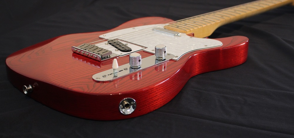

    This ash Tele (TLA-1 kit) is ebony Timbermate and water based dye (ColorTone and U-Beaut) with DIY wipe-on poly.

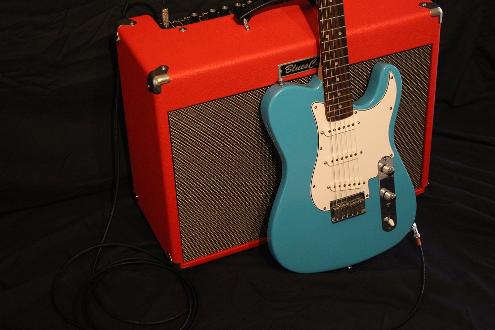

    And this Stra-Tele is Timbermate under acrylic lacquer (over basswood).
Name:	Stra-Tele 3 1k x 666.jpg
    Neither one gave me any problems (apart from the Stra-Tele which got painted 3 times due to other paint difficulties )
Name:	Ash TL flat 1000x472.jpg
    Water based dye is fine, timbermate swells under lacquer it pretty much bad news a month later it will shrink back if your painting a colour why tempt the devil there is better ways to grain fill which has no issues, nice job on the teles 👌
