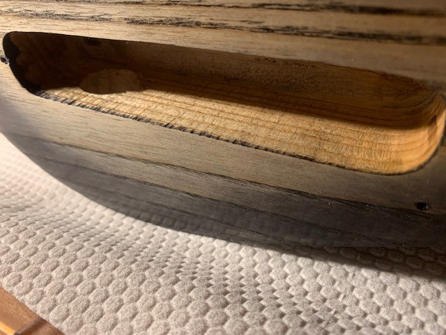

    I find a lot more scratches when actually applying the stain, as it pools in the deeper scratches which really highlights them. Then I can't unsee them, so it's out with the sandpaper, remove the scratches and re-stain.

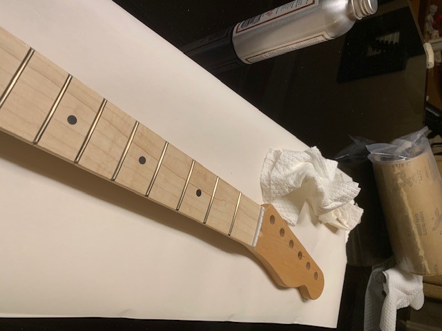

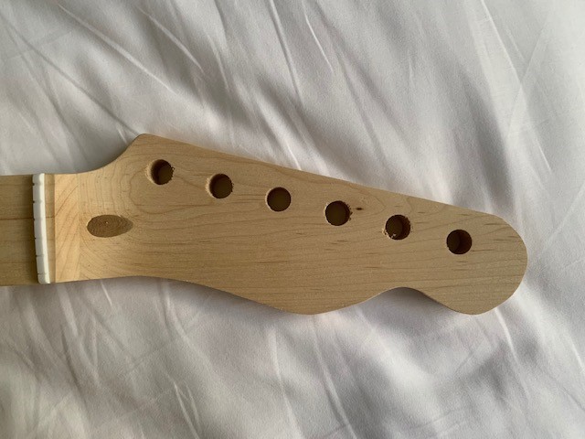

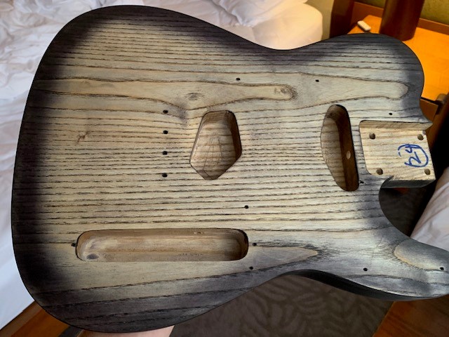

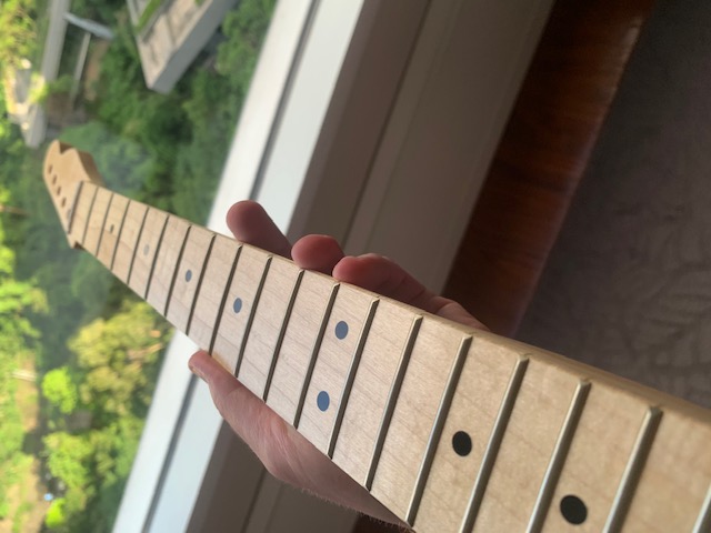

    Between work and life getting in the way and me nearly losing the will to live trying to get the scratches out of the endgrain on the sides, I hadn't done anything on the guitar for a while. So to get back into it I focused on the neck. Printed off a template and spent an hour with a coping saw and sandpaper cutting and shaping. Came out pretty well apart from near the nut on the treble side where I cut slightly inside the line. I was able to more or less mask that with a file and a lot of sanding. First pic is just after cutting/shaping, second pic is from last night with the first coat of Crimson's finishing oil on.
    The fretboard is still raw, I'll apply the oil to it a bit differently from the rest of the neck but it does highlight how much the oil colours the raw maple. It's really humid here and the oil was still a bit tacky this morning after hanging for about 7 hours in my bathroom (I don't have a balcony or even windows that open!) so I think I'll be lucky if I get two coats applied per day.

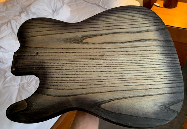

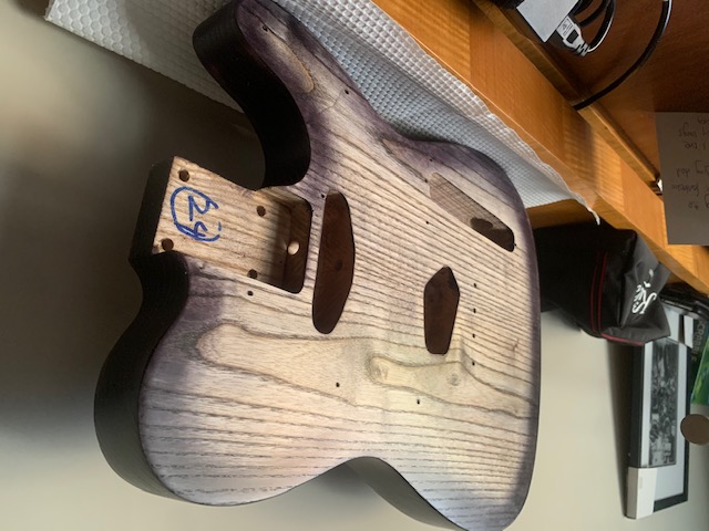

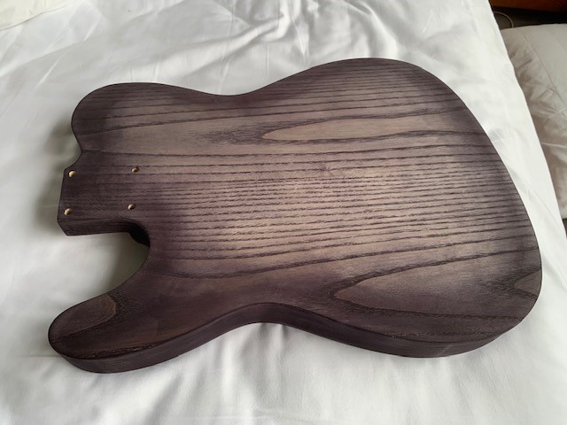

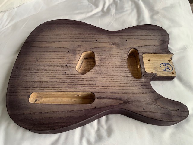

    After getting somewhere with the neck I went back to the body. I finally managed to hide the scratches that I can't seem to avoid putting into the body endgrain by taking a little more time to follow the grain while sanding. It's very swirly so it took a while but it's not looking too bad now. I've given up on removing the factory scratch marks, they're just going to be a feature of the finished guitar.
    I re-coloured the front and back then sanded with 400 grit to try to get a burst. With the way the ash absorbs the stain it's not perfect but it's not too bad either. Tonight I'll go back over everything with 400 to lighten the colour a bit, then redo the colour on the edges to darken them. I'm in the home straight now. Hopefully after tonight all that will be left will be clear-coating, fret dressing and final assembly.

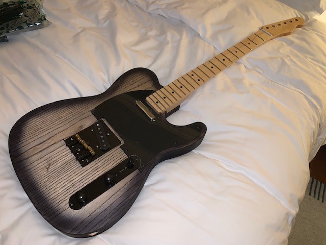

    First coat of oil on the body last night (the colour isn't as green in real life):

    I doused the body in the Crimson finishing oil and used 600 grit (initially) to create the slurry. After just one coat the grain is very close to completely filled. You can feel just the slightest bit of grain when you run your fingers over it. The sandpaper did remove a little of the colour around the edge of the burst and on the sides, though, so I switched to 1200 grit halfway through. I'm not a huge fan of relics, but that bit of it isn't too bad.
    I thought that the colour in the middle would get a bit "dirty" from the slurry picked up from the black parts around the edge and sure enough it did. I considered sanding the colour off and redoing it, but with the hardware dry-fitted it's much less noticeable and I kinda like the overall look.
    I'm going to do another coat tonight, try to get one done in the morning and see how it looks after that. This first application was a soak and grain fill coat, so the finish should start building up from here.
    The neck has had four straight coats of oil and a oily wet-sand with 1200. There's a nice, thin finish on it now which feels surprisingly hard, if a little bit squeaky. I put one very thin coat on the fretboard this morning and I'll do a few more until it feels built up enough. Then on to fret dressing.
