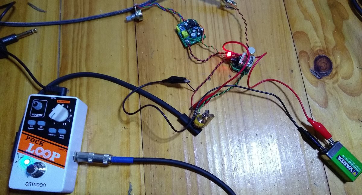

    Testing sans enclosure (cause I haven't drilled one yet):
    The looper is so I had both hands free to adjust the JFET bias trimpot, turn the circuit on and off, and adjust the level to unity. I have read of this pedal being subtle, but this is so subtle I can't tell if it's doing anything at all. I am used to the compression built in to my THR (which I turned off for this test), so hopefully I know a little of what to listen for. Hear it I can't. Just a level boost as I adjust the level pot. The JFETs are doing something, cause the signal cuts out when I adjust the bias trimpot to one end of the range, but after 1/3 the signal returns and pretty much stays the same over the rest of the range. None of the distortion that others report at the other end of the bias adjustment.
    Fortunately I socketed the 2N5457 JFETS so I can experiment with different ones. Some claim that J201s give more compression. I will try a few things that I have lying around to see what happens.
    On the up side, it is quiet.

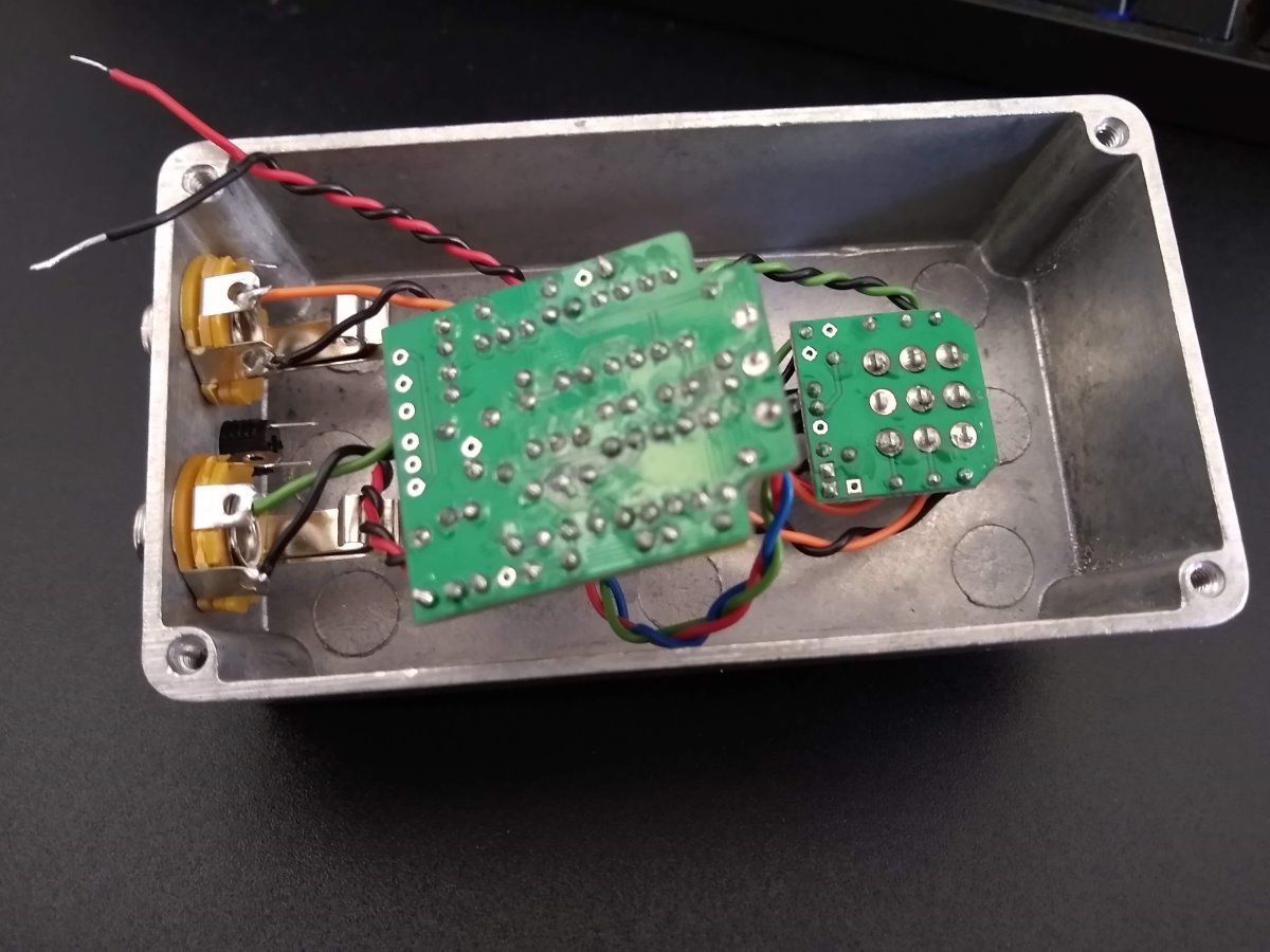

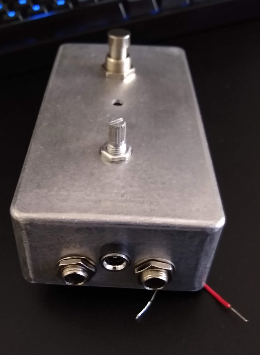

    Enclosure drilled. Some holes slightly wonky but should be OK. Unlike the Barber there is lots of room here (1 pot vs 3 pots and 2 switches).
Name:	drilled and test fit_inside.jpg
ID:	34804Click image for larger version.
Name:	drilled and test fit_outside.jpg

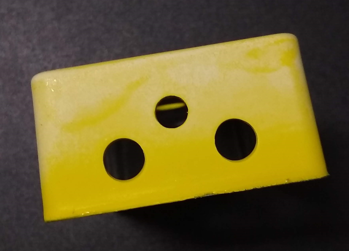

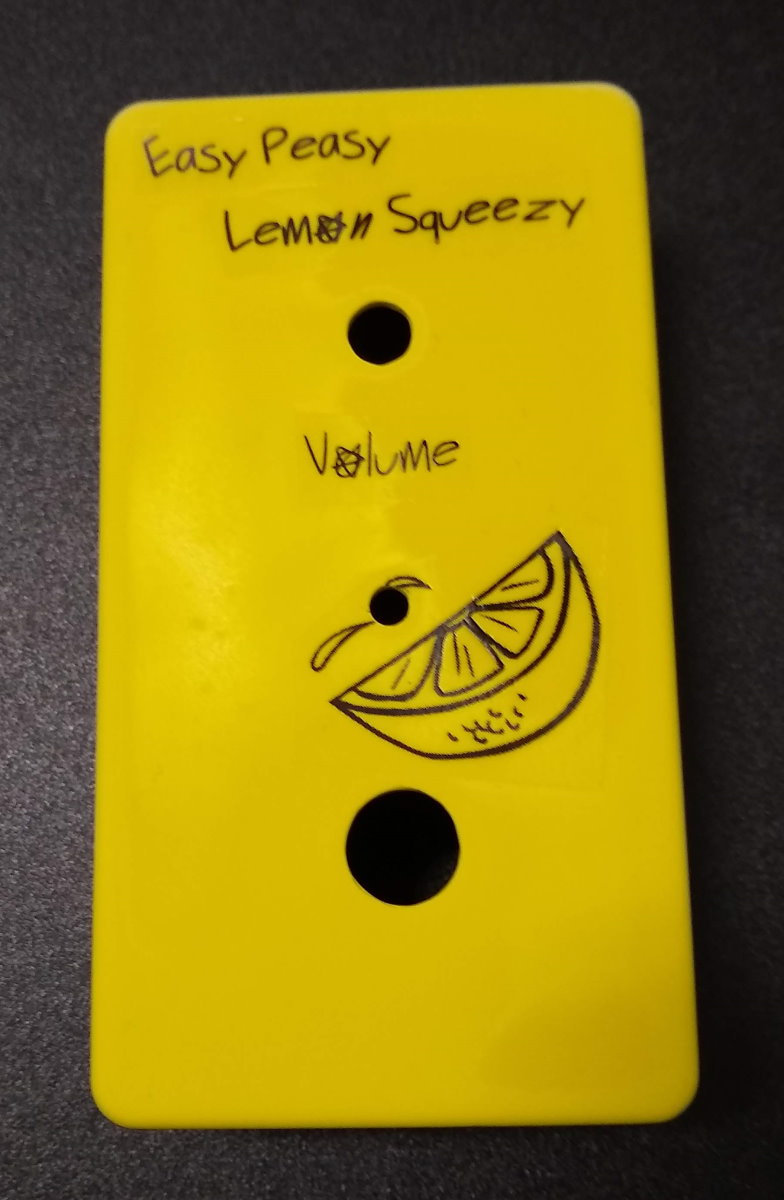

    I decided the Alice Cooper theme was too hard for my current level of motivation so decided to go with something much less original, and, more importantly, easier: the "Easy Peasy Lemon Squeezy". What I didn't count on was the cold front that moved in turning the clear coat into a patchy matt finish with large cloudy sections.
Name:	damn cold front.jpg
ID:	34839Click image for larger version.
Name:	too cold for painting.jpg
    To get a decent finish I probably need to strip back to metal and start again, either when the weather warms up again or by turning on the heating in the shed.
    For now I am just turning on the heating and will put one more clear over the front since it doesn't have any cloudiness and I might get a good enough improvement on the current mess. That will probably be good enough for a few years based on how long I lived with the first version of my OD-2 enclosure.

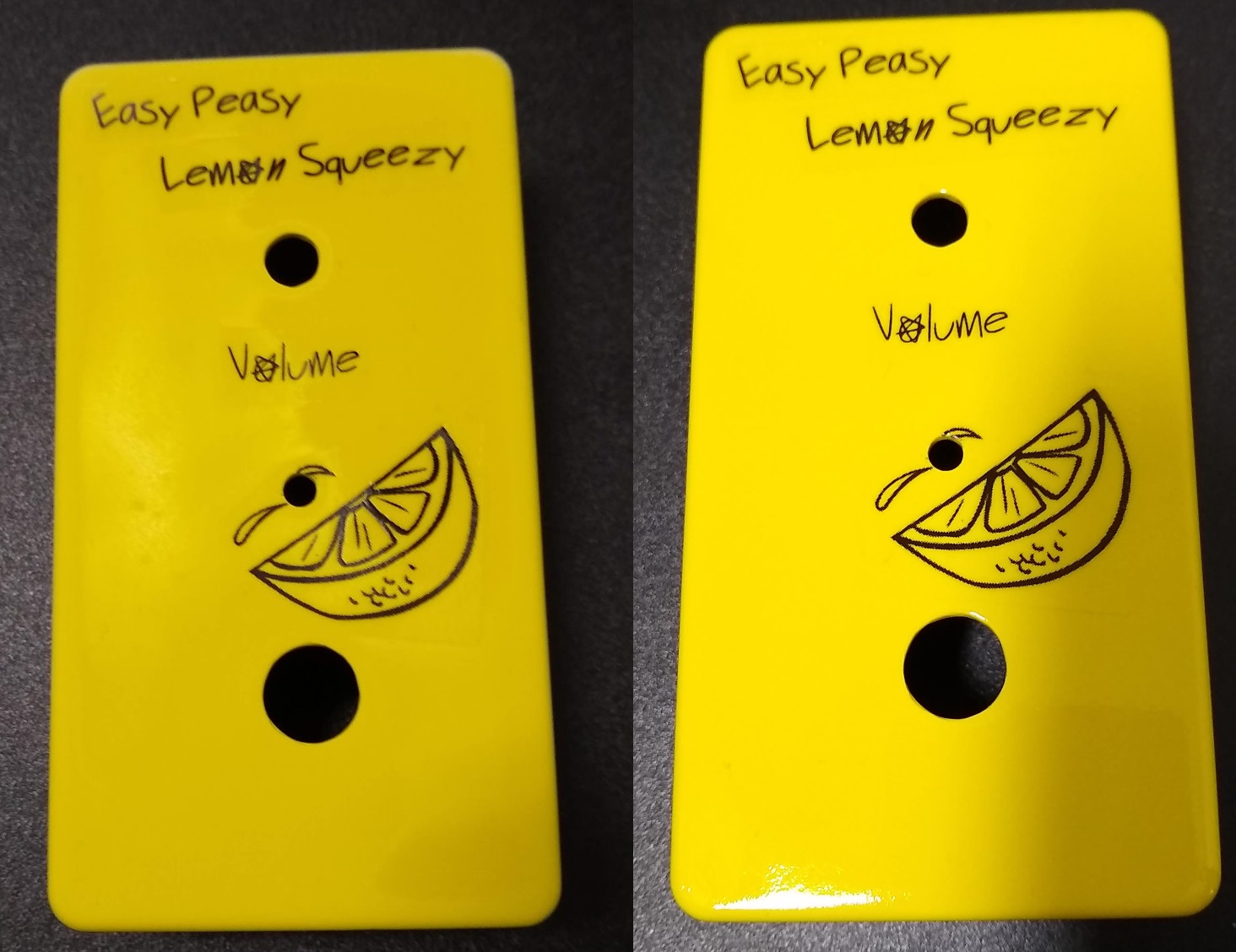

    I mostly salvaged the finish with a very light sand (careful of the decals) and a respray of clear after warming up the shed. The chalky matte finish has completely disappeared (before|after):
    Makes me think the chalkiness must have been all in the surface and that the new layer has flowed into all the pores. Or something. Regardless, I should be able to box this box of juicy goodness up tomorrow night and finish rebuilding the pedal board.
