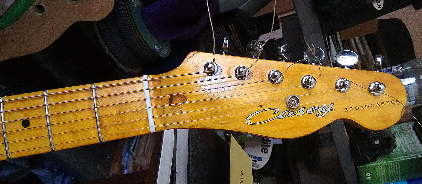

    I've gone over my Squier neck after doing the neck radius.
    F&W Golden Teak with Gloss clear (White Knights 'Squirts').
    I would however leave it to dry for at least a week to harden.

    Good work on the headstock, except you cut it backwards
    As for neck finish, I've not used the Dingotone products at all so can't offer much advice on that.
    However with maple fretboards it is generally standard practise to seal them. I don't know what the DT "final coat" consists of, but in the description of the Final Top-Coat it states: "It will give you a hard finish that protects the neck and provides a silky smooth neck feel when playing." So I presume it is some kind of polymerised finish. This is typically what is used on maple fretboards.
    So with your other option: FW stain & wipe-on poly (presuming both oil-based) no problem. Also recommend doing both back and fb as mentioned above.

    Beauty Mark Thanks for that. Only concern is not confident using cans that's why I thought wipe on might be easier. Oh well guess I better learn using spray on. Will grab a few cans from Bunnings tomorrow to practice on a spare piece first.
    Sorry Mark one question would I use the white knights spray on the fretboard as well or use pitbill wax.
    Thanks for your time.
    No worries Twodogies. I use it on the whole neck including the fretboard.
    This time I finished the neck before putting the frets on thinking that would be it.
    Failed to leave it to dry anywhere near long enough (the frets arrived early) and had to sand some fingerprints off it.
    Impatience really kills.
    cheers, Mark.

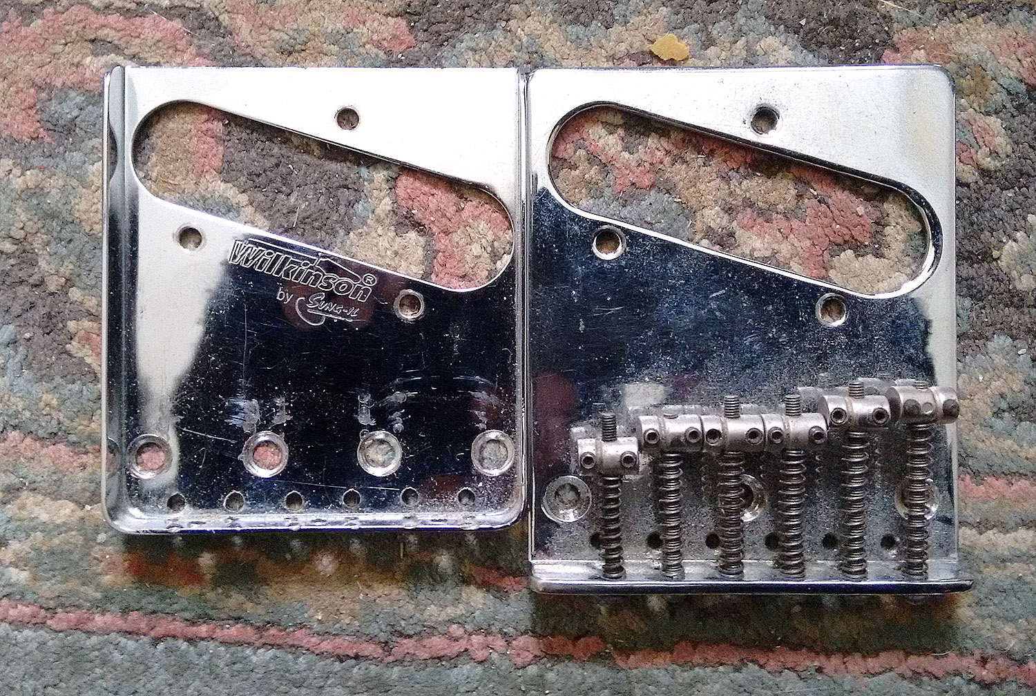

    Hope everyone is having a good weekend.
    New bride pickup finally arrived (well second hand but new to me lol ) and routed out bridge cavity to suit.
    Think i got strings aligned properly.
    Now the problems lol
    Strings seem to line up ok but as you can tell center string lining up fret markers and center of bridge is slightly off center. (Middle string lining up with screw head and pencil mark on body).
    The next photo shows bridge placement when the saddle on the right (high E ) is set at 648 from nut to front of saddle.
    Notice the very big gap between guard and bridge.
    Do you think there is enough room for later intonation if I move bridge about 5 mm closer to reduce pick guard gap reducing distance from nut to saddle 643?
    Try to square up bridge and see if I can slightly adjust neck by loosening neck screws and slight pressure move the neck so it all lines up better. I have watched many you tube videos and the more I watch the more confused I get.
    But then again I am waiting on a new Wilkinson bridge so maybe I should just wait till that arrives and see if that aligns better. The only reason I thought trying this bridge first was I could use it as a template drill holes etc without damaging new bridge.
    Thanks for any input.

    Yeah, wait for the Wilkinson to drill holes as they are a bit different to the kit ones. You've picked the common issue with these kits. You can assemble as is and it works fine, but you can also absolutely enlarge the bridge cavity and move the whole thing forward to close up that gap without any dramas, there is enough adjustment on the screws to take it up.
    You can see me going through the same process in this first TL build I did
    https://www.buildyourownguitar.com.a...ead.php?t=8005
    Oh also, I wouldn't be using the center fret markers as any kind of guide. The High and Low E string is the best way to make sure everything is running true.

    The Wilkinson is a Telecaster bridge and the one on the kit is a Squier.
