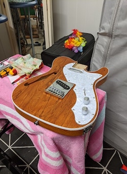

    For whatever reason, the top only required two coats, while the back took 5 to get to where I wanted it to be!
    I'm not surprised that two different timbers took the stain differently. Ash is a much more open grain timber by comparison to Maple.
    It looks great though, and the sunnies are a nice touch!
