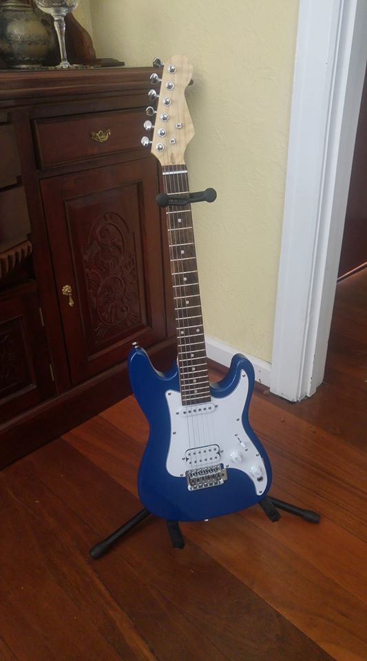

    All done. I ended up placing it on the pickguard. It was a tight fit and there was a problem with contact with the copper shielding tape, but that was easily sorted.
    Thanks all for your input. A young boy should have a happy birthday today!
