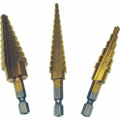

    It's completely doable with a variable speed hand drill AND using good sharp drill bits! Dull dodgy drill bits will end badly with this job. This can also be done with a step drill.
    Securely holding the plate whilst drilling is important. Don't just hold it down on a table/bench by hand. Whilst it can be done in situ, I prefer doing it off the guitar, but that's just me.
    The biggest risk is lifting or chipping the nickel/chrome plating. Drill from the shiny side and don't drill the hole to the full desired diameter all at once. Start with the smallest bit needed and increase by .5mm increments.

    I have found control plate holes easy to open with these. Click image for larger version.
