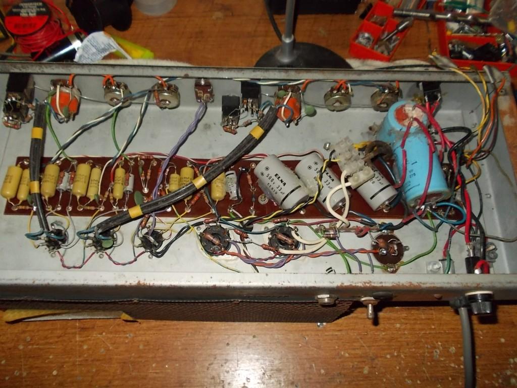

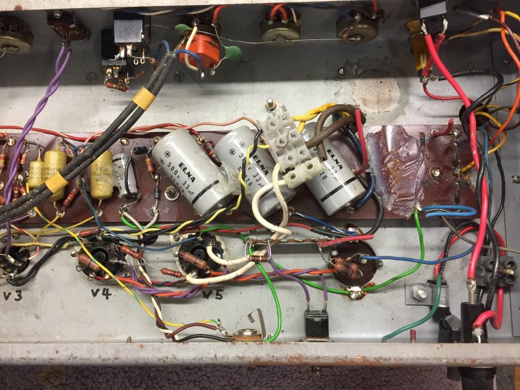

    A couple of pics, note the yellow/green and yellow/red wires there are other colours that aren't seen in these pics
    As delivered to the previous owner
    As delivered to Scott

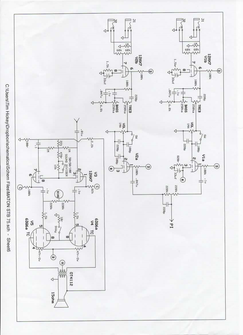

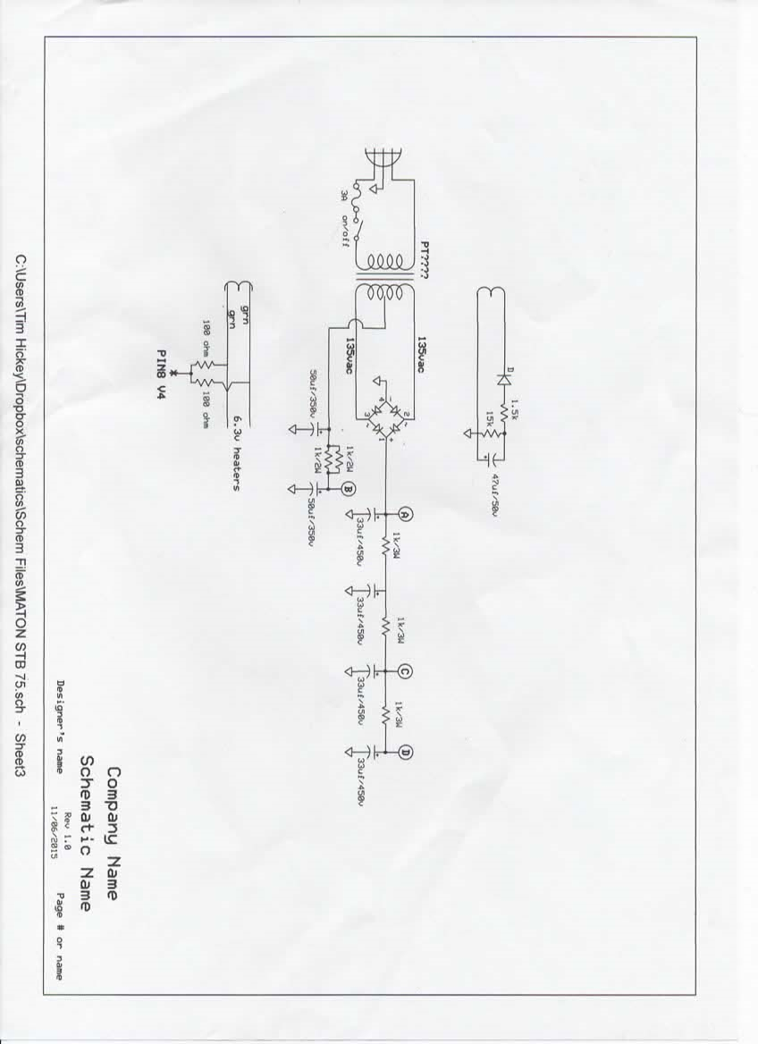

    The circuits that came with the amp.
Name:	Maton STB75.png
Name:	Maton STB75_PS.png

    Yummm.... plenty of sweet spicy Mustard in that amp.... and far too much lethally exposed 240VAC mains.
    I've heard that hose Mustard caps are supposed to be great for tone, assuming that none have gone leaky, I'd probably try and keep them soldered on the board if at all possible, hopefully none of the resistors have drifted out of tolerance.
