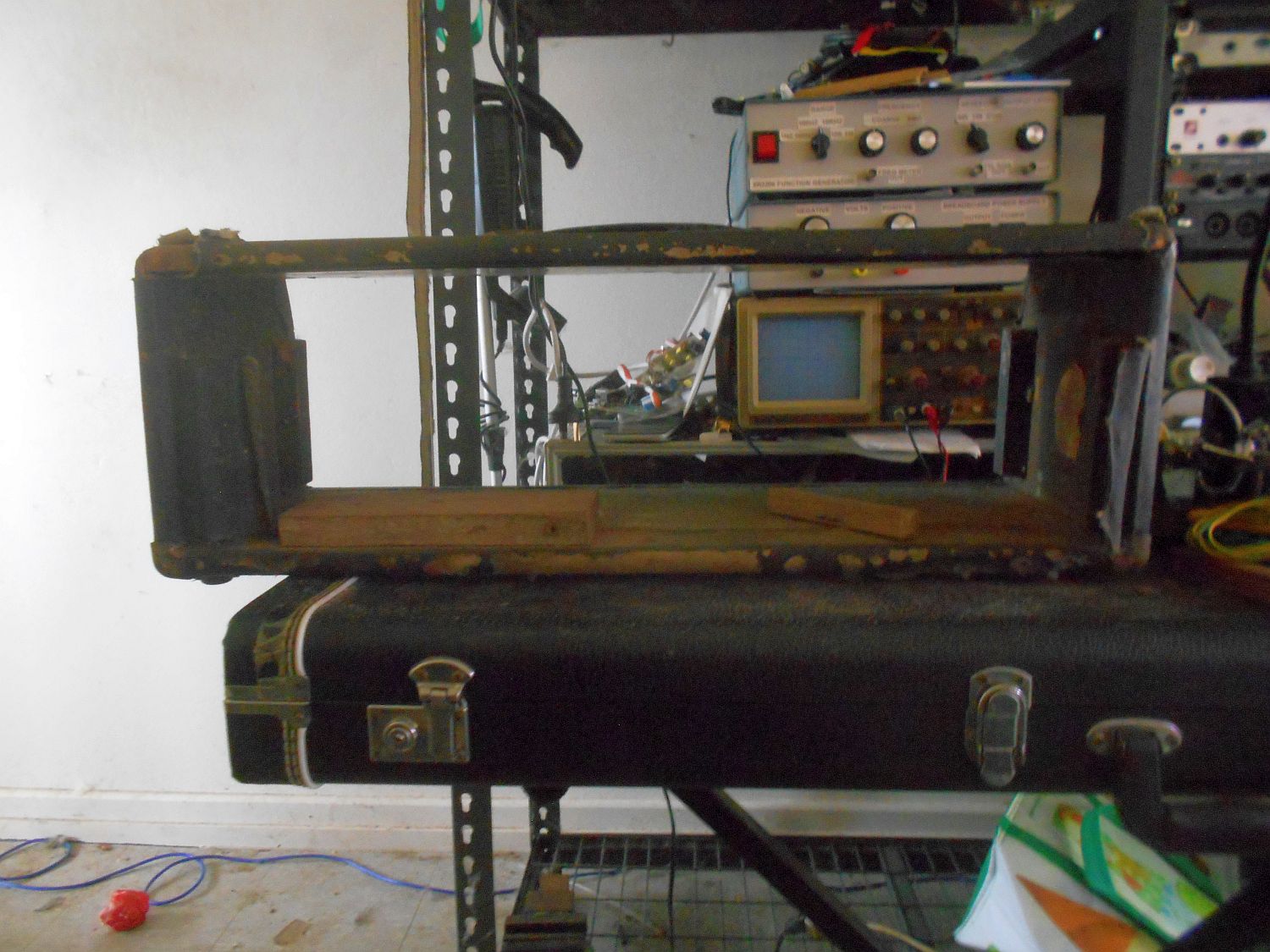

    Update:
    Here's a pic of the wooden cab for my mid-70's non-reverb Fender Super Twin amp, I've currently got it on my makeshift workbench in my little studio room in my flat, so I can do some work on it, I have decided to go-ahead and re-tolex it because the old tolex is looking a bit tatty in a few places, this has also given me an excuse to re-glue all the cabinet joinery with some titebond glue because they are a bit loose and rickety, I'm going to be paying my local Bunnings store a visit next fortnight to buy a few things I need, some titebond glue will be added to my shopping list.

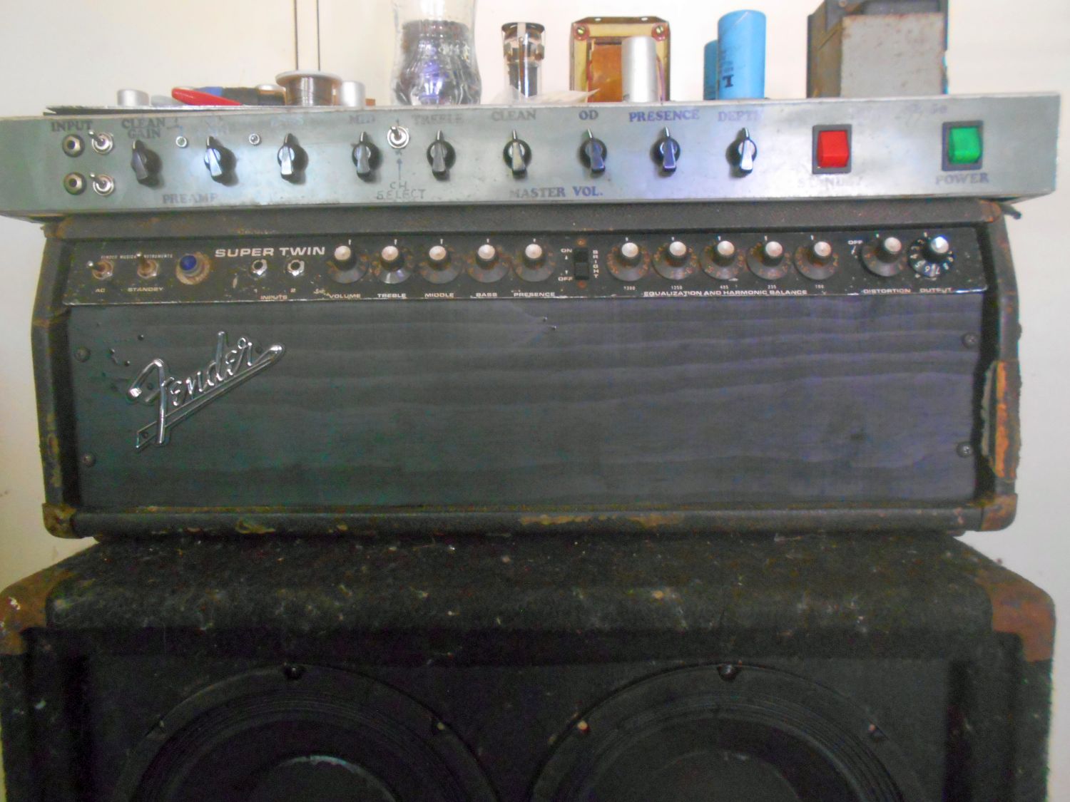

    Update:
    Recently I bought a brand-new Fender amp badge on eBay, and it turned up in the post yesterday, here's a pic I took after installing the new amp badge on the amp's new front baffle I made today:
