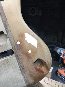

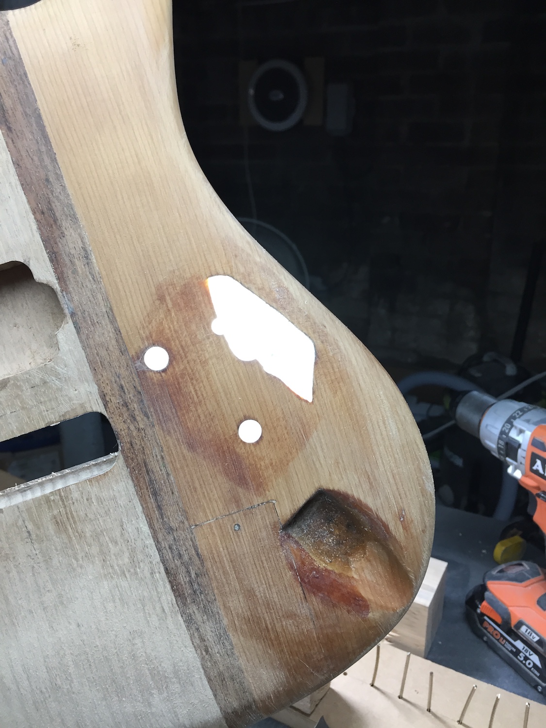

    yeah so this started happening today.
    Ok, so we have the before shot, but please don't make us wait weeks or months for the after shot haha.
    Cheers, Waz

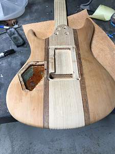

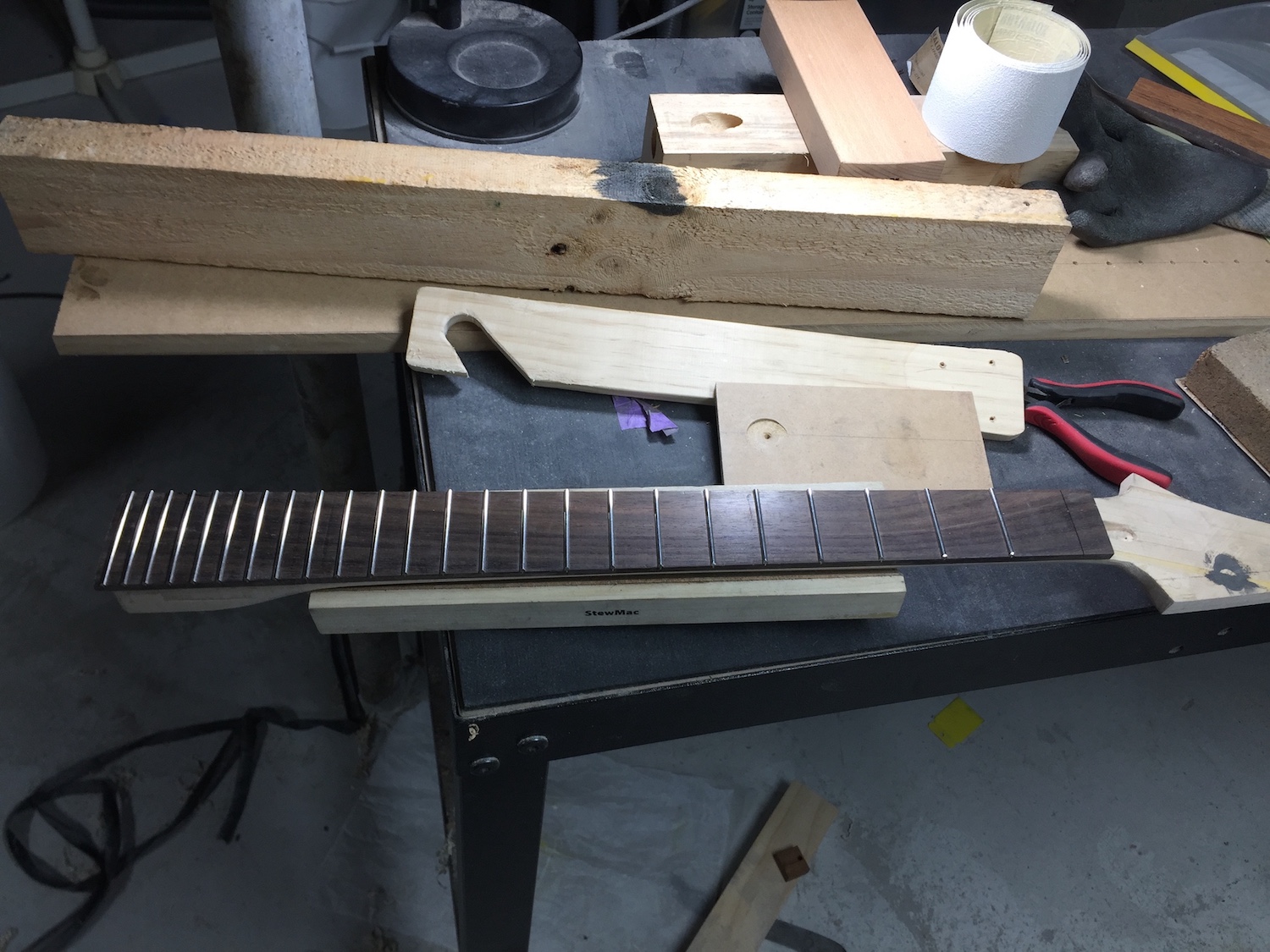

    Here you go Waz, frets are trimmed but i am waiting on some proper fret dressing tools to finish it off.

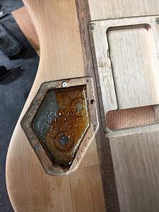

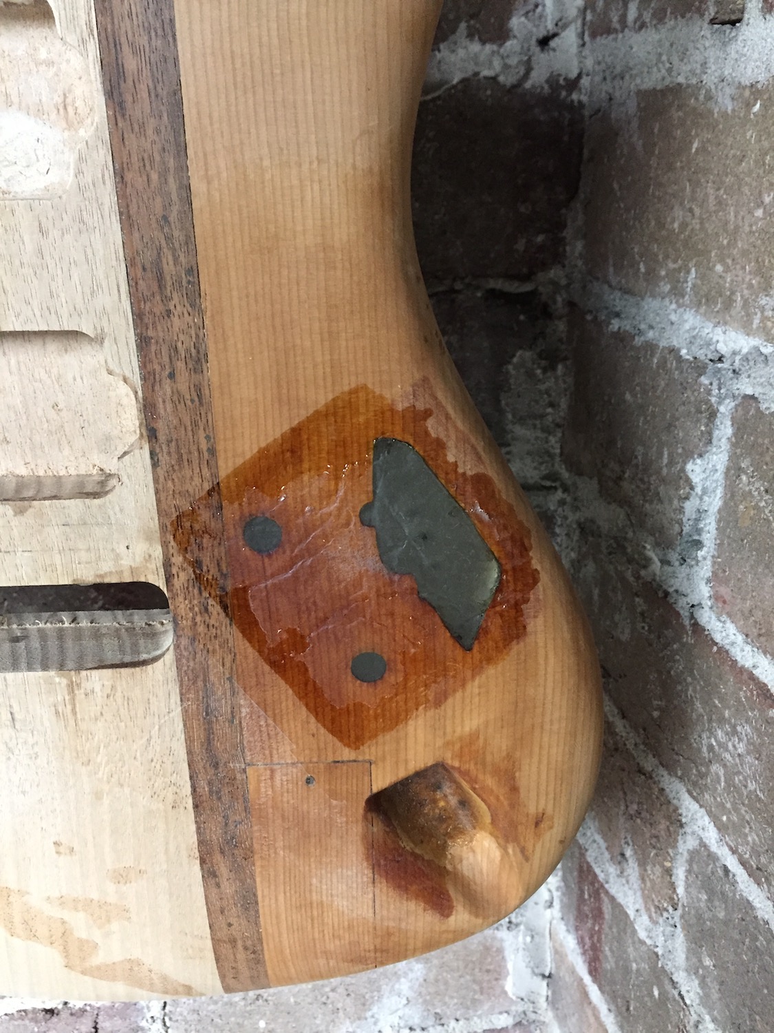

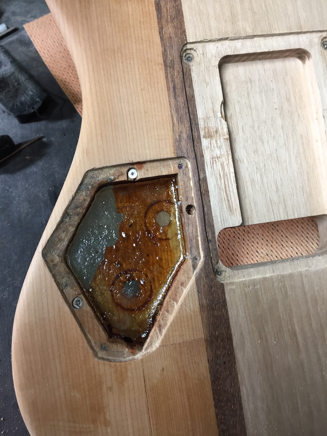

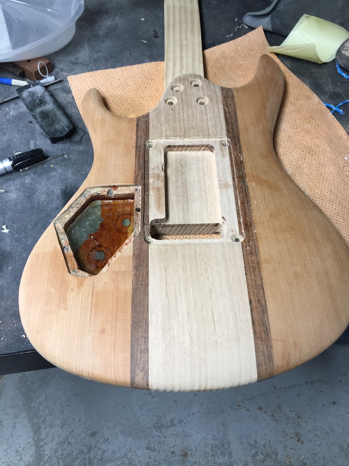

    The resin experiment MkII seems to have done the trick:

    I'm going to have to wick some CA down the edges though as it seems the resin pulled away from the body in a couple of places as it hardened. After hitting it with the router to level it out and trim it down though, it still seemed as solid as a rock so i;m okay with it.
    I'm just now fighting an urge to try and mount some LEDS to have it lit up!
    This is what the cavity looks like back lit with my shop lights:
    I reckon it'd look sick with red pulsing LED Strip in there! Possibly a bridge too far...

    Thanks Stan, the neck is an experiment, the old FrankenWashie neck will be going back on. Eventually.

    Cheers DK, it needs some heel work to fit it tighter to the body, hence it's just a test neck, but it's been a valuable experience, learned a hell of a lot from it.
