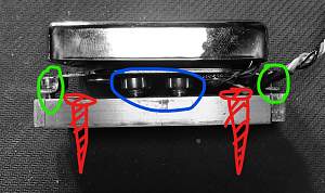

    The red indicates where the metal block is screwed firmly to the bottom of the pickup cavity.
    The blue indicates the four bolts for adjusting the height and angle at which the pickup sits. You need to take the pickup off to adjust them, so it's not something you can do with the strings on.
    The green indicates where the two bolts (that would normally be the height-adjustment bolts with a pickup ring mounting) hold the pickup firmly down against the metal base so that the pickup can't move.
    Top view of base:
    Side view of pickup and base showing pickup attached to the base.
    Simples!

    Yep, all makes sense, but does seem a trifle complex...
  4. #174
    Indeed. But it does give a very secure and adjustable fitment of the pickup direct to the body.
