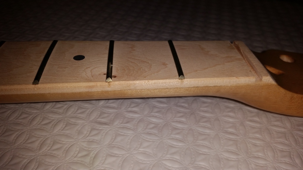

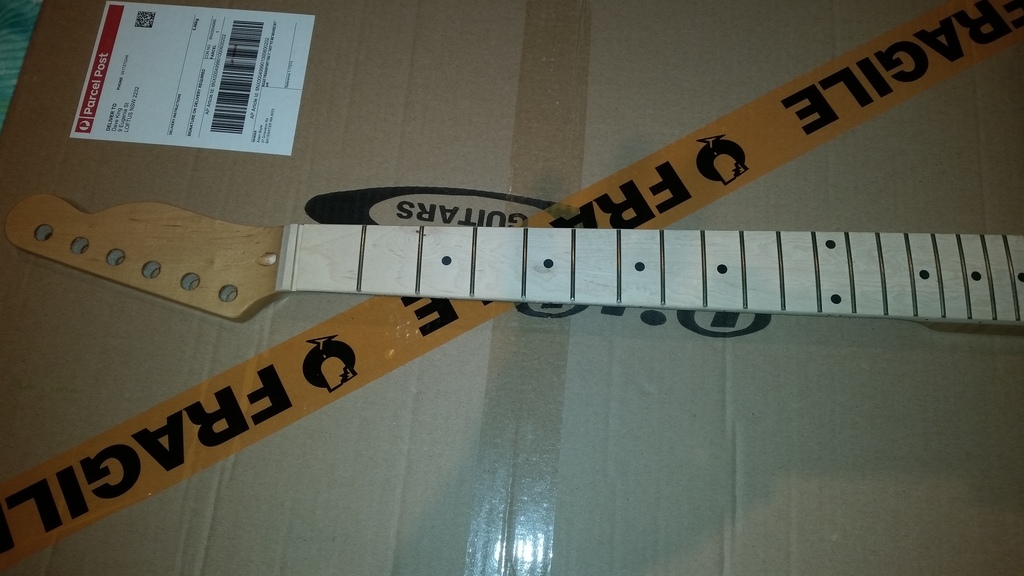

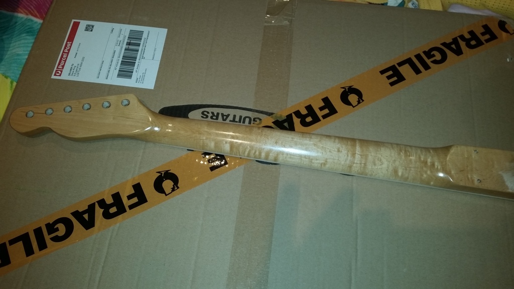

    Here's a couple of pics of the neck, still have to do the wax and then the frets but it's fair to say I'm rather pleased with it so far.
    I did scrape that bit of finish bleed after I took the pics
