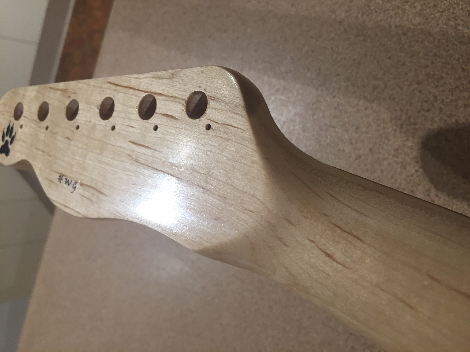

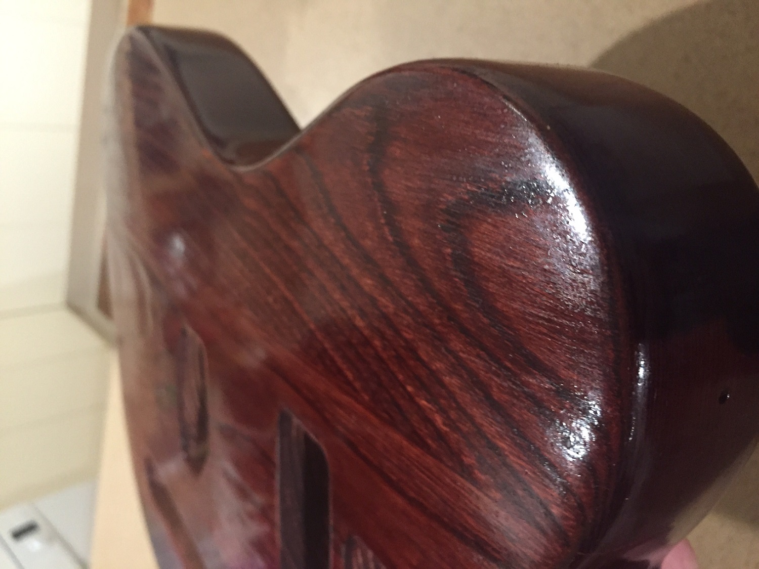

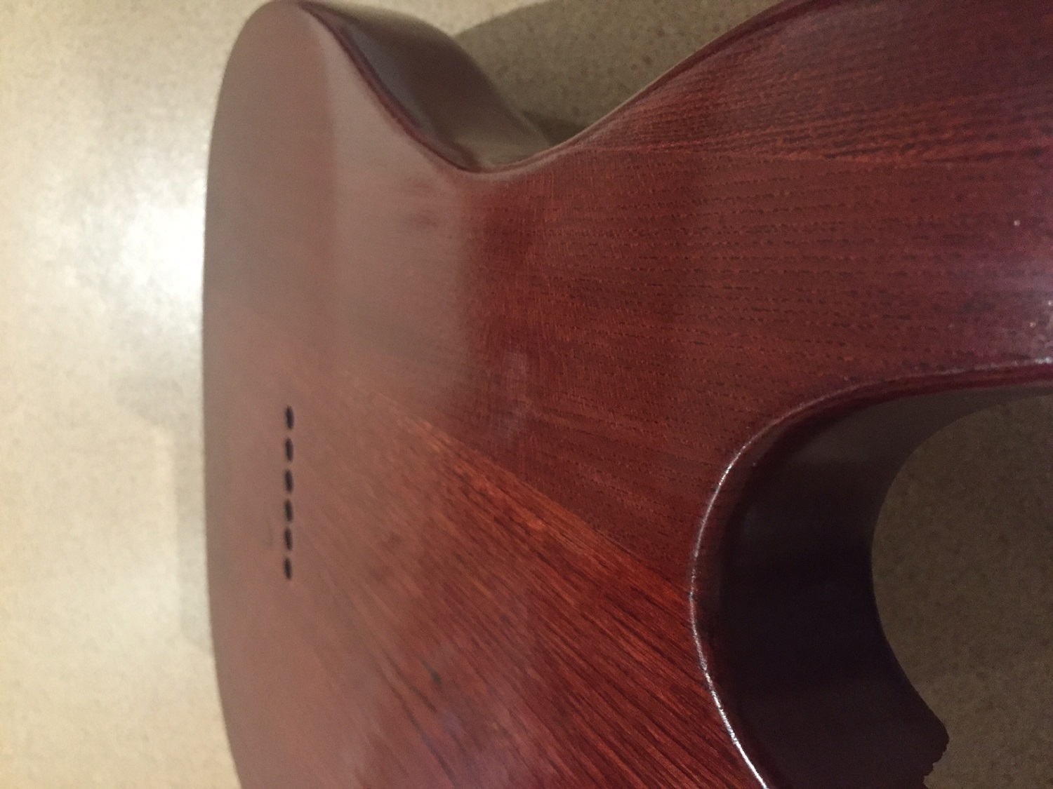

    Just in case anyone wants to see the contrast between the wet coat and 24 hours later, I thought i'd post some piccys.
    So this is the result you can achieve with DT MkI after 3 thin finish coats using my technique. I have not buffed or polished the guitar in anyway.
ID:	11361Click image for larger version.
ID:	11362Click image for larger version.

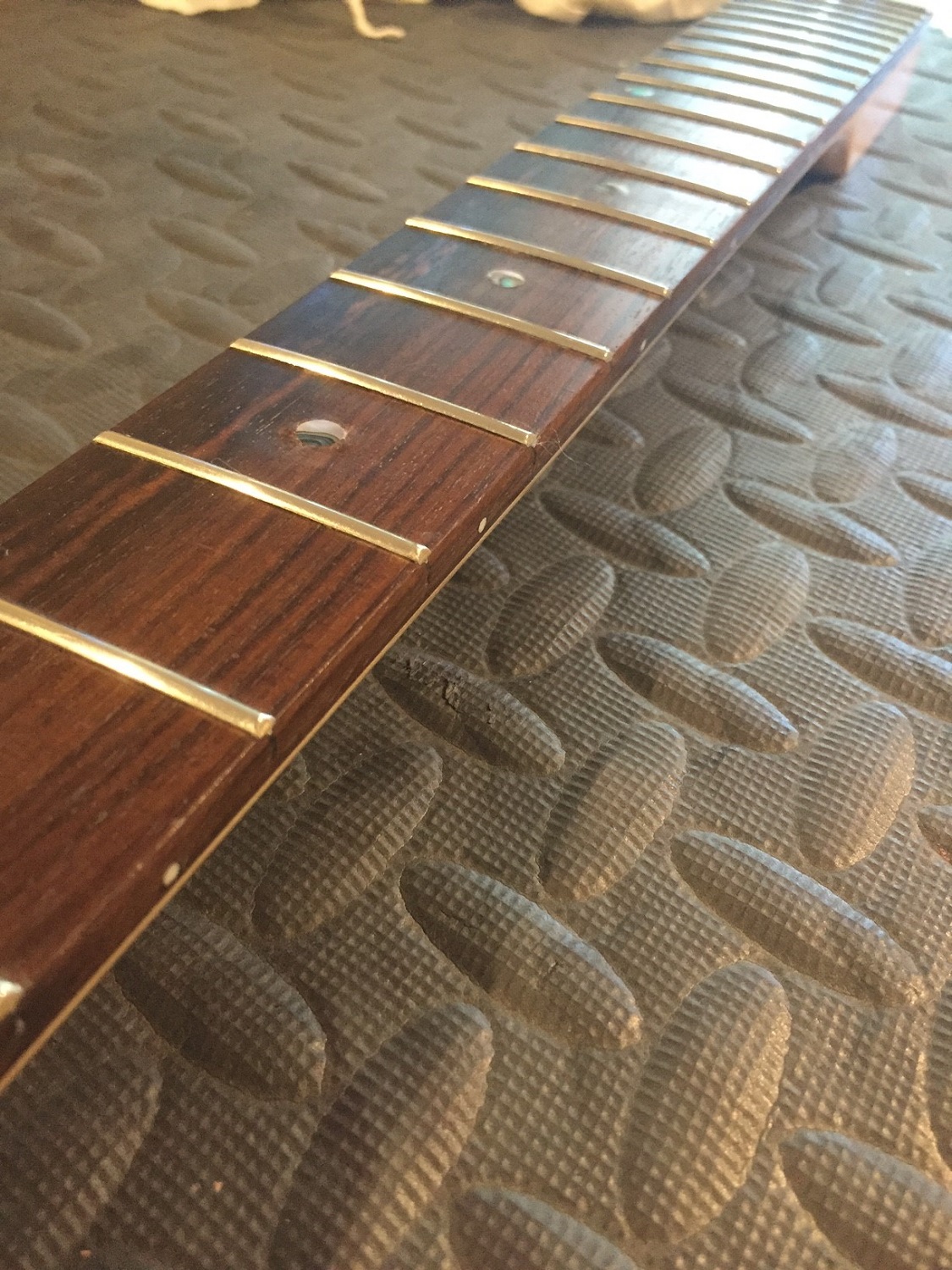

  11. #170
    Thanks Andrew and Stan.

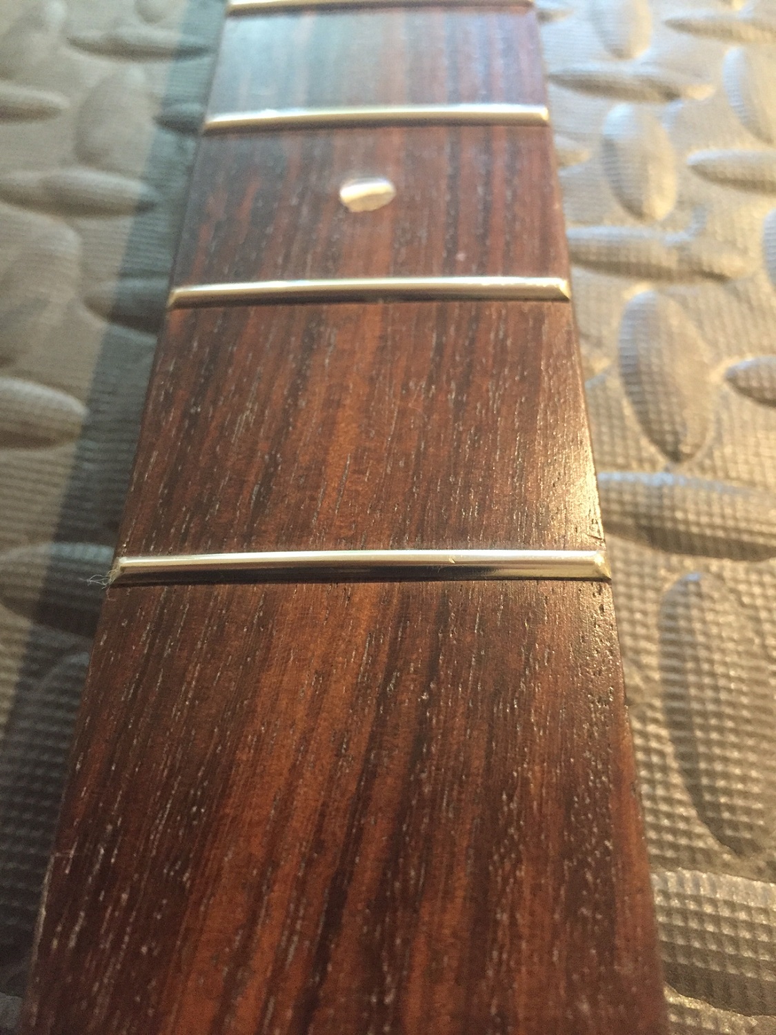

    While I'm waiting for the finals to cure, I'm getting a few odd jobs done....
    Fret leveling, fret polishing and dingowaxxxxxxx complete!

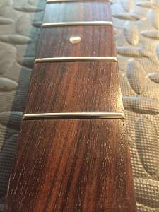

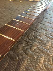

ID:	11447Click image for larger version.
