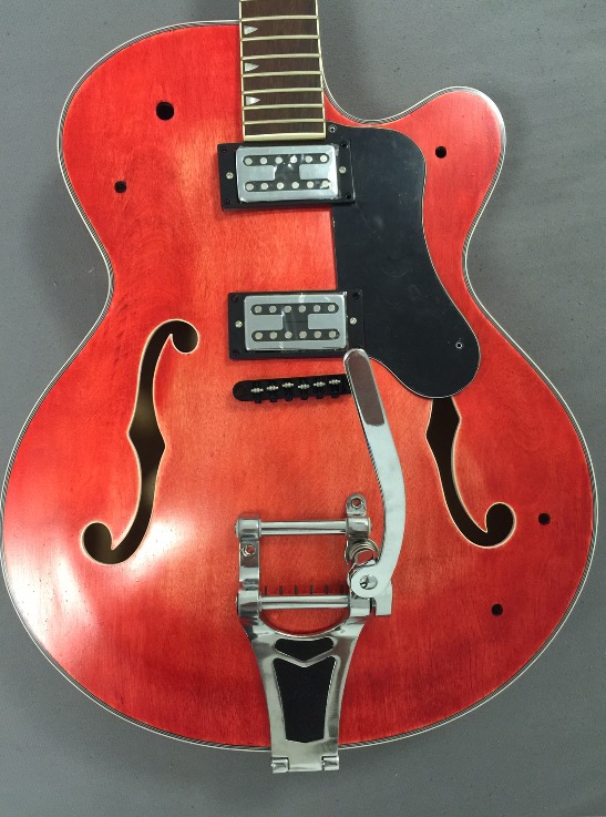

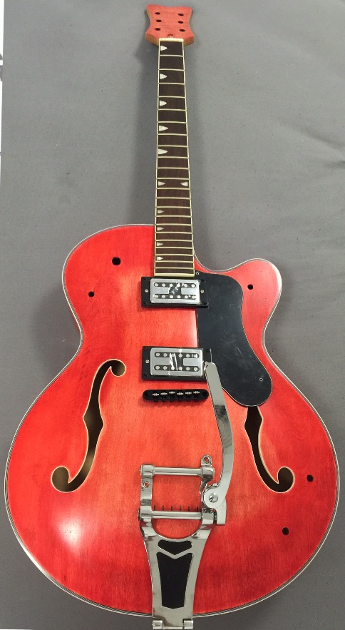

    So I just did another dry fit, and my goodness am I excited!! It looks flipping awesome!!! (If I do say so myself!!)

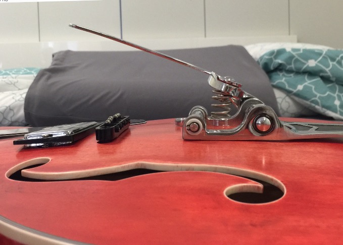

    I have 1 question though, this is how my 'bigsby' style bridge came, does this look right? To me it seems to be sitting too high... And when I push the trem bar down the spring clicks (did not do this whilst it was sitting like this, I squeezed it in my hands).

    I would love to buy, but can't currently afford a genuine Bigsby so I want this to work

    Hi Shazz, mock build looks excellent. I think you have the neck pup surround in the bridge cavity, try swapping them and the bridge height should look about the right height. I think once strings are on the wammy bar should come down but of the 50 odd kits I've built I've never had a Bigsby on one. The other GR builders can probably help you with the pickguard or if you buy the material have a crack at cutting your own
    Moderator dingobass's Avatar
    4,491
    Noice!
    The Bigsby will settle down once under string tension so don't worry about any weird clicks it makes now.

    Hey Wokka, I did have them the wrong way around! I realised afterwards doh!!
    Hopefully when I actually fix hem they're in right
    It's not the pick guard it's self it's just the silver bracket that fixes it to the body. The Gretsch one has a bend in it where as the kit one is flat.
    I hope the bar comes down, it just seems to be really high and not sitting on the spring right. I'll try have a look through the forum and see cheers

    The reason why the trem arm is like that is because there's no string tension acting on the system, incidentally, guitars with those Bigsby Trems fitted tended to have rather thick gauge strings, like say 52s, not only that, the G-string would be a wound type rather than the plain type as found on Fender Strats, you'll probably find that once the guitar is tuned to pitch the trem-arm will sit closer to the body of the guitar.
    Mentor
    Nowra, NSW
    534
    Thanks Doc! I'll continue with this as it seems it will all be ok I'm hoping it all goes well!!
