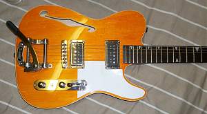

    I can't believe its finished Weirdy almost 2.5 years in the making !!
    any chance of a sound demo ? looks the business with the Bigsby

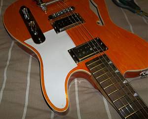

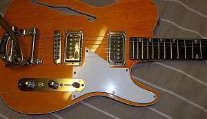

    I originally planned not to have a pickguard on this build, but with the switch to Tru-Oil I'm re-thinking that decision. TO is fairly soft finish and I'm worried that it won't take long for a bit a strumming to wear through and expose the orange Dingotone, which would be a major problem. So, I'm thinking a clear pickguard could be the solution.
    With the tweaks and mods I've made to the kit the stock pickguard is a little outside tolerance to be used as a template.

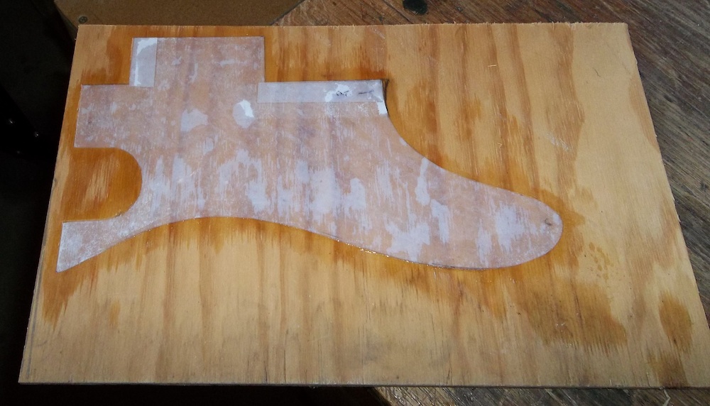

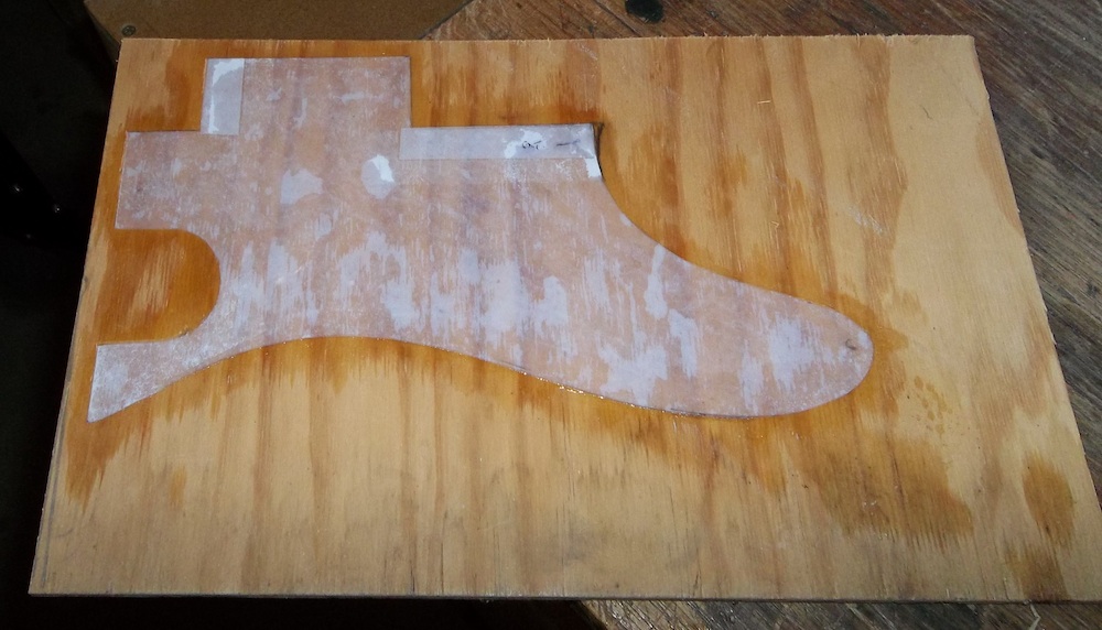

    Once I was happy with the paper pattern I superglued it onto some 4mm ply.
    This should be a one-off template, or at least specific to this build, so I'm only using the thin ply. The 4mm ply is easier to cut and shape (or fix if I stuff it up) and it's all I need for a one use template like this. The downside is it can chip when shaping, particularly on sharp corners.

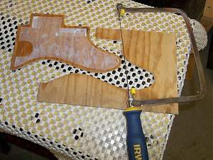

    Rough cutting to shape with a coping saw.

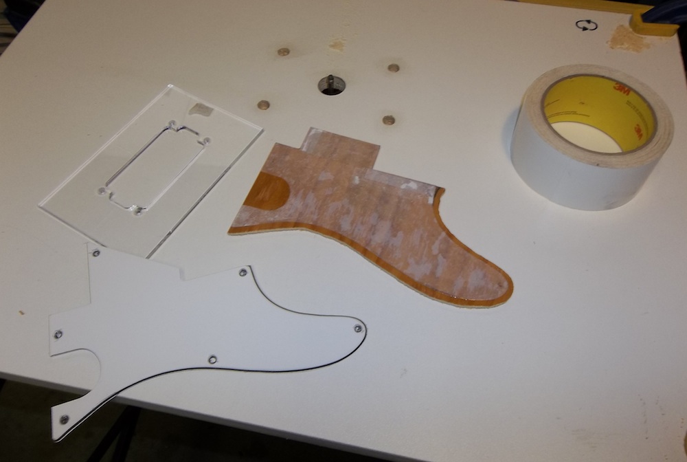

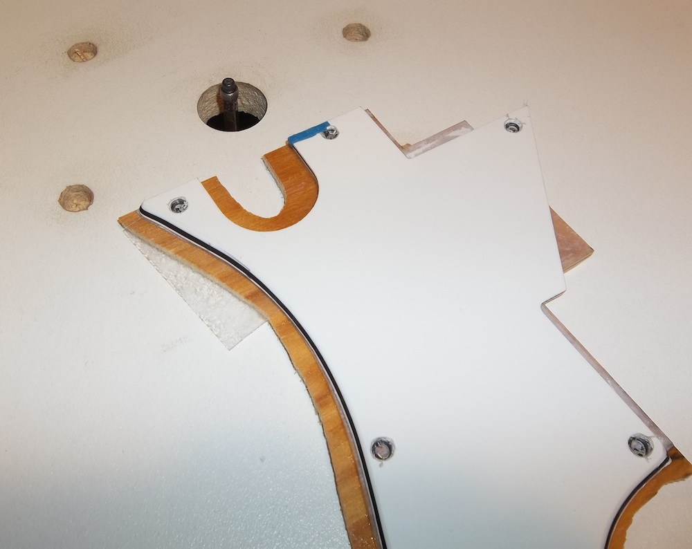

    To shape the template I'm starting by routing the straight edges (using a humbucker template) and then the control plate cut out using the stock pickguard. Double-sided tape is your friend.

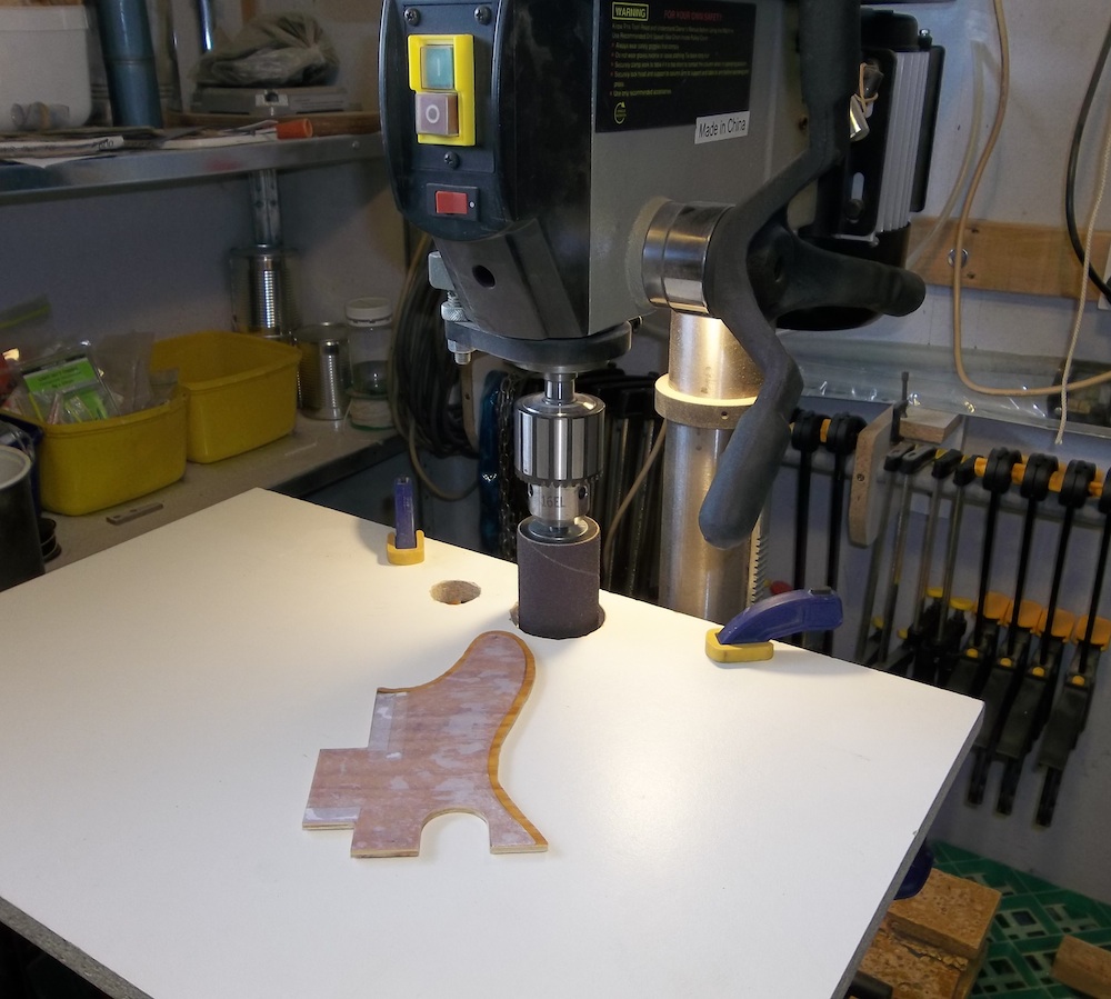

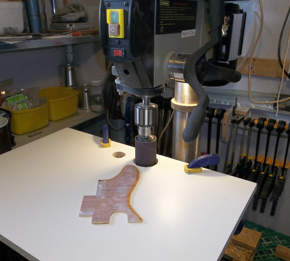

    To shape the curves I used a sanding drum in my drill press. Slow passes taking a little off each time allows you to smoothly creep up to the line/edge for a nice continuous curve. Taking too much off at once or sanding small sections at a time can cause undulations and ripples rather than a smooth curve.
    Once the template was shaped and sanded I toughened up the ply's edges by coating them with thin superglue and left it to dry overnight.
