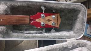

    I haven't been making much progress on my projects lately, including the refinish of this bass. I did decide to lighten the headstock by replacing the Chinese steel tuners with Hipshot Ultralights. I could only get them a la carte. As luck and the supply chain would have it, I got the treble side from one seller and the bass side from another. Decided to take a page from JimC and see if I could get the whole thing a bit narrower as well as lighter.
    I had a case for another ES style project. Identical body specs but with a Fender-style headstock. It took some doing to find a case for the one with the Fender headstock. Unfortunately the Gibson-style headstock with the wide clover tuners would not fit. Fortunately, the Hipshot Y tuners are both lighter and narrow enough to fit, just barely.

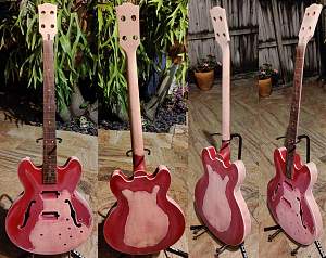

    Taking finish off is a drag. This is the product of about 3 hours work. Not many places on the body where my ROS worked well. Used a scraper and heat gun a bit on the headstock. Otherwise all just hand sanding.... Covered everything in pink dust...
    The reason the "bare wood" looks a bit red is because I had botched an attempt to stain before deciding on a solid finish. When I finish sanding, Ill put a coat of shellac on to keep any residual stain (or whatever else might be left on the wood) from reacting with whatever goes on next. You can see the layers clearly in some places...red stain, gray primer red paint.

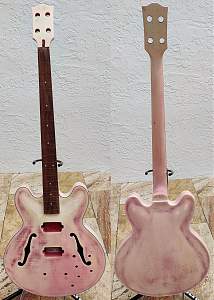

    Almost all of this was sanded by hand. You can see where I sanded through the veneer in places--although some of that damage was done before it was painted red. There's still a bit of red stain on it, particularly on the front, but all the primer and paint are off. Whew!
    Will do a little filling on the back of the headstock where the holes for the old tuners are. I may clean up the binding a bit more to make sure there are no red paint or stain flecks on it. Then a coat of shellac before painting.
    I figure about 8 hours total in sanding, maybe a bit more, to get the paint off. I used 120 sanding mesh (a product I had not seen before) and 150 paper (US grits) to do the majority of sanding the old finish off. I tried a number of things as a sanding block. In cutaways a 1.5" round piece wood dowel worked reasonably well. for almost all the rest I used a block of hard EPS foam, that provided the right combination of hardness and flexibility. I had purchased a couple of specialty products that did not work nearly as well.
    Spent about an hour or so more to sand everything down with 220. The last bit where there is a lot of sanding through the veneer around the neck was the hardest. i probably spent half or two thirds of the time sanding the area within two inches of where the neck and body join.
