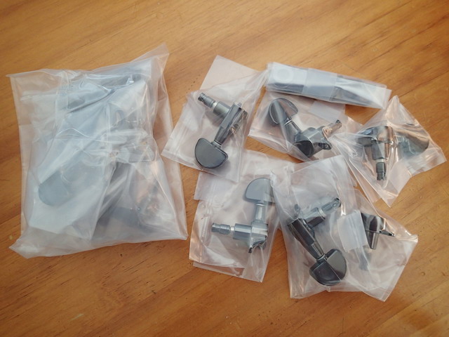

    2 sets of Gotoh Mini Locking tuners in Cosmo Black classy eh

    Ooh, cosmo black on this red is gonna look tight. Good choice.

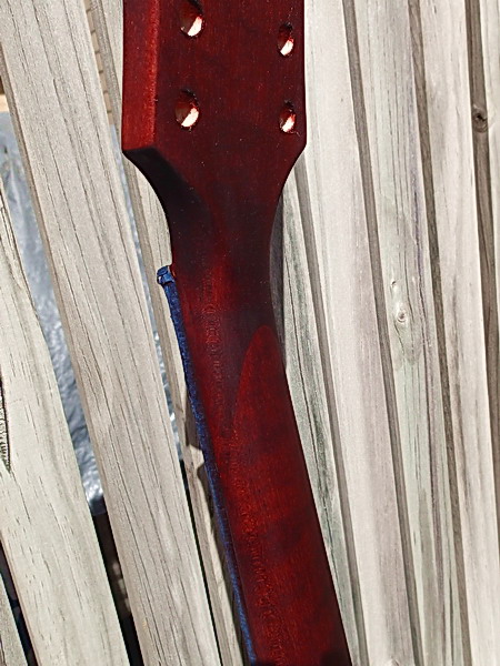

    1st very fine coat of minwax wipe on poly, hard to see here, trying to juggle for the camera and didnt want the neck to hit the dirt

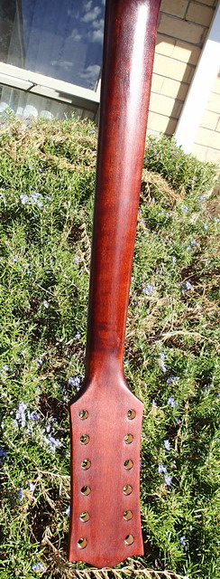

    Sanded back the neck this morning with some good old 0000 then gave it a second wack with MinWax wipe on Poly

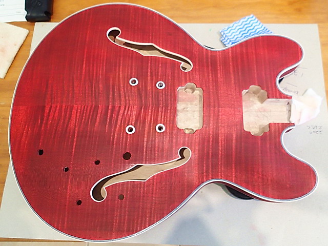

    Next going to give the body a light 0000 run over then a wipe down with naptha, and i hope to do the top and sides today.

    I have using kitchen shhhhh (shes at work) to do the body, its too hot in my shed.
    Have done the top waiting for it to absorb and dry out, i will give it until tomorrow to recoat, tek it back with some 0000 and go again, they say 3 hours but its still a bit tacky then, i prefer to let it cure.

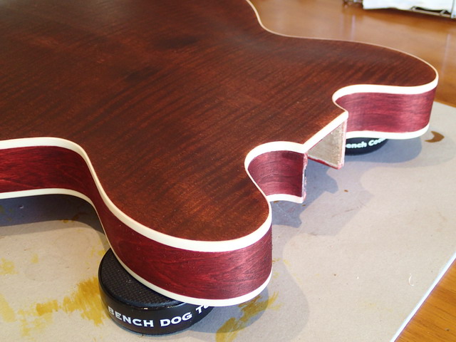

    i have tried to melt the cherry red on the top to the black cherry sides to the red mahogany top, i may have just tinny arsed it.
    Back and sides with one coat of Poly U
