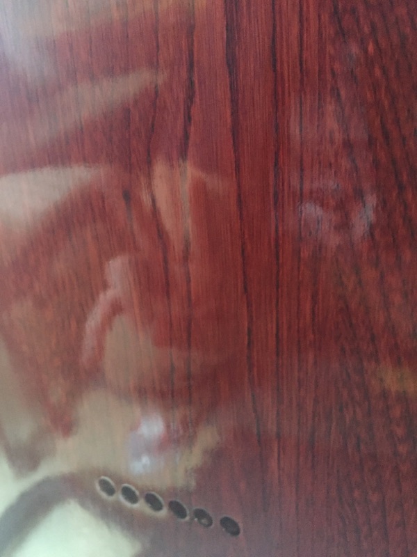

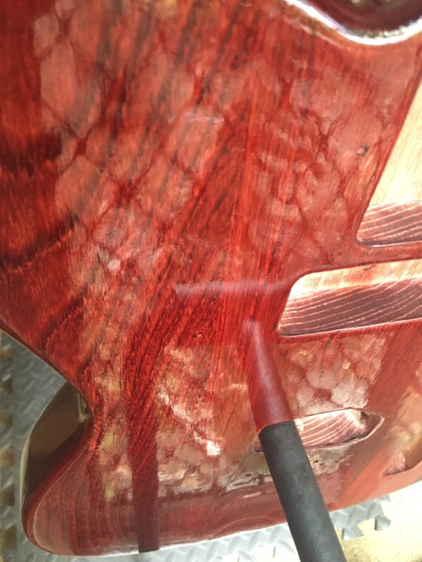

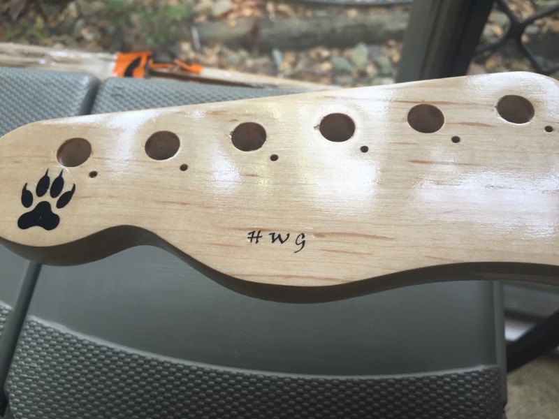

    Your welcome guys.
    lol at Woks pronunciation burn
    Edit: - for anyone else that reads this thread. I am using Dingotone MKI.
    the method also works for DT neck coats and I cannot see why it wouldn't work with DT MKII
    Also a big thanks to Dingobass who created this custom rosewood for me. I don't think I would have "nailed it" had it not been for the time spent in the DB lab
  10. #159
    You've all inspired me.
    Again...sanded back with 2000 grit wet in direction of grain. Last DT final coat applied with "technique" to body and neck.
    See you all in 21 days time!
ID:	11347Click image for larger version.
ID:	11348Click image for larger version.
