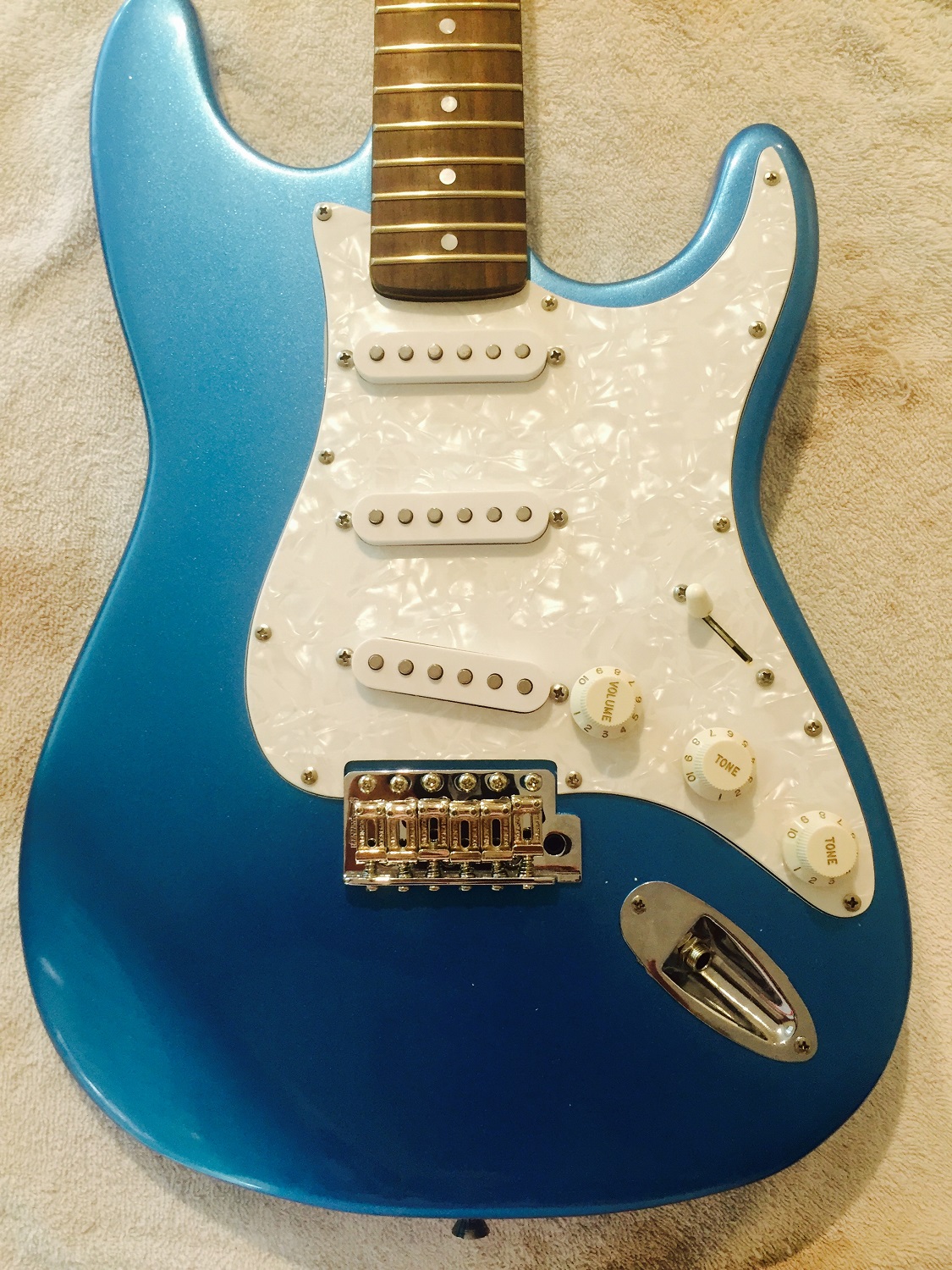

    Someone's had a makeover

  3. #153
    Ooooh, so sexy now.
  4. #154
    nice, it looks grreat
  5. #155
    @ Andy40 That Strat is looking great now mate, the Metallic Blue you used looks a bit like the Metallic Blue I'm going to be using on my HotRod Strat.
  6. #156
    looks sweet as Andy good job, I need to revisit about 50 odd of my builds should keep me busy for a while hahah
  7. #157
    Thanks guys. all set up this morning and intonated. For me, I think I have the entire set up as near perfect as i can. That Wilkinson bridge is a dream to intonate.

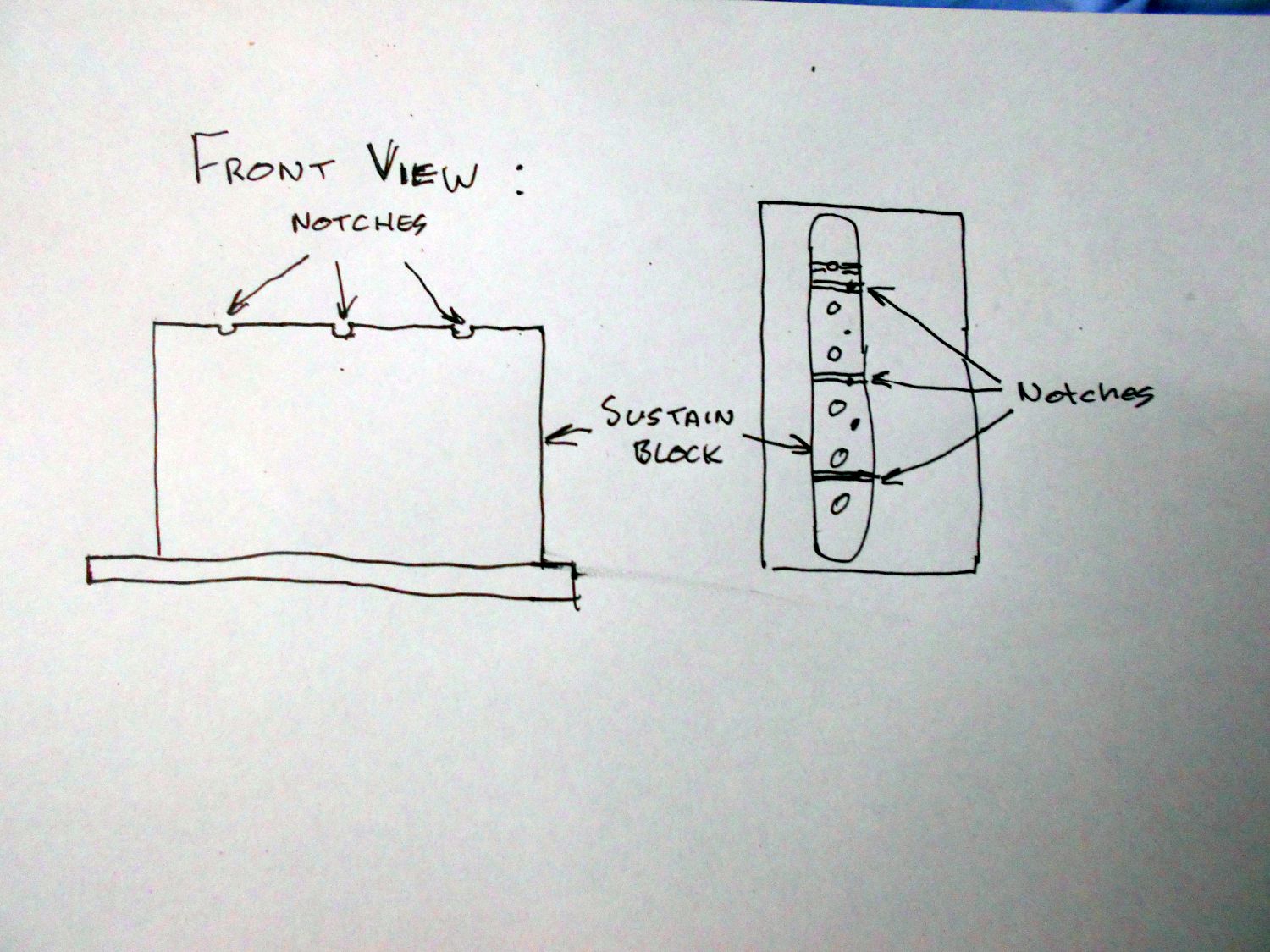

    There's another way you could fix that, what you do is you use a needle file to file a slight groove over each of the holes that the Trem Springs hook into, this will enable the springs to sit below the surface of the sustain-block (the big piece of metal that the springs hook into) and this will increase the clearance between the springs and the cover for the trem-spring route, I'll post a drawing to show what it should look like shortly.
    Here we go, hope this helps:

    Alternatively you can cut out that section of the back plate to accept the trem block that is protruding which is what I do on all strats to make things easier to reload strings anyway.
  10. #160
    I think Docs idea might work. Whenever i can put it down for a sec I'll take the back plate off and post a photo.
