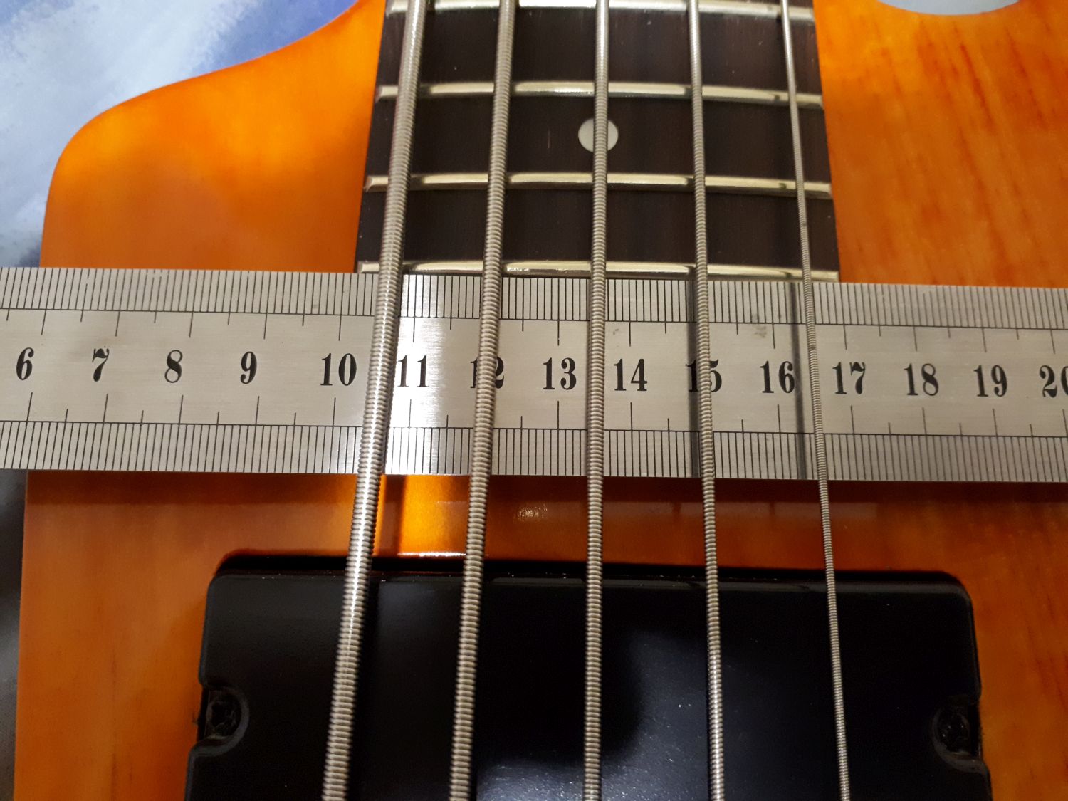

    Only got around to re-stringing tonight to take some measurement shots....
Name:	Bridge spacing measurements.jpg
    String spacing is about 16 mm centre to centre of the saddles which is the same as on the old bridge replaced
Name:	End of fret board measurements.jpg
    End of fret board is around 70 mm wide and clearly plenty of room with the 16 mm string spacing however not sure how 18 mm might work as that would push the outer strings a further 4 mm outbound?

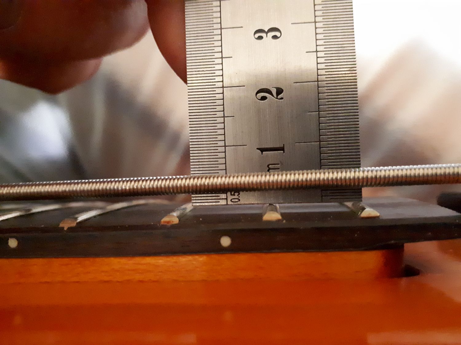

Name:	String height at 21st & 22nd frets.jpg
    Slight forward bow in the neck and haven't touched the bridge saddles yet....they are all fully wound down which has the string height about 12 mm above the face of the body and in this shot shows things sitting about 2 mm - 2.5 mm above 21st & 22nd frets.
    A quick play for a few minutes felt good but will need to spend more time to see if any there are any frets buzzing before starting on the intonation. Would like to take a bit more out of the front bow but truss rod is wound fully tight, only needs a fraction more but with a flappy low B you cannot afford to drop string height too much on that side.
