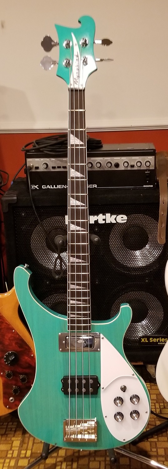

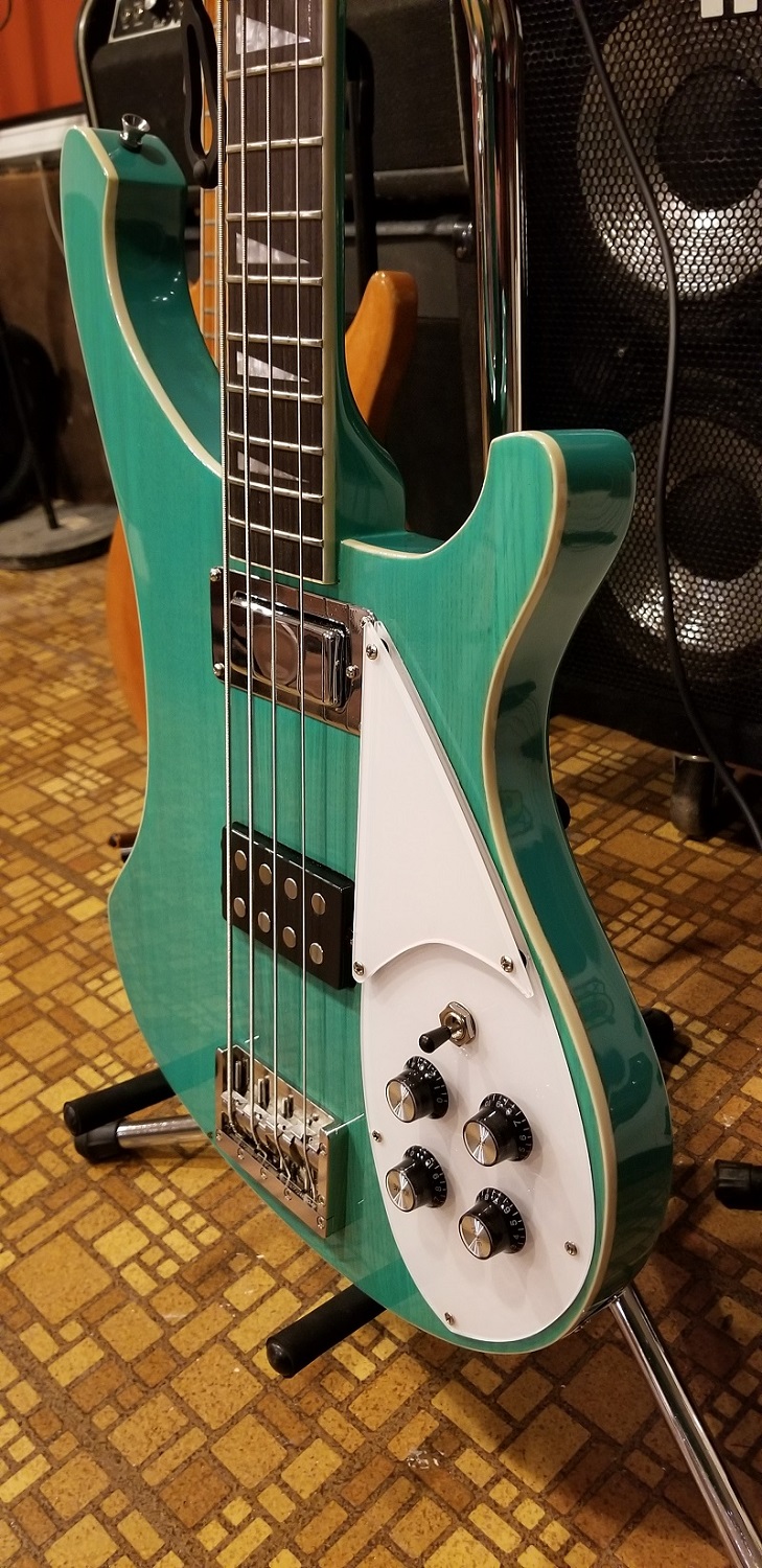

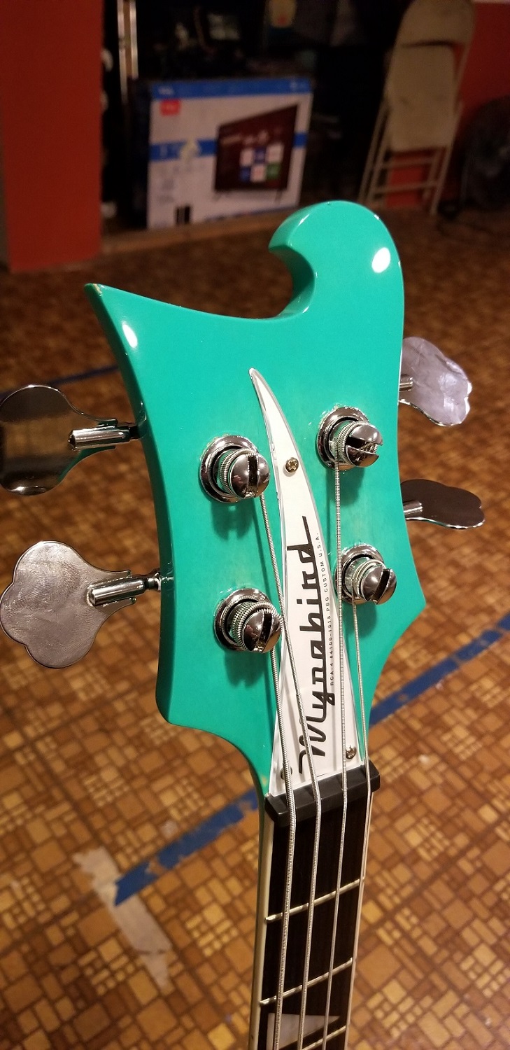

Name:	Finished Front.jpg
ID:	33774   Click image for larger version.
ID:	33775   Click image for larger version.
Name:	Finished Headstock.jpg
ID:	33776   Click image for larger version.
Name:	Finished Truss Rod Closeup.jpg
ID:	33777   Click image for larger version.
Name:	Finished Bottom Front.jpg
