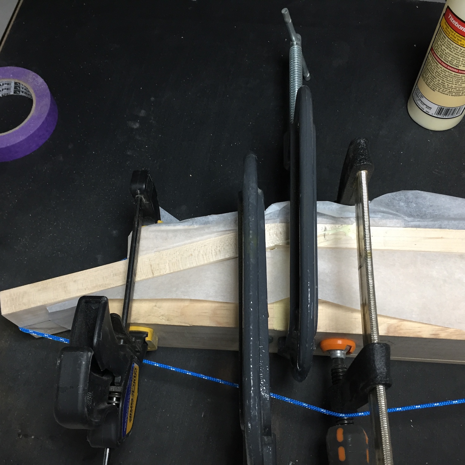

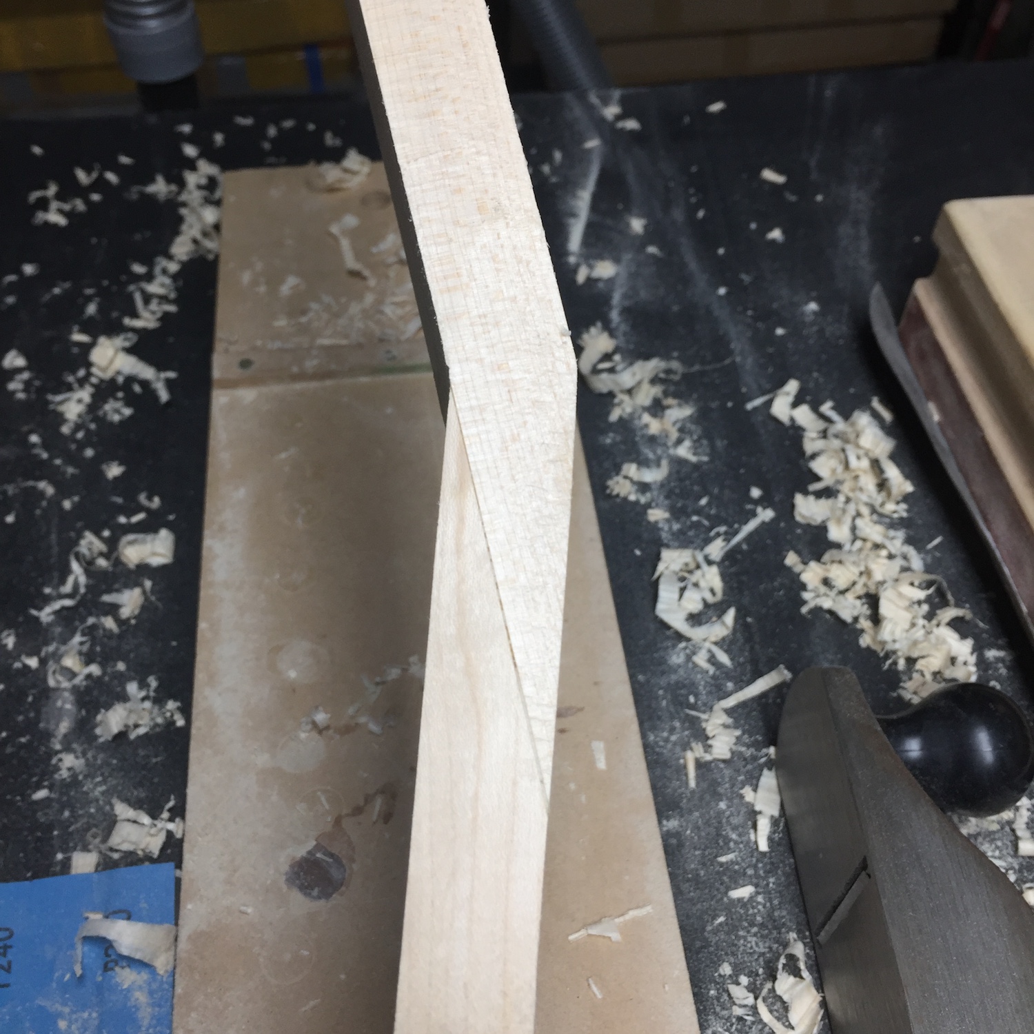

Well, I took the clamps off it and did some clean up and this is what we have arrived at:
Do not adjust your screens, there was a slight shift to one side in the clamping.

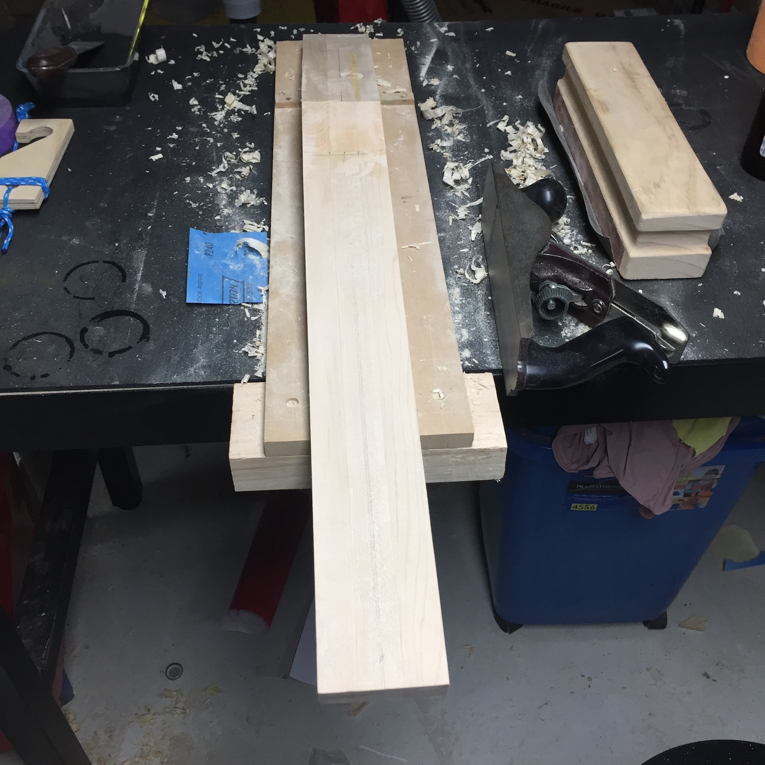

I'm quite happy with how the scarf joint turned out, there is still some fine tuning work to do with it, not to mention the clamping jig, though I have some ideas for that as well.
Continued...
from previous...

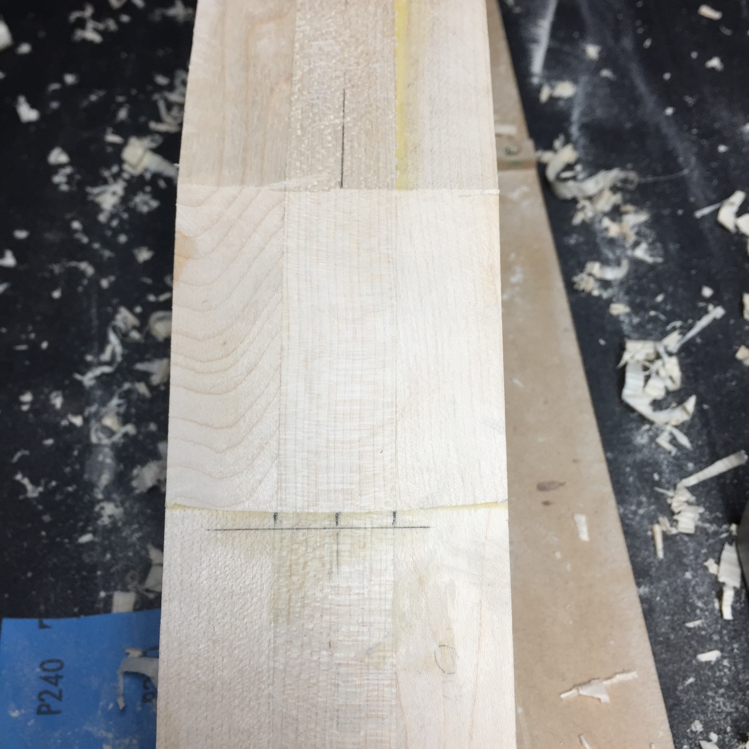

More of the scarf joint:
And an illustration of the wee bit of misalignment that we managed to engineer in:
Whether or not this joint is actually any good is going to be an interesting question. The misalignment is not severe, and it is intended to be a an inline offset head anyway, a la Jackson/Ibanez so I think it is probably worth the time to try and work it through to its final form just to see how it turns out.
If I string it up on something and it blows apart under tension, then so be it. But along the way it can be useful as an experiment in fretting and also inlay and neck finishing, so why not?
