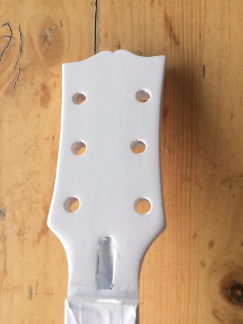

    So I did get another can of primer. Did a few coats, and some extra attention at the edges where it sanded through too quickly.
    Gave it another sanding today, was happy with the result so I've just sprayed the first top (not top) coat, an Arctic White nitro.

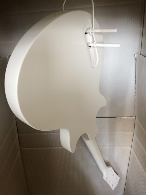

    Arctic white nitro coats are going on nicely.

    Had a coat that ran a little, sanded it back. Now I'm spraying sides and front/back with a 15 minute break between them so the overlap doesn't build up too much.

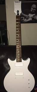

    Here's the next shot in the series. I actually took this a month ago in a hurry. Didn't realise it was blurry until I looked at it now.
    The nut arrived in the post this week. A TUSQ nut shaped to fit by DB. Goes in the box of hardware waiting for the final installation.
