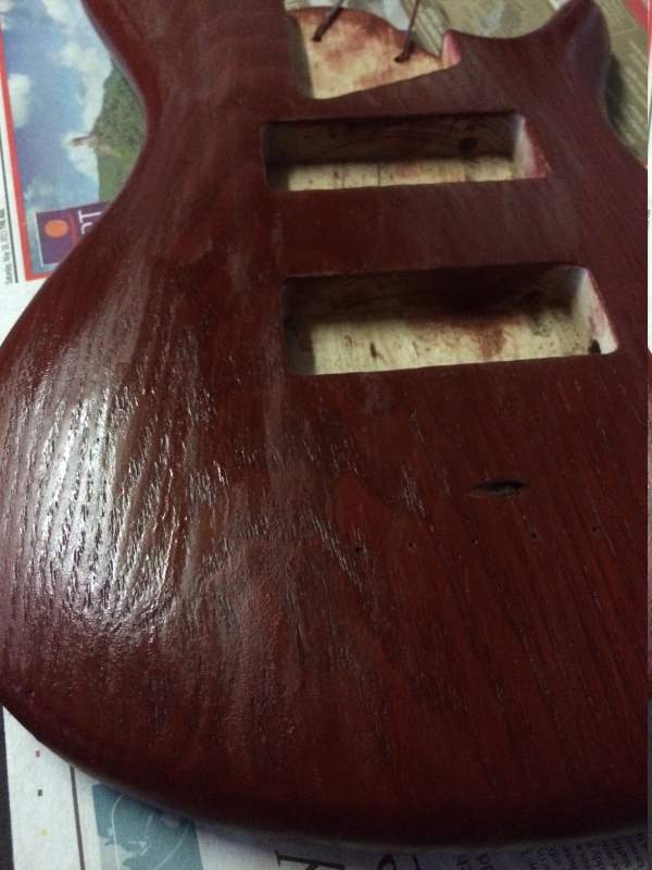

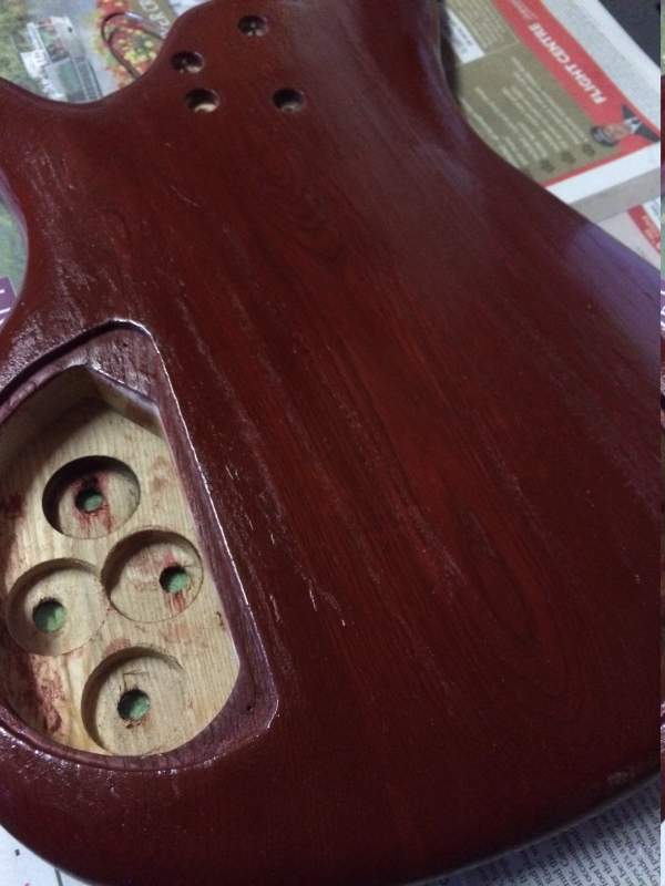

    First coat the morning after. Applied in a room heated to 20 degrees and left to hang. Dry to the touch after 3 hours. Kept a wet look. A couple of streaks, but that's my application keeping it thin and not overlapping.

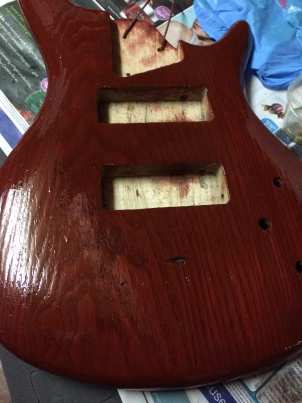

    So I've applied about 8 coats of TO to the body and neck. It's dry to the touch in a few hours even without heating the room so I was able to get two coats in some days.
    Has a nice glossy finish, but not smooth.

    So, I was wondering what to do on the last coat. I've been doing the steel wool in between and even a wet and dry 1500 on one bumpy spot.
    Reading about, people talk about all sorts of things like rubbing it with steel wool or "micro-mesh" (anyone know where to get that?).
    On my LP I used auto cutting compound, as it was an auto acrylic top coat.
    0000 steel wool seems to leave a very scratchy looking surface. I was hoping for a smooth matte if not gloss.
    I'll probably apply a couple more coats of TO yet, then wait a couple of weeks before trying to smooth and polish it up.
    I've also still got the Dingotone Wax. I expect to apply that to the body, unless that's a bad idea with TO?
    Also, do you wax the back of the neck? (seems to me it would be better unwaxed, except the fretboard perhaps.)
