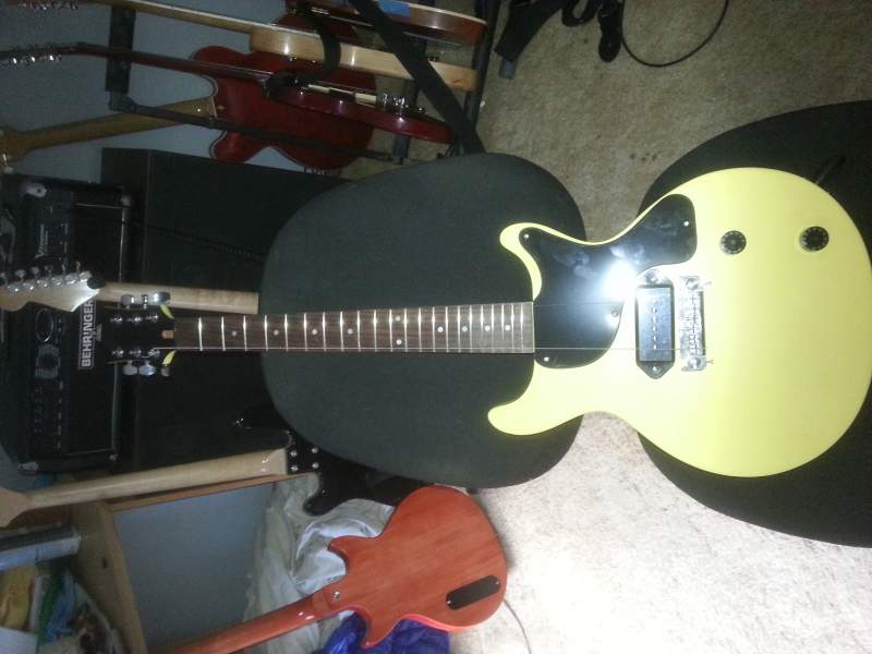

    Oh my god that finish! (drool).
    That's amazing Paul...seriously!!

    Yeah that was done with the big car polisher. lol and Maguires compund.

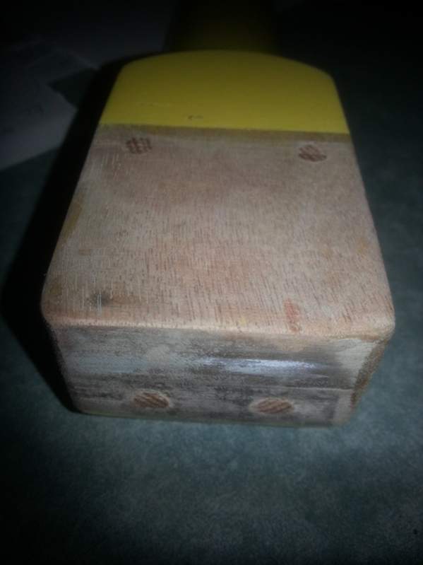

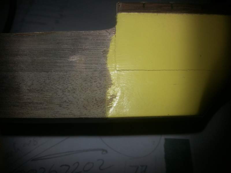

    Had to pull the neck off the Yellow, unfortunately the glue just wasn't ready to let go and cracked the heal.
    However with a little injenuity, I've managed to fix it with some Tassy Oak dowels. Lucky break was when I pushed the dowels in they forced glue into the cracks. the dowels also intersect by a couple of mm so will hold each other. So should be strong enough
    PK

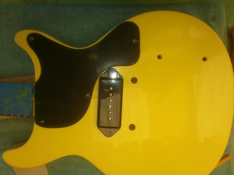

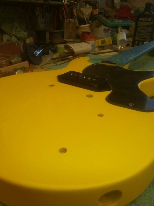

    now down to a day or two to finish the Yellow.
    I've had to refinisha few spots on the body and the neck that took a bit of a hit when I de-glued it.
    For new listers
    this is an authentic style 58' Double cut in as near as I could get to TV yellow off the shelf colour.
    the build is totally mahogany body and neck the fretboard is rosewood.
    Pickup is a single P90 with a B500 Vol pot and an A500 Tone pot witha .022 uf cap. the leads are shielded cotton pushback with added heat shrink layer to avoid unnecesay shorts.
    More pics when it's all glued up and running.
    Cheers PK
