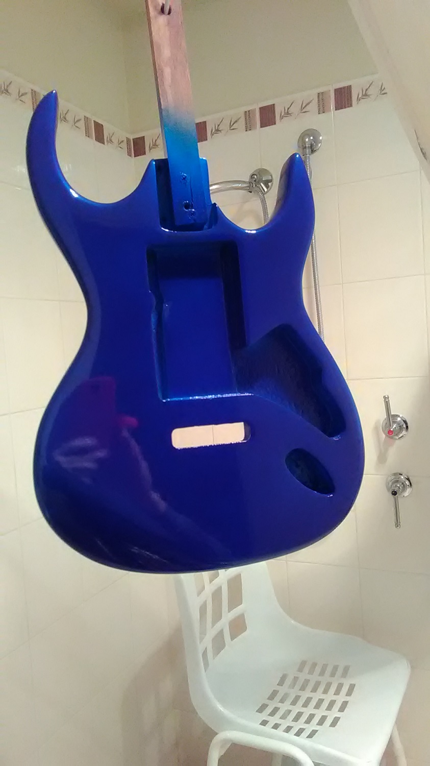

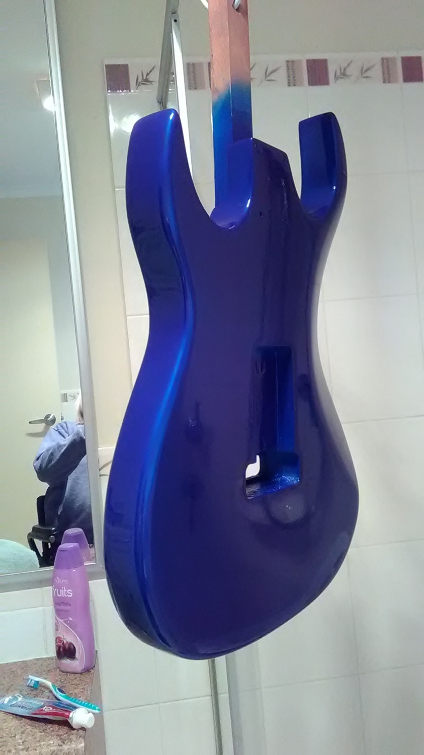

    been playing around with some candys this is candy blue clear over base have a new kit on the way so i picked up candy blue, candy apple red and candy yellow going to try lay a candy over the grain should be interesting
    ok this candy blue over silver but haven't cleared it yet

    Its not really a metallic Simon its candy blue clear over base just like candy apple red but in a blue, its done in silver then a blue tinted clear the more coats you do the darker it gets then clear it when your happy with the tint but its hard ot spray and get the color even, i went got a few colors bit of a test for my next guitar i got candy blue, candy yellow and candy apple red.

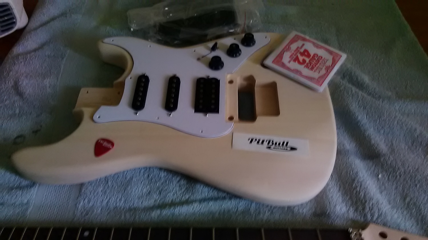

    My new kit came yesterday and yep its another Strat lol but Floyd Rose STF-1 ST its got a really nice body so wanting to go a tint on this one body is to good to hide under paint so not sure what ill do on it yet as been wanting one of them for a wile so its a keeper also wanting to grab a tele next week as well

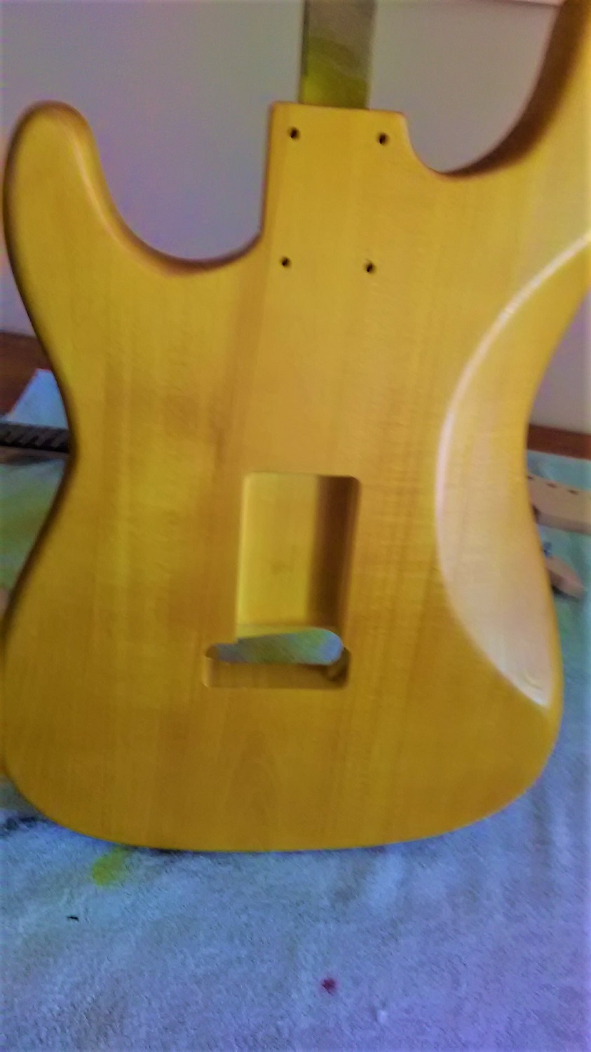

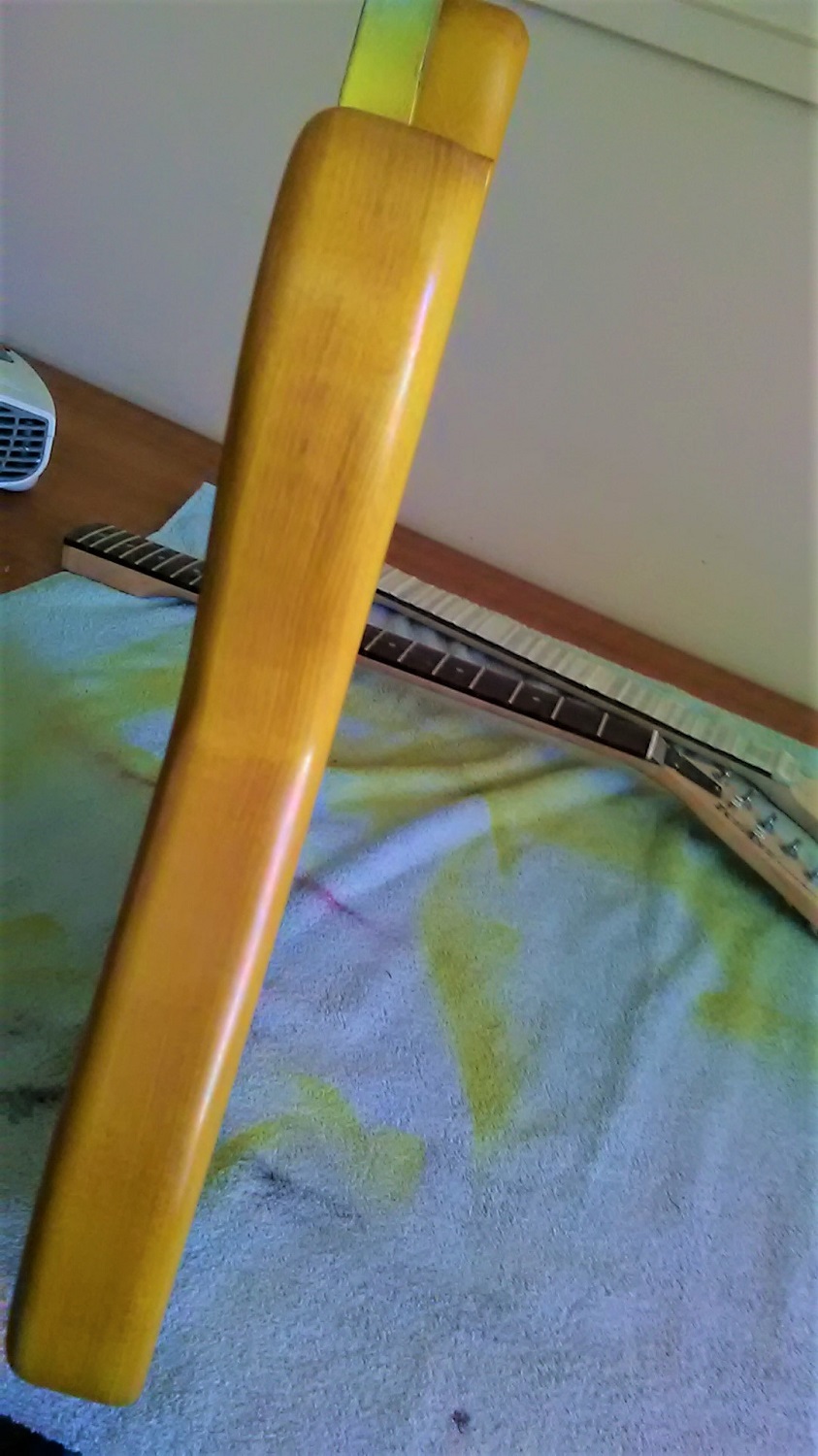

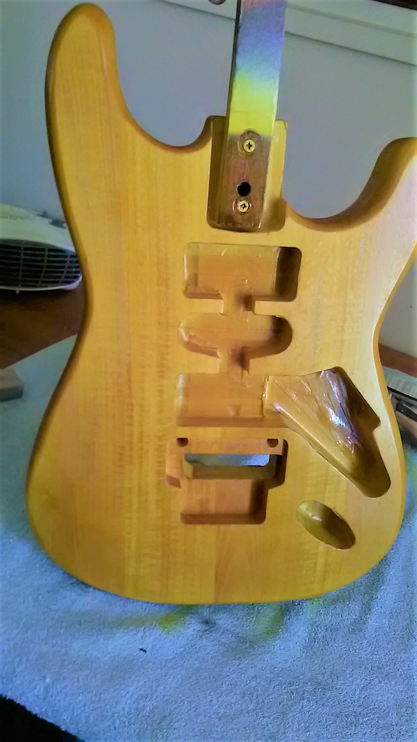

    have started doing my new kit have spent a few hours sanding the body up to 360 grit the applied the tint can clear it but not sure if ill do a burst yet may just go with 1 color been trying a different sort of finish

    its a candy yellow tint over bare grain just finished 15 coats of clear today going to leave it for a few days to cure then polish it, pic's don't really show the color but had a real nicely matched body would of been a shame to paint it with a solid color. does any one know where to buy pick guard material from? its got a weird size pick guard on it, much smaller than a standard strat, came with a boring white one probably because of the Floyd rose i guess. So going to haft to make one for it.
    Once the Strat is finished i got some candy apple red tint which ill do a telecaster the same way if it comes with a decent matched body, also got candy green but not sure what ill do with it yet.
