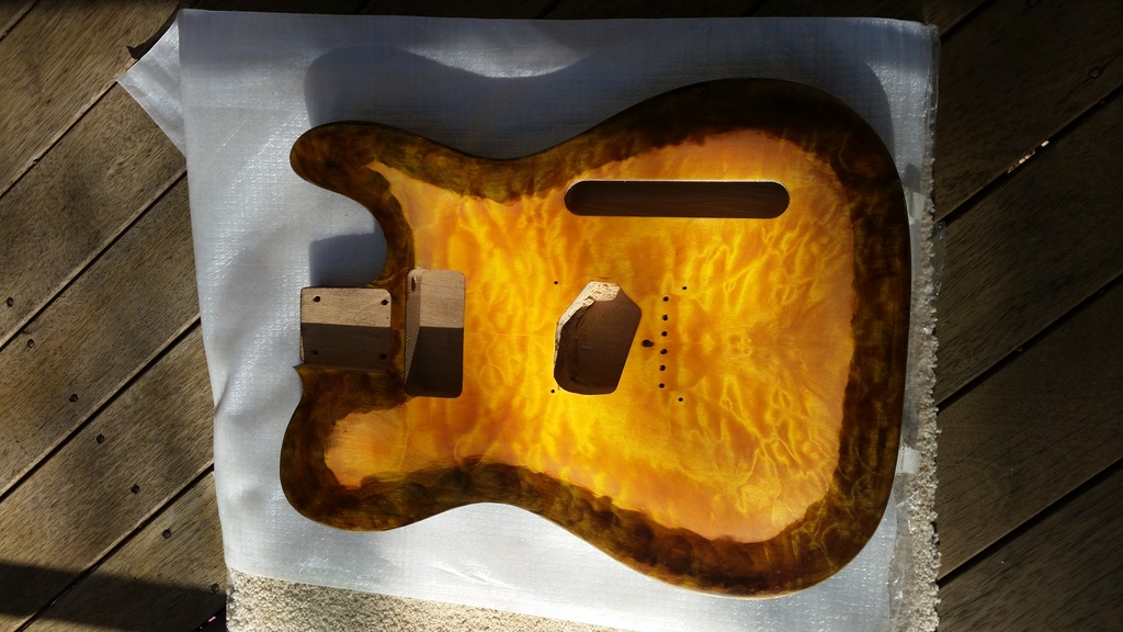

    I agree with Wokka; you'll need more blending with the stains. The color nevertheless, is wonderful!
    should work out fine, you might find some very light sanding with a gentle grit will help blend - go easy though , you know how thin these tops can be
    2,810
    Gave the dog a gentle run over with a bit of 400 grit and it really tamed the BS stain, added another coat this morning with a bit of attention paid to the inner margin to stop it becoming a hard line.
    I'll give it a few days to dry and then touch the edges again with something finer and hit it with another CG coat before letting it rest before the intensifier stage

    What are your plans to feather the burst transition area a bit more? It does look a bit of a hard line at the moment.
    2,810
    There certainly are plans in place Simon and prior to the coat of Black Stump today the margin was very nice.
    Having said that if you go back to the very first post you'll see it's not a traditional burst.
    Next will be a light sand at the margin with another coat of CG before flatting off and intensifier
    It's certainly not. The transition area is quite small and the outer area is very dark. Hope it all works out for you, Dave.
    2,810
    So do I Simon, but in saying that it's going to be a player not a show pony but I reckon I'll get a finish I'm happy with.

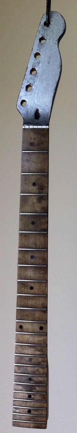

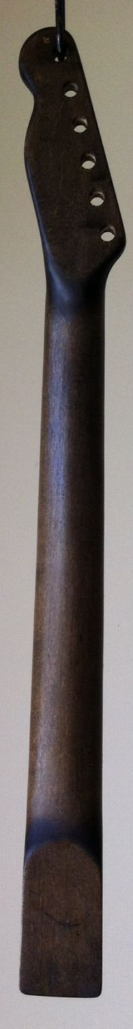

    Thinking through the masking dilemma and reckon that if you put one fine coat of clear on the 3-5mm edge of the maple fret board top you should then be able to mask and stain with a bit more confidence and once dark bits are fully cured reverse the masking, lightly sand off the original clear if no longer wanted and proceed to finish off front how you intended.
    Or you could attempt something like this....
ID:	18670Click image for larger version.
Name:	neck front after headstock paint.jpg
    If the fret board was masked the dark effect would have stayed on the back but for this build I wanted that dirty look all over. Easy enough to stop at the actual fret board level but that means you have to re-do the side fret marker dots.
