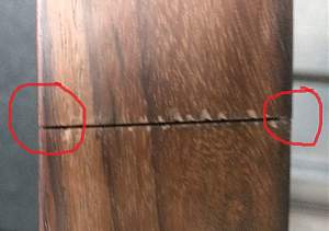

    I was thinking that I might use the veneer method for filling the fret slots. As you can see I had some chip out. Pic's a bit fuzzy...the chip out is not that deep, and I think it will sand out. Meanwhile I discovered something I had not seen before. The fret wire had been trimmed so that the part below the surface of the fretboard did not go all the way to the sides. The slot originally went all the way to the side, but the ends were filled with...something.
    I am guessing that I can cut it out. The slot is between .020" and .022" and I think one of the serrated feeler gauges will cut. Hoping this makes sense.
    It does.
    It seems to be 50/50 on my guitars as to whether the fret tangs are cut short or run all the way to the edge of the board.

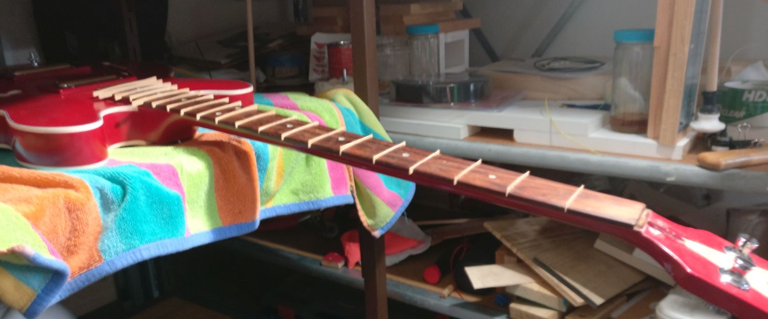

    Not a super sharp image. I managed to knock out the filler that was at the ends the fret-slots. with my makeshift .020 serrated feeler gauge, which also worked pretty well for cleaning out the slot.
    I have now cut some anigre veneer to go in the slots. Why did I choose anigre, you wonder? Because it was (a) light colored and (b) the only veneer I have. I got a 12" x 29" piece of this stuff about two years ago and have been using it slowly to correct mistakes every since. The internet tells me that it should have about the same density as maple, so it should be OK for this. Got to be at least as good as wood filler ;-)
