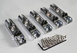

    String spacings could be an issue if your neck is quite narrow towards end of the fret board. Never seen or heard of a bridge with sideways adjustable saddles. Maybe these individual bits might do the trick?

    Some of the Schaller bridges have sideways adjustment. Had problems with getting a better bridge for narrow bass string spacings before, but the Peavey seems to be a wider spacing than standard by a few mm.
    I'd thought about individual saddles, but it would then be a case of having to fill in and disguise the existing saddle fixing screw holes. The individual ones would be good on an un-drilled body.
  4. #134
    Yeah, just re-checked your bridge and it is anchored with 6 screws and they are positioned either side of the string so those individual ones wouldn't hide the old holes.
