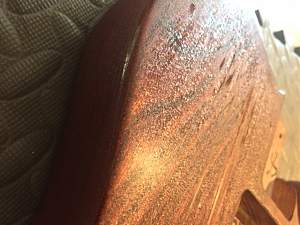

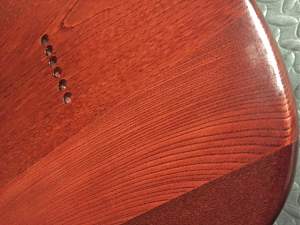

    Putting too much DT Finish on
    Meet what happens when greed and inexperience have a baby.

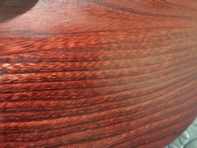

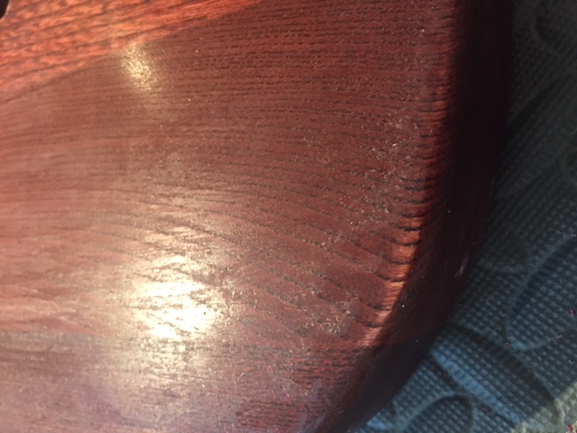

    Yup too much DT final coat.
    It was difficult to sand back as you inevitably take off some stain. I sanded back with 600 grit then 1200 grit.

    Its heartbreaking, frustrating and saddening. buuuuut the punishment kinda fits the crime.

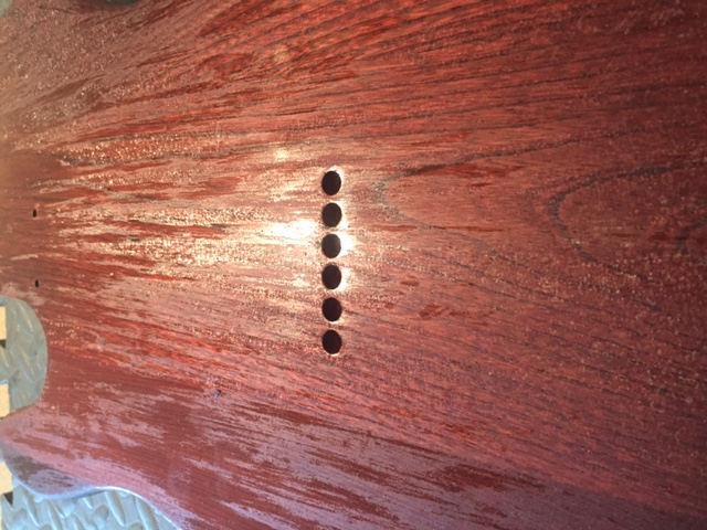

    Re-stain

    Lookin' pretty good after about a day already. I'll probs do another intensifier coat before starting the finals again.

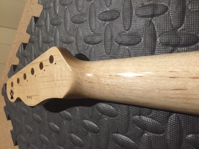

    Final Neck Coat
    In contrast the neck coats have been going along well. I think because they harden more, they are a bit more forgiving if you apply too much and need to sand it back.

    That will make it two thin neck coats with 2000 grit in between over the decals. I'll see how this one hardens but i think it will be the last one. if so I'll probs leave for 21 days or month and then cut and polish. If not I'll just put one more thin coat over the headstock face and back only as the neck is pretty much perfect
