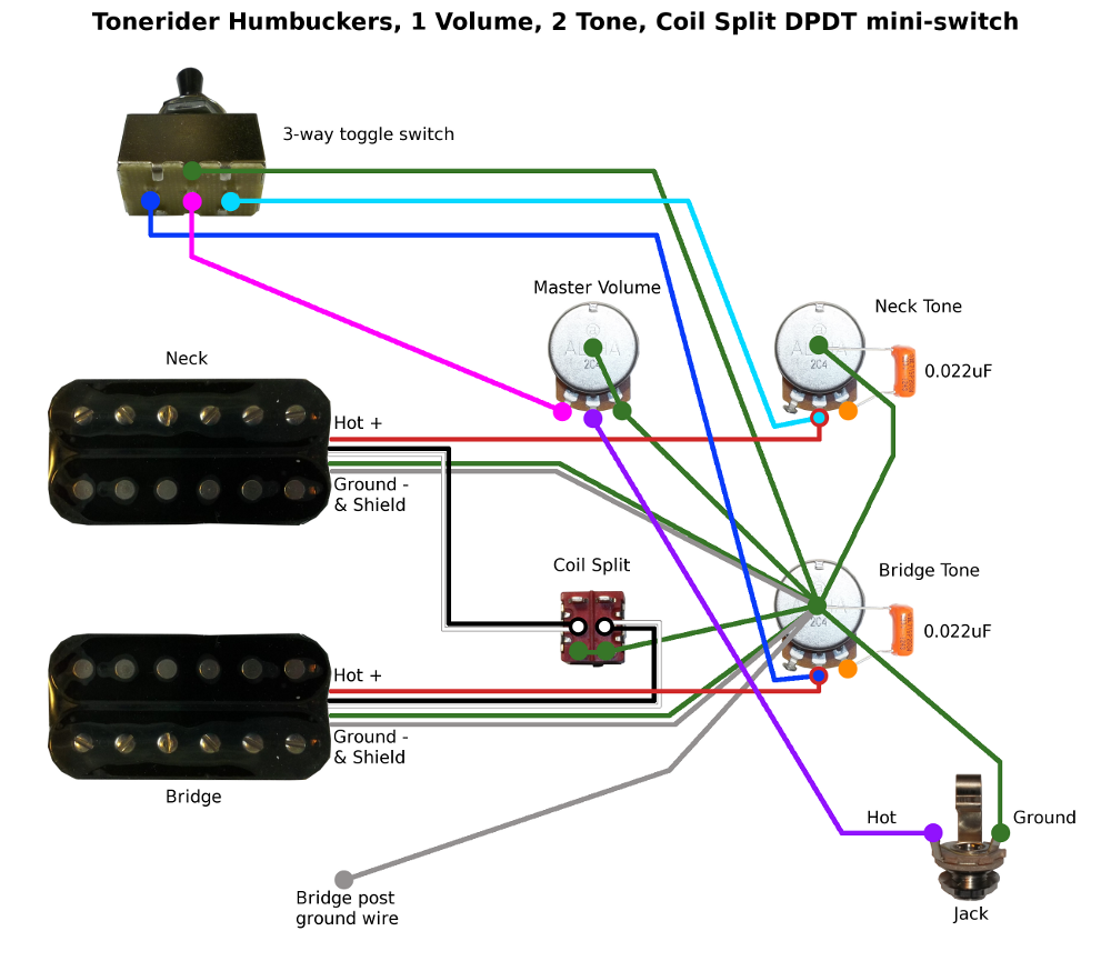

    Ah sorry, I thought you posted that you were getting a set of Entwistles. Here's the Tonerider version:
    The longer wire run to the selector toggle switch would be better with shielded multi-core wire, but the stock wire is ok for the short connections within the shielded control cavity etc.
