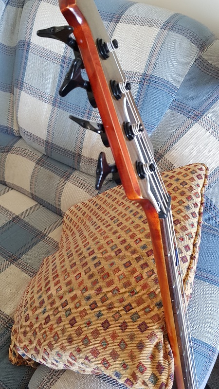

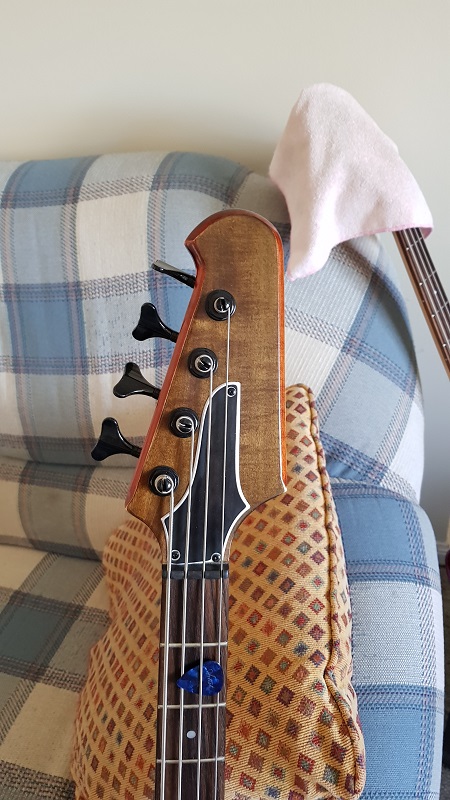

    Would you know what is the headstock angle on this kit? Cheers
  5. #125
    Mentor ozzbike's Avatar
    Sunshine Coast, Queensland
    1,109
    Mate took these pics for you. Not really clued in enough...or keen enough...to measure the neck angle accurately.
    But here are some pics of the headstock and neck.
