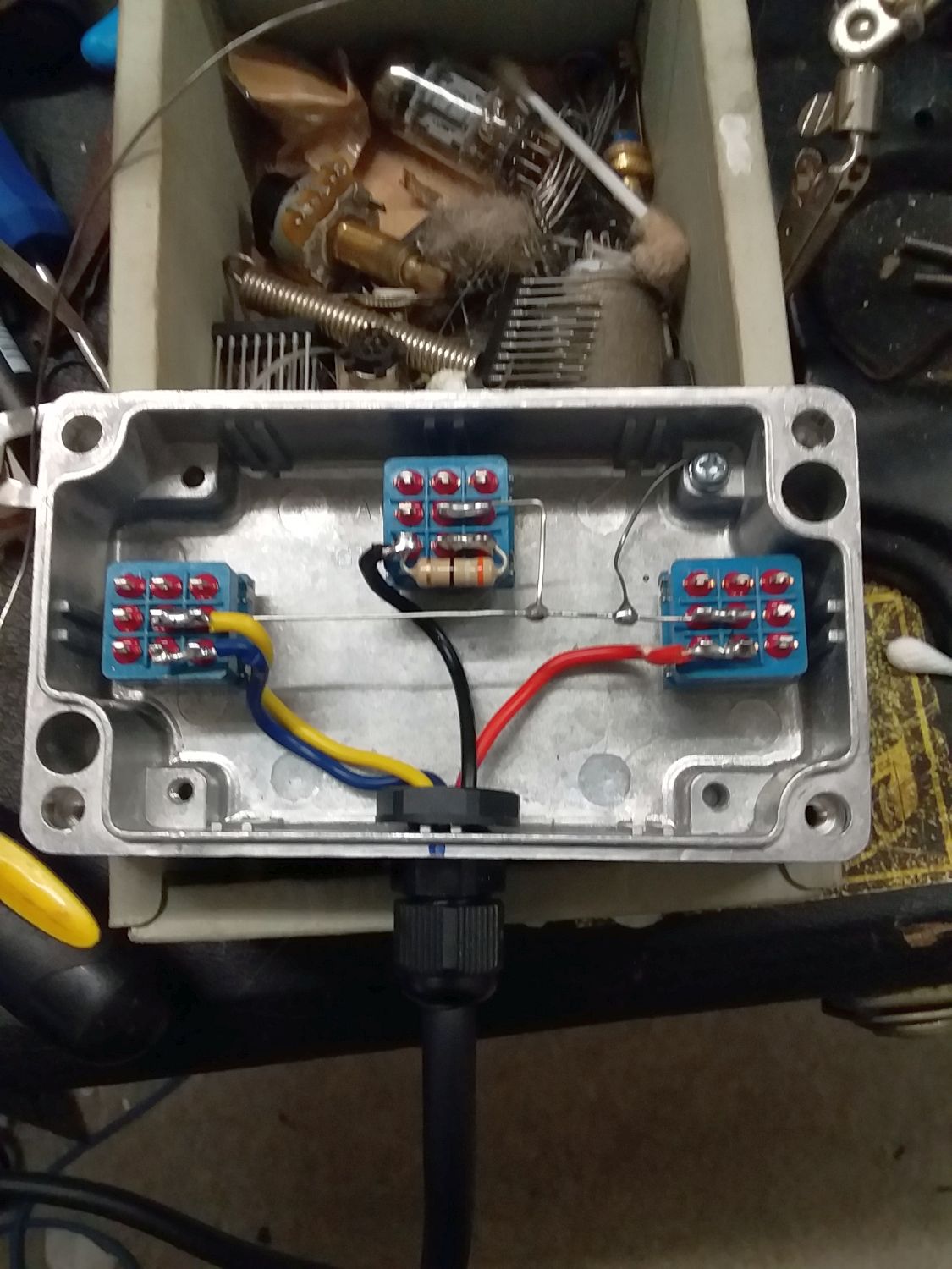

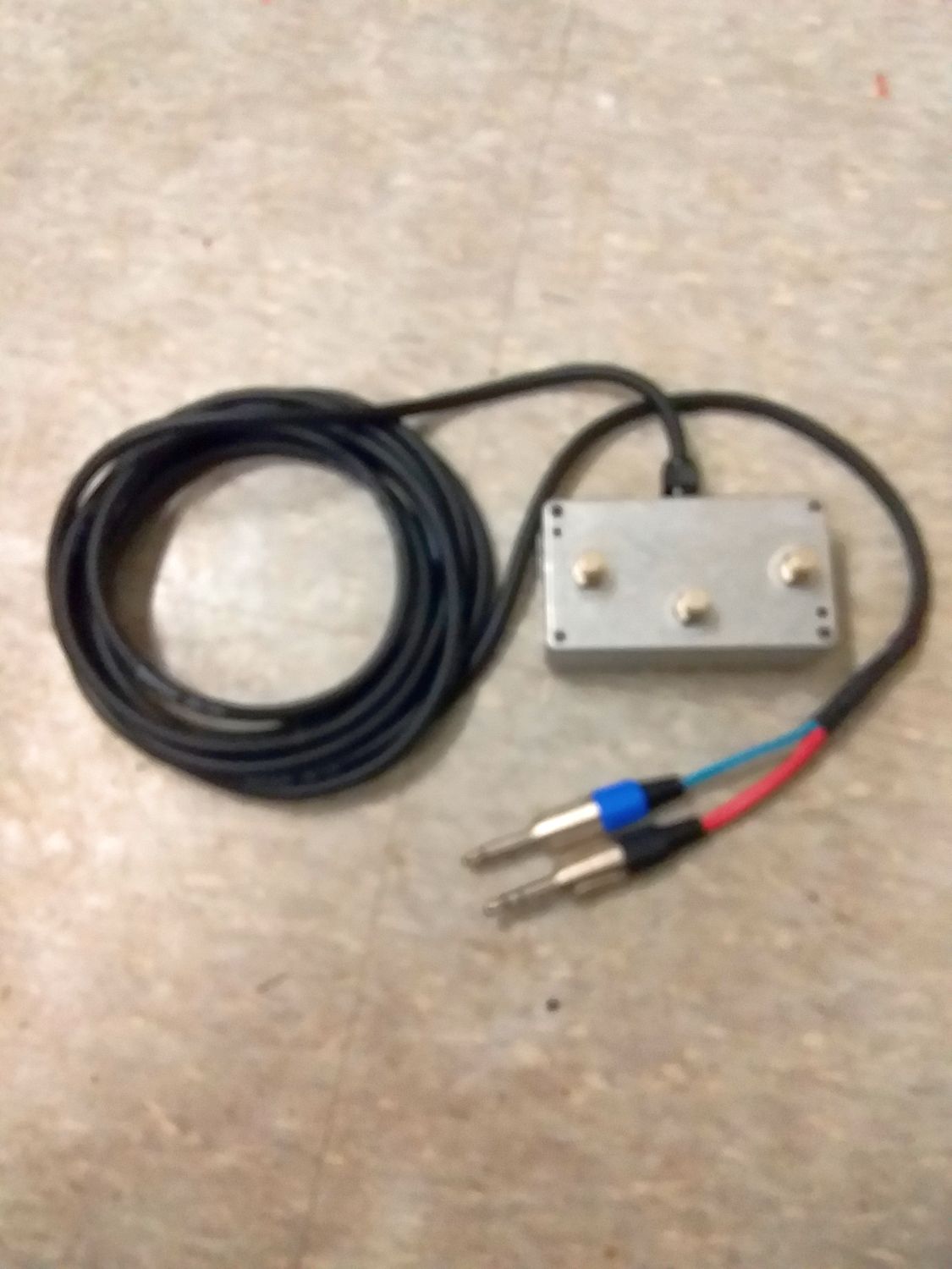

    So, I bet you guys are interested in hearing about what I've been up to this week, well, I've been in the process of making a complete new footswitch for my Super Twin amp, yes, it does feature footswitching, the built-in 5-band EQ, Distortion, and Volume-boost are all foot-switchable, I went to my local Jaycar Electronics shop on Tuesday and bought all the bits and pieces needed to make the new footswitch, here's a couple of pics of it:

    The new footswitch seems to be working perfectly, with the new footswitch unplugged from the amp, the 5-band EQ, Volume Boost, and Distortion is always on, although you can switch the Distortion on or off with the Distortion control knob, now, when you plug the new footswitch into the sockets on the back panel of the amp, the 5-band EQ-, Volume-boost, and Distortion can all be switched on or off remotely just by stomping on the footswitches, this means you can pre-set the 5-band EQ and Distortion controls to get the sounds you want, and still be able to get the basic clean sound of the amp, the Distortion itself is nothing to write home about though, you can always just use a distortion pedal since the amp does take pedals well.

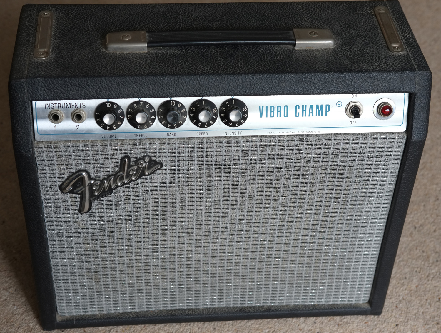

    Right at the other end of the Fender power scale...

    I've borrowed a friends '81 Fender Vibro Champ. 5W with a 4-Ohm 8" Eminence speaker. One 6V6 power tube, one 12AX7 for the preamp, one 12AX7 tube for the tremolo circuit and a 5Y3GT for the rectifier. The tremolo circuit uses power tube grid bias adjustment to change the volume. The circuitry (AA764) hadn't changed since the Blackface model Vibro Champ was introduced in 1964, though the fitted speaker has changed over the years.
    As you might have guessed, with 5W and an 8" speaker, it's not very loud and it hasn't got much clean headroom. With a Strat, it starts to break up with the volume at 4. With a Les Paul (humbuckers and P90s), that point comes at 3. Above 5, it doesn't get louder, just dirtier.
    The tone controls aren't that effective. Bass works from 1 to 5, above which nothing else happens. It may well do more, but the fitted speaker can't produce the bass frequencies necessary to hear the effect. Treble works from 5 to 7; below 5, nothing is added and above 7 almost no change can be heard.
    The tremolo is quite a nice effect, but it's really wasted IMO as there isn't enough clean volume to make it worthwhile. It hasn't got quite the depth of effect that some tremolo circuits have. It also doesn't sound that good with a driven sound. What would have been more worthwhile would have been a reverb; there's enough space in the cabinet for a short-spring unit. My cheap Tone City Temble pedal does a very good imitation of this amp's tremolo, though the intensity control on the pedal can produce a full 'silence in the gaps' tremolo.
    It's main use is really an easily driven small recording combo where it's ideal for crunchy sounds that still retain some clarity. Think raunchy Stones numbers. It sounds dirty, but it hasn't got bags of sustain - it's not going to give you anything like a long creamy lead sound without external help from pedals. It's better with humbuckers or P90s for this as Fender single coils can sound rather thin and scratchy with the drive sounds, as the lack of any real bass makes the single coil sounds rather scratchy. Even humbuckers don't sound overly bassy, but in a mix, that light low end will stop the guitar sound from fighting with the bass guitar.
    For a small Fender combo that's got some decent clean headroom and that works well with Fenders, you really need the next step up on the Fender amp hierarchy and move to the 12W Princeton Reverb. This has a 10" speaker, reverb and tremolo.
