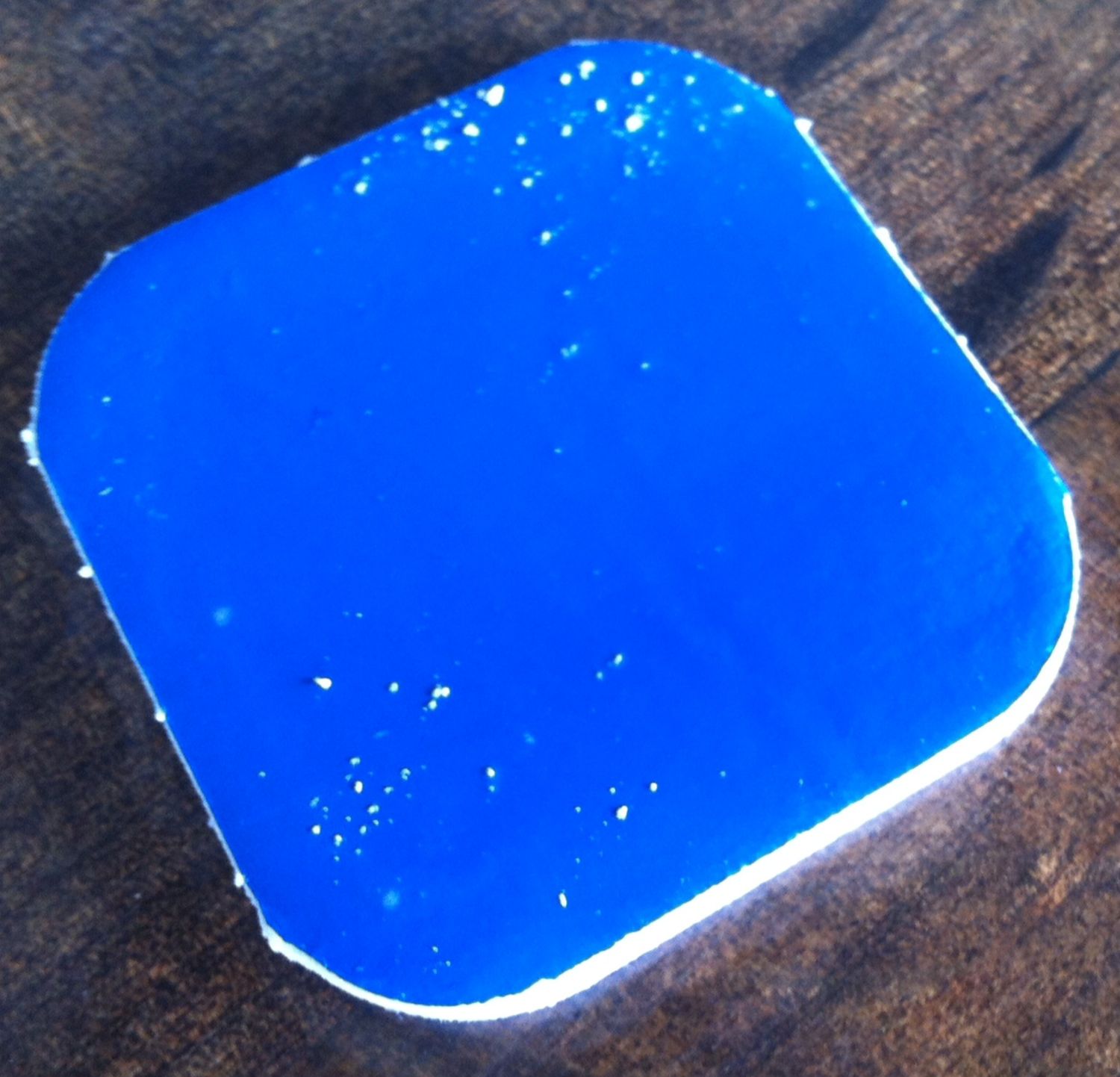

    Some of the numbers have already been worn off the 4000 & 6000 micro mesh pads. Here are some close up shots of the fine grit particles that these micro mesh pads bring up, and this is after wet sanding to the smoothest level possible with the previous level of grit.
    This is the 6000 pad...
    Attachment 20665
    Now the 8000 pad...
    Attachment 20666
    And finally the 12000 pad...
    Attachment 20667
    Surprising how much grit these things pick up from the finish, even up to 12000 grit
    I have gone through all the grades of these on the FrankenWashie on Bare timber and even with the Vic ash center section it has pulled up a fantastic shine.

    All good Dave. Yesterday's efforts took about 2 hours going from 4000, 6000, 8000 up to 12000 where most time was spent on the lower grade grits. I have used these pads on 5 builds now and the best results seem to be go all out on the one grade of grit until it stops giving up crud and /or milky film of water and feels really glassy smooth to the fingertips. Then go again with then next finest pad and be totally surprised how much they still cut through the surface where at the previous level you may have thought it was good enough. Once you get to 12000 it is insane that there is still some cutting action going on.
