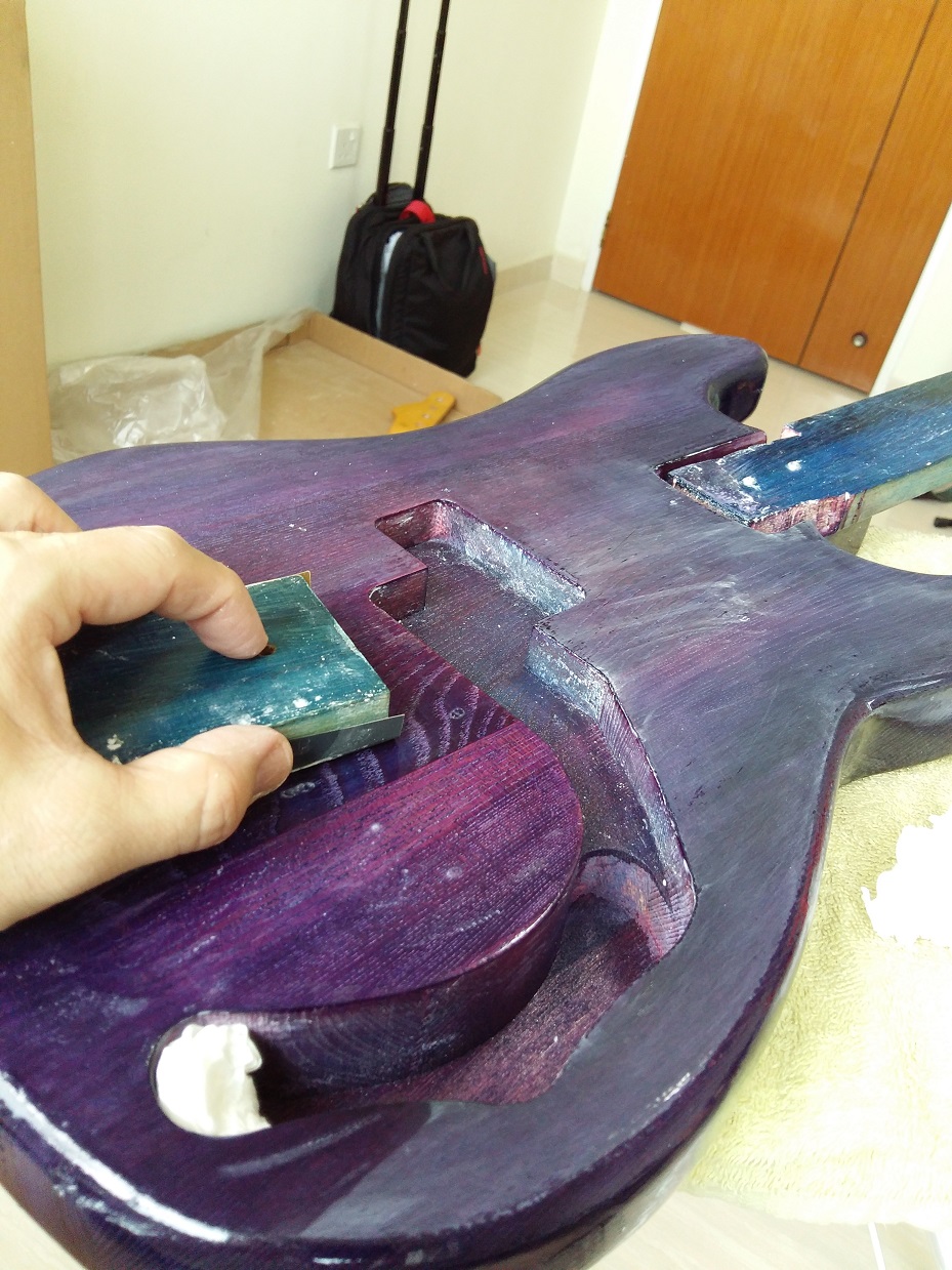

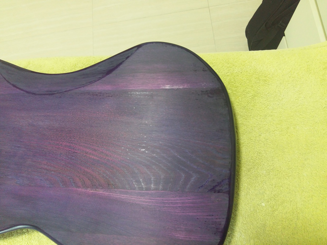

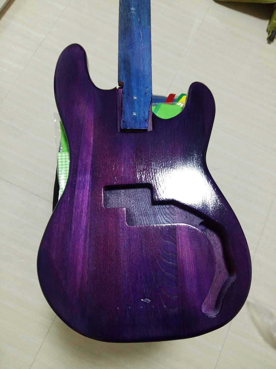

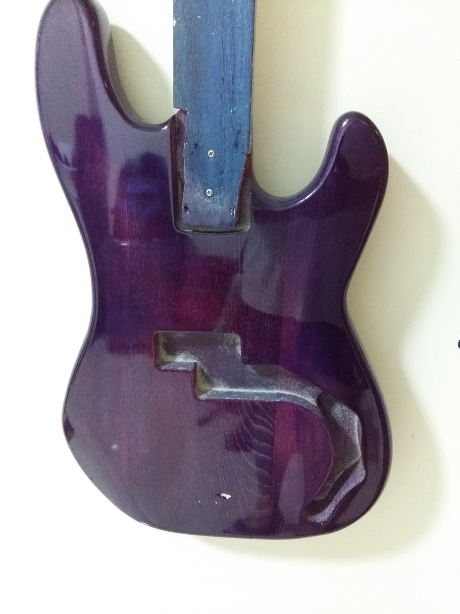

    Over a month, I'd been applying water-based urethane vanish on body. It was not easy to build up thickness by varnish, so i just kept coating, drying and sanding once per 2-3 coat till around 10 coats. since by brush, surface is very lumpy. so I tried to flat surface by wet sanding with 500 grits before i go for final coat by poly urethane spray.
    maybe I was too hurry and rough... and happened this.
ID:	18286 ... Click image for larger version.
ID:	18287 ... Click image for larger version.
    again carefulness&patience

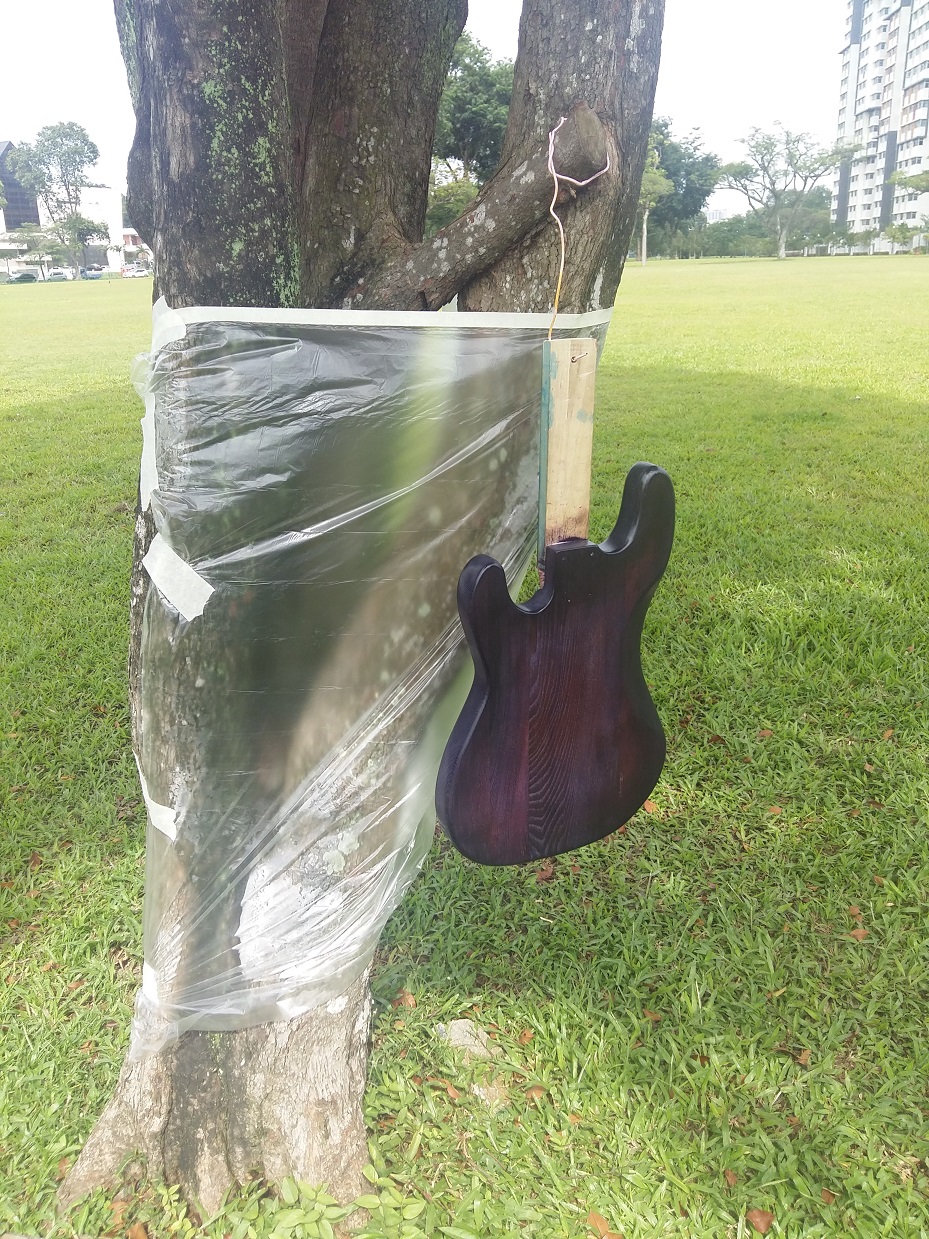

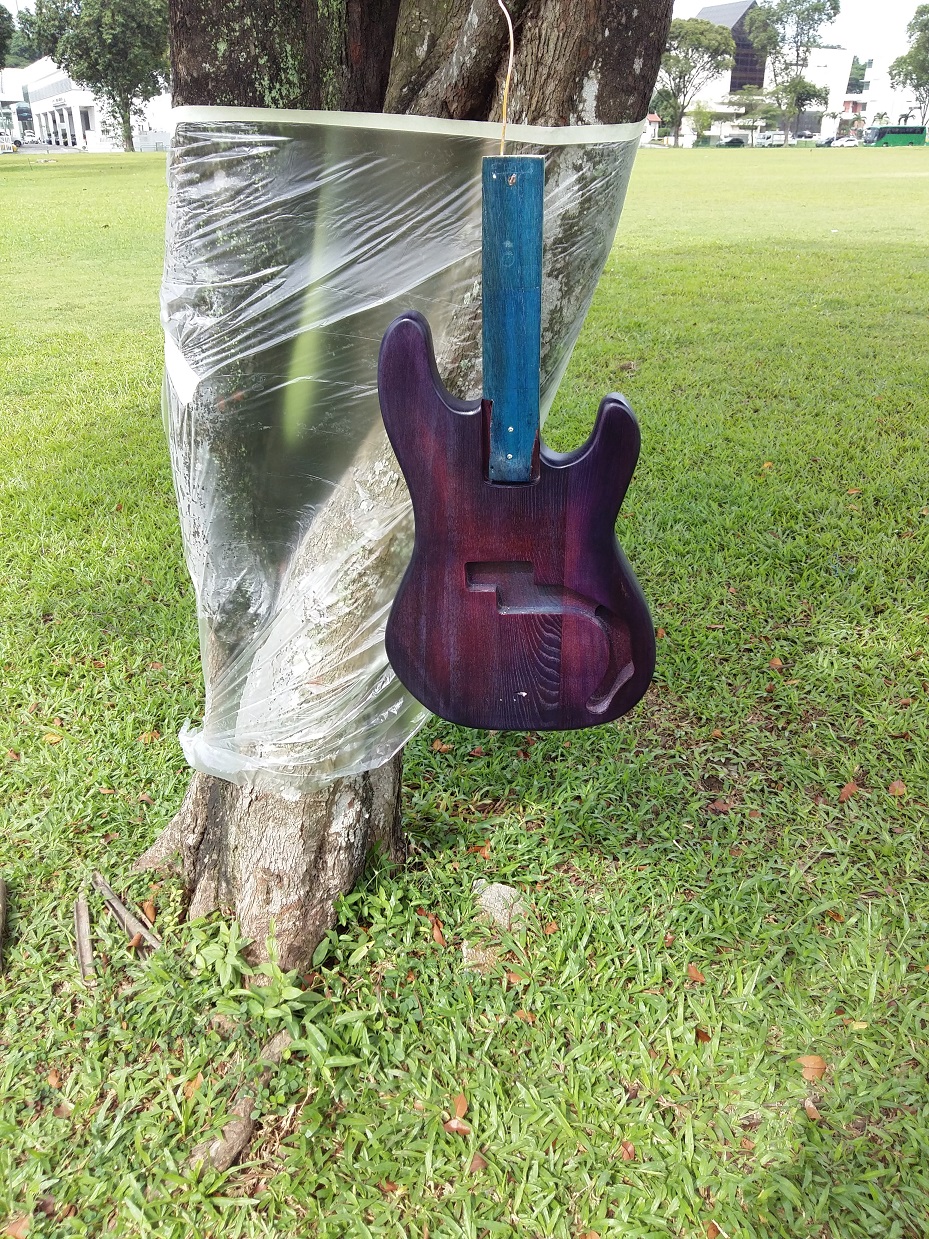

    maybe the surface was not flat enough, clear coat on the part seemed thinner. should i stain partially, should i remove all varnish coat?? Now i know the importance of sanding... This time, just I have decided to move forward to final spray clear coat at backyard.

    That finish is probably thick enough so that you can simply sand it flat. I'd be using something coarser than 500 grit for flattening, as that's pretty fine. 240 or 320 would be better to start with, then move up to the finer grades. If you look in your pictures you can still see some shiny patches - which are dips in the finish where the sandpaper hasn't reached yet. For a really smooth finish you need to sand those areas more so that there are no shiny patches left at all.
    I'd be wet sanding all this as it stops the paper clogging with paint and the hardened paint on the paper making its own marks. Look at the finish at a low angle against a bright light, as it shows up the dips more clearly.

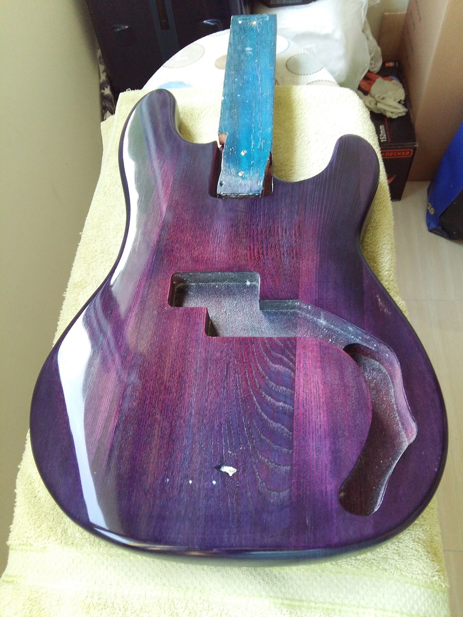

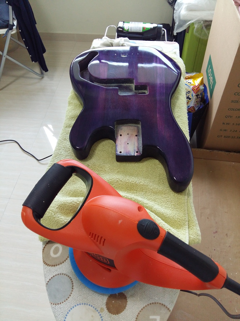

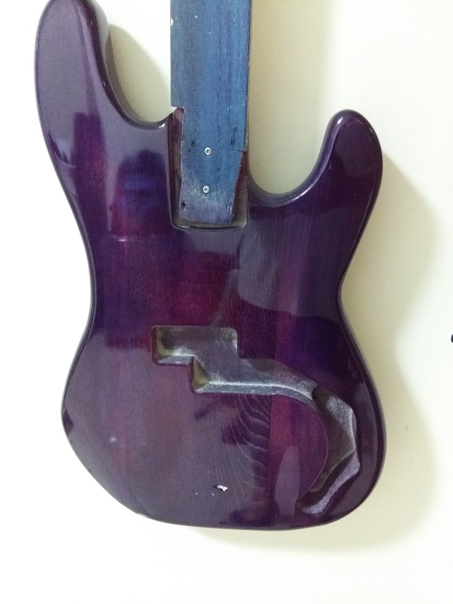

    And also thank you for the polishing instructions. Last Sat and Sun, I tried your instruction and it really worked well. I did wet sand with 500, 800, 1000, 1500. As you taught, it could have been easier to start with 240 to remove dimples, but I felt not enough thickness was fully built, so I was bit scared. however, so far it is getting glossy. here is photos in progress. still fine scratch lines being seen.
