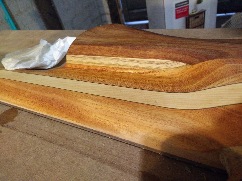

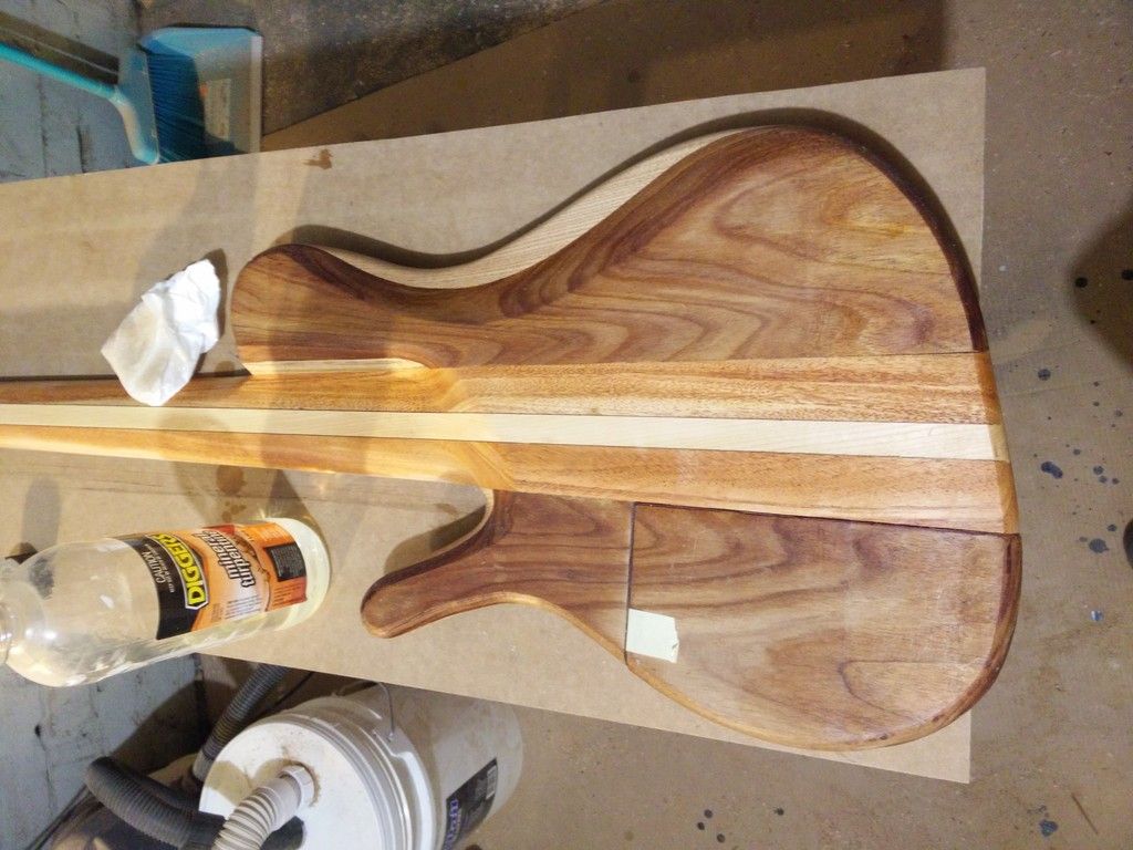

    Looks amazing Simon. Very impressed by your ideas and solutions. How did you compensate for the 3mm aluminium on the other piece of blackwood? Just sand it away?
  2. #122
    Thanks gav! I free hand routed out the shape but I went 1mm too deep. I glued on some veneer to compensate for the height difference later on.
  3. #123

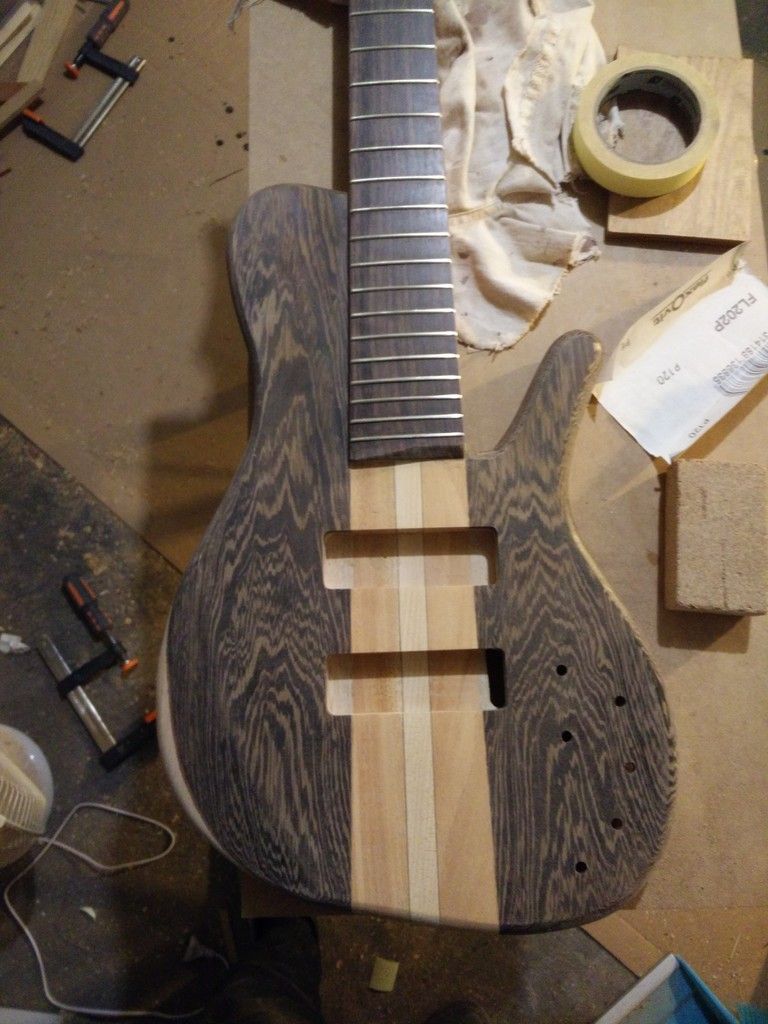

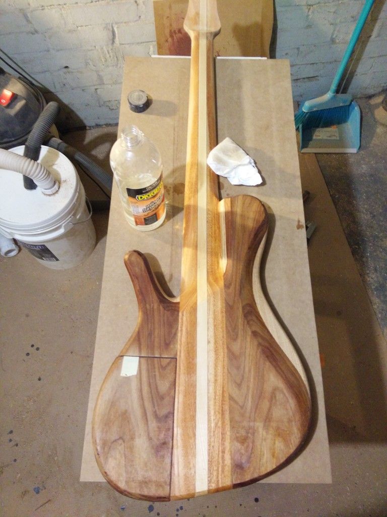

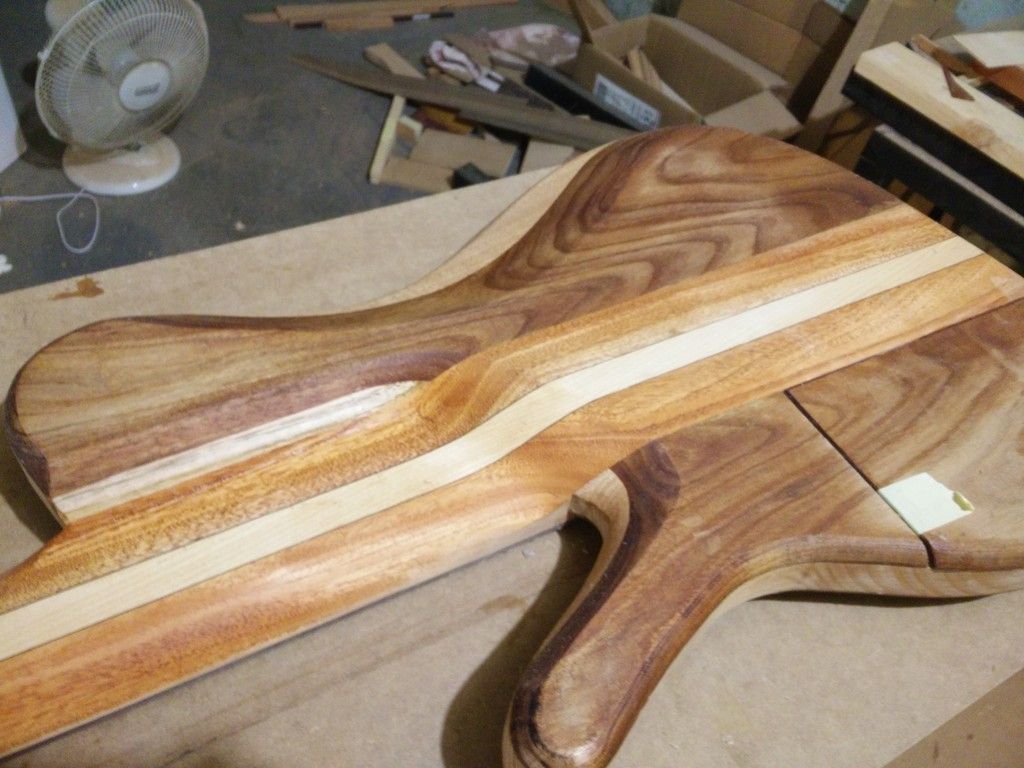

    Sorry haven't been posting. I was trying to do as much as I could during the week. I'll write up a detailed process when I have the time, but here's some pics.

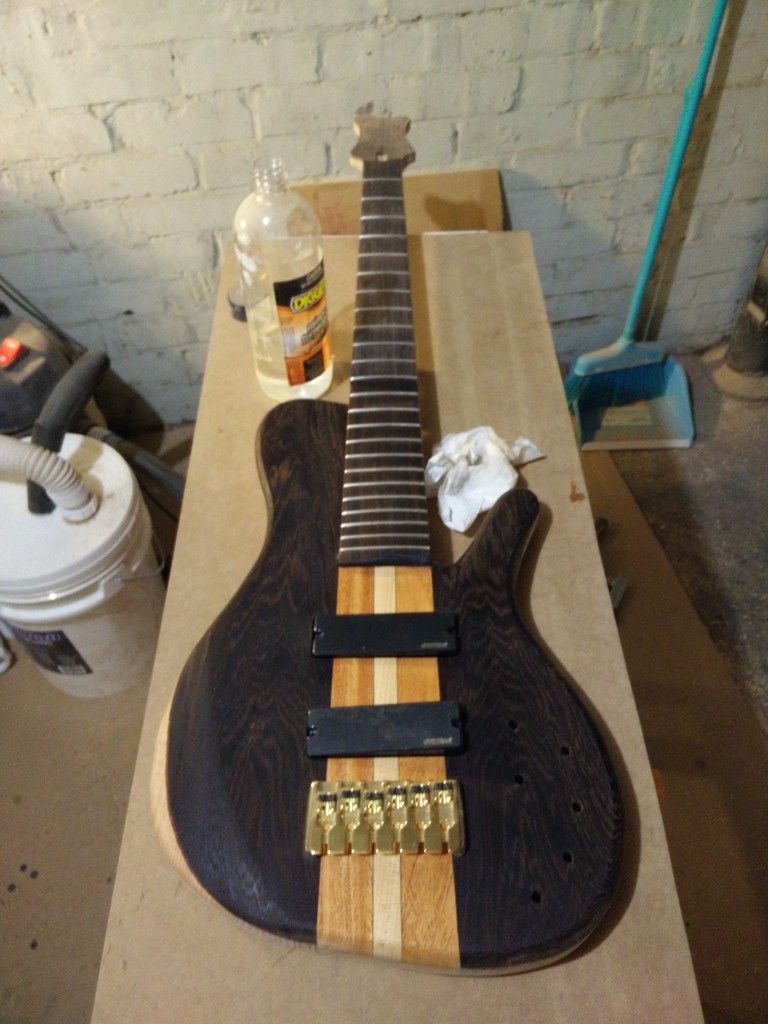

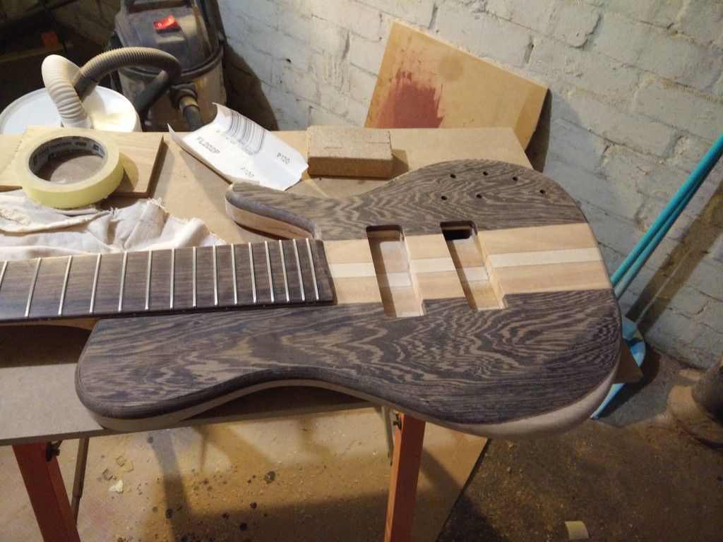

    With some mineral spirits applied. The wenge became really dark so I think I'll have to sand to a higher grit and hopefully that won't make it too dark when the oil is applied.

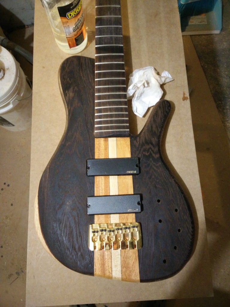

    Almost there! I'm doing the headstock inlays tomorrow and will have to make a truss rod cover. I already made some matching wooden knobs and hopefully they'll turn out nice.
    And then I have to wait for the machine heads to come before I can complete the headstock. Then it's the finish sanding and finishing!
