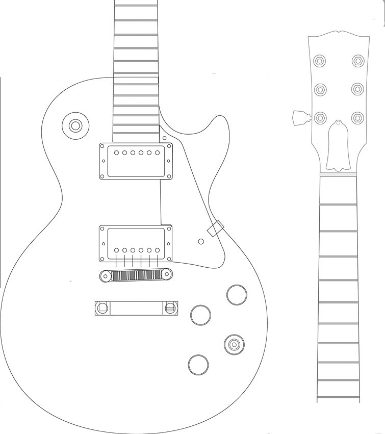

  6. #126
    Hi Alkay, it's not a very good image but I usually just pencil on a similar moustache shape, doesn't have to be perfect with a G type headstock.
    Or come up with something original

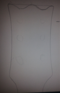

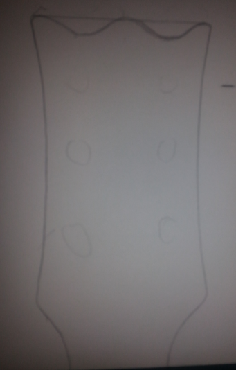

    ok cool, thats wokkaboy.
    I did a few sketches last night. Here's the one I come up with I like the most.
    It's only a concept so if I go with that I'll make the template more precise.

  8. #128
    no worries Alkay, as you say have a play around with shapes doesn't have to be the exact G type shape
    You will probably find the shape will be slightly different to your template anyway as you will be sick of sanding and shaping hahha

    haha I can almost guarantee that one. That shape above has probably been done. With so many diy builders around the globe I'm sure there is no unique headstock shape left for most guitars. But I'll get to something I'm happy with and go with it.
  10. #130
    that's it Alkay pretty well every shape has been done before. Some on the forum have done a horizontal S shape and left the corners the same height can work.
    Just play around with a shape you like.
    Another tip is to sticky tape your template to the headstock and look at it over a few days you may change your mind on a certain shape
