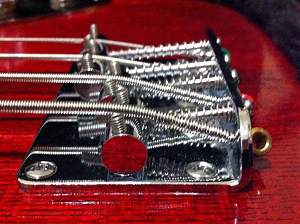

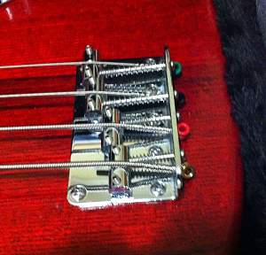

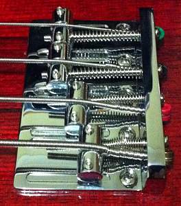

    Well, couldn't help myself as it was eating at me all day at work today so after dinner proceeded to swap bridges. Here are the before shots...
Name:	Before photo 1.jpg
ID:	15392Click image for larger version.
Name:	Before photo 2.jpg
ID:	15393Click image for larger version.
Name:	Before photo 4.jpg

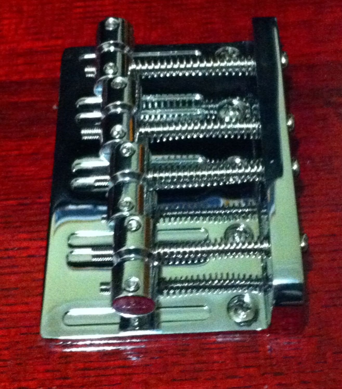

    Thankfully original mounting holes lined up in exactly the same place for the Gotoh bridge and here are the after shots....
Name:	Ater photo 1.jpg
ID:	15396Click image for larger version.
Name:	Ater photo 2.jpg
    Retuned intonation and all perfect now that there is a bit more fore & aft adjustment room. Had a blast playing this then the EX-5, onto the Ric 4003 and back & forth for an hour or so just to make sure all were functioning properly plus to help get a better perspective on the tonal sound differences between each Bass.

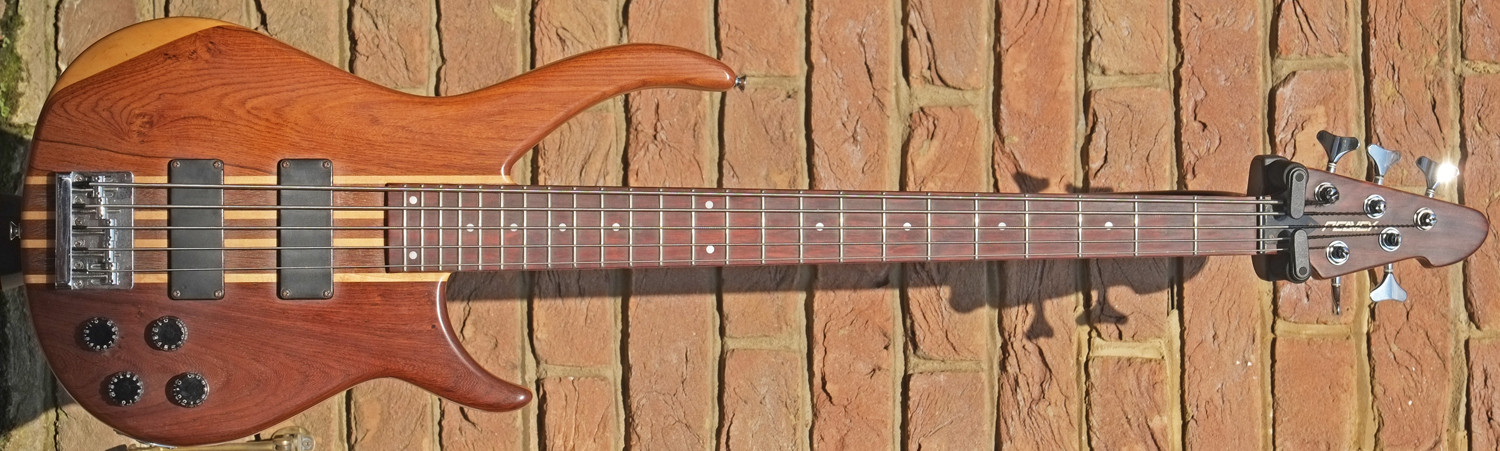

    Did you find the bottom B string hard to fit through the hole in the rear of the bridge? I've got an 80's Peavey 5-string that I'm refinishing (and is currently part sanded and all in bits). Whilst it is supposed to be from their custom shop, its serial number of 888888 (on a holographic Peavey custom shop label) leads me to think that it might have been a prototype, especially as it was very poorly finished with no grain filling. The bridge is quite robust, with a thick rear bar, but I really had to pull the B string through using pliers and a lot of force.
Name:	Peavey 5 string small.jpg
    As a result, I want to get a different bridge, but most of that style of bridge use the same sized holes for all the strings - and the same size as all the holes in the equivalent 4-string bridges. This strikes me as wrong. I may also look at rear string mounting bridges, as I'm now happier about drilling through the body and fitting ferrules. But again, all the string ferrules seem to have the same sized holes! It may be time to get the drill out on those as well.
    Also, the bottom B sounded very dull indeed in comparison to the other four strings, with far less sustain, even though there was a decent break angle over the nut and bridge saddle. This was with two sets of strings. Is this normal?
    I suppose this might be something to do with the pickups, which I also want to change, but they are all encapsulated in resin, so I can't take them apart to see if they might possibly have 4-string innards. It did have active treble and bass controls, but they weren't nice sounding and the overall tone was very growly, so I may first try the pickups in a passive mode in case they can be redeemed, but they will more likely be swapped for some other soapbar pickups.

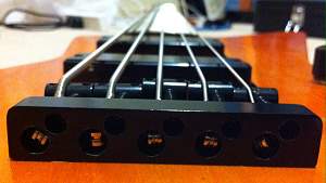

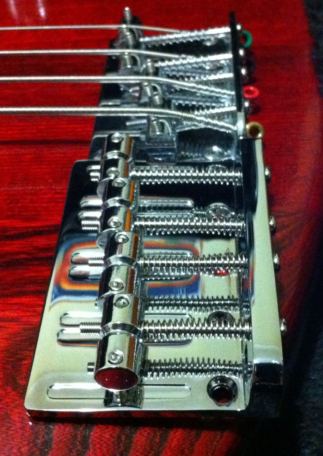

    Hi Simon, my fiver is the EX-5 and bridge looks similar to the one on your Peavey except the holes are big enough to take the ball ends into the base as per this shot. It is the standard PBG bridge that comes with the kit and have seen many that look similar on eBay.
    I am guessing that it is the ball ends that are protruding as they are doing the same on the Red J Bass as seen in last shot on the lower RHS of that post where the strings used are D'addario. Can't remember what are on the EX-5 and tend to think they are more a mid priced set as I have only been playing it on & off for the past 6 months. Must say that the string holes do seem to have a bigger diameter.
    Not sure rear loading would solve the problem unless you can find ferrules big enough to swallow the ball ends. There are some of the top mounted 'claw' styles that might work where the string is brought in through a groove at the back edge.
    Low B was quite dull on mine too and reckon that had something to do with the much lower subsonics as it is also much harder to tune with a tuner too. Thickness of string plus string tension are probably affecting sustain too but I found this was more of an issue on open B and up to C and rarely play those anyway.
    Swapping to better PUP's made a huge difference and all the strings now have same volume level and tonal clarity. Mine measure 102mm x 40mm and replaced with John Benson Customs for USD $200 plus $20 postage & handling. They had to be ordered via Adam at PBG as a special order and took a couple of months to arrive.
