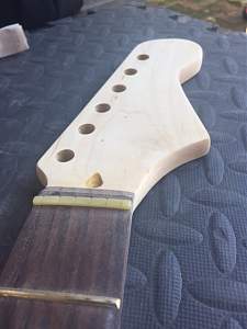

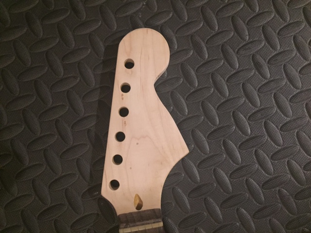

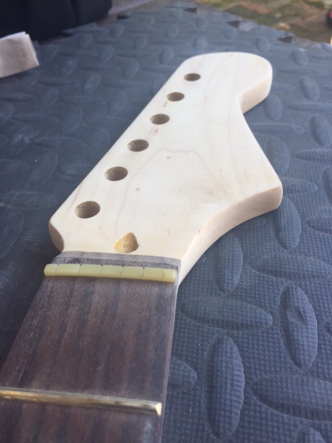

    Headstock re-shaped

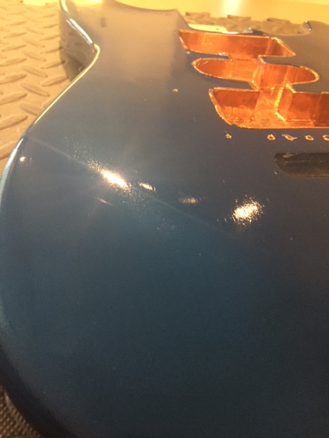

    Tru oil over nitro

    great progress Andy, you have really learnt alot of new skills since your first build. New headstock shape looks great and MOP fret markers. How did the tru oil go over the nitro no drama ?

    Amazed, surprised and delighted that TO over Nitro worked for you on this makeover.
  6. #126
    Well about that TO over Nitro. I got a bit eager in testing a patch, It buffs up nicely, however, i forgot how thin the coats are and ended up sanding right through in places. it was alright though because i was using the higher grades of micro mesh and it didn't hurt the nitro underneath. The second pic is after a quick polish and buff on that horn. then I went and sanded through

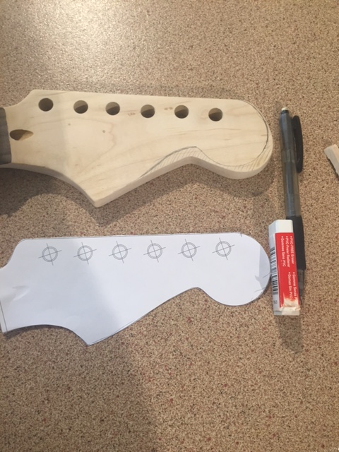

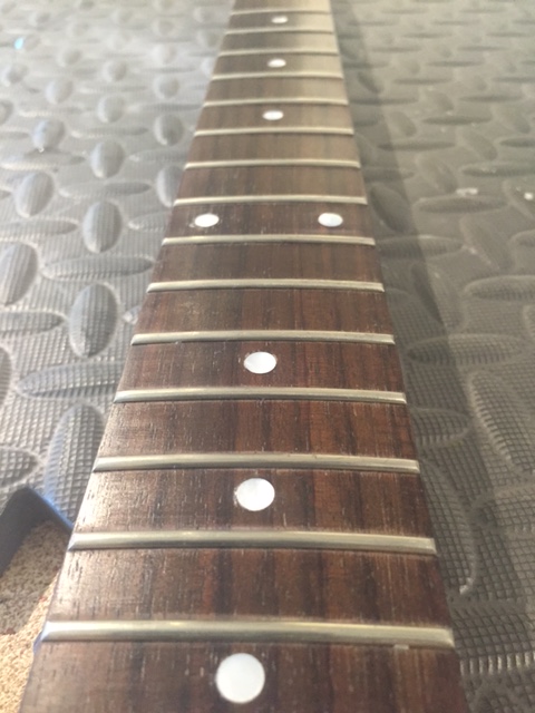

    sanded down MOP dots prepared fret board and Dingo Waxxxxiness

    Nice job and a very effective visual upgrade
  10. #130
    Looking really nice.
    Why the tru oil over nitro, interested ...
