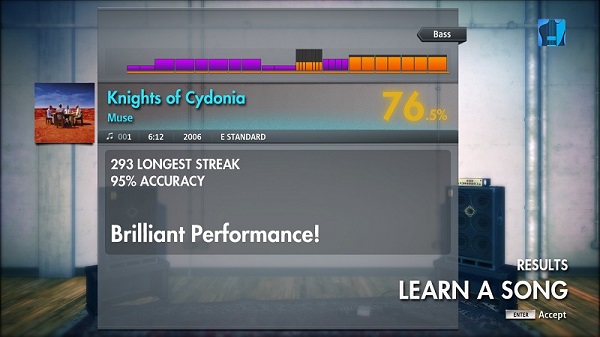

    Cool No Hysteria by Muse....but.
    I do not have Hysteria by Muse.....but I do have Hysteria by Def Leppard.
    Tried this one from Muse....Knights of Cydonia.....wow head shake there... All Good though.

    Haha nice stuff Ozz, did you play Knights of Cydonia with pick up till the end where it's finger? Heheeheheh.... Seriously, nice scores!
