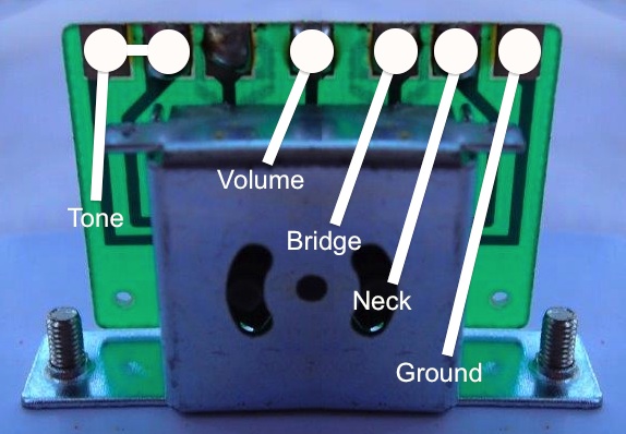

    Circuit board side towards the pots:
    That'll give you 1-3 hot with tone, and 4-5 mute. The ground connection on the end lug will mean the output is grounded in pos 4 & 5, which should keep it a little quieter when muted.

    That's awesome - good idea grounding the end lug too.
    Thanks again Weirdy. Will probably wire it tonight. For once a simple wiring job (no shoving a nest of pots and switches into the cavity).
