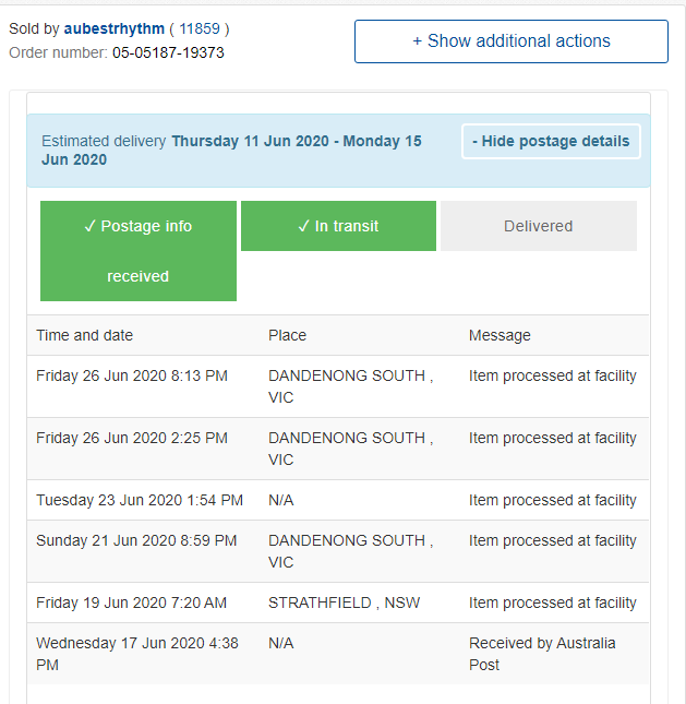

    Frustrating waiting for Australia Post to pull it's finger out of it's arse.
    Brought up the tracking history for the umpteenth time:
    Seems like my parcel is just circulating around since the 21st. on a carousel or something.
    cheers, Mark.

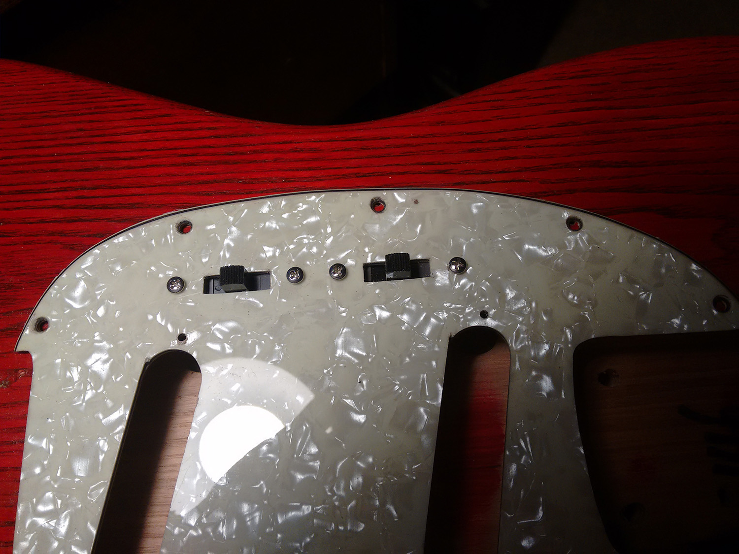

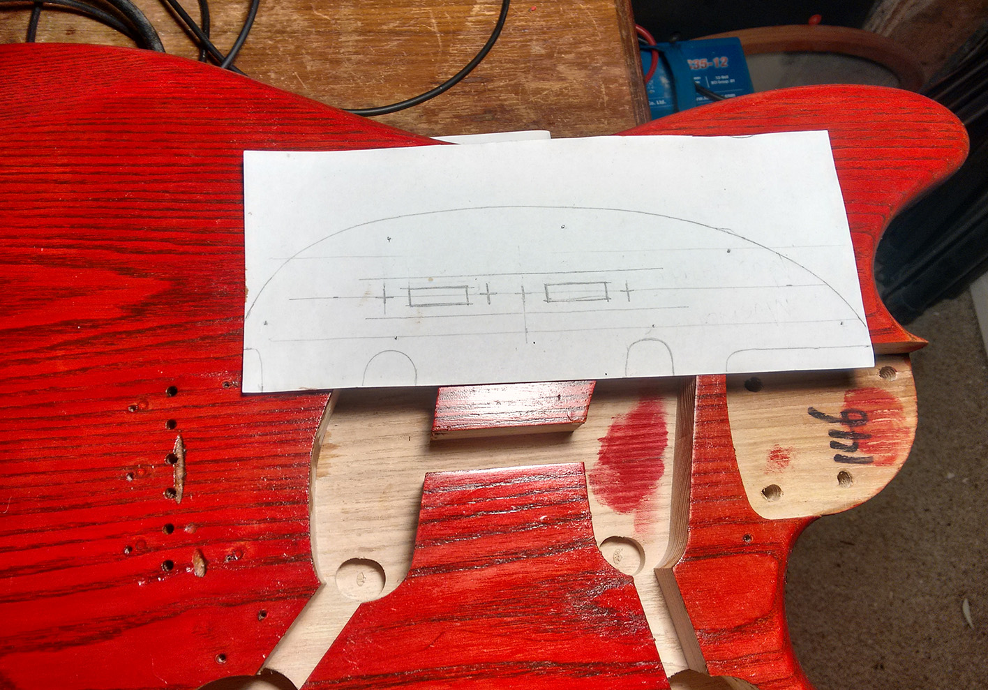

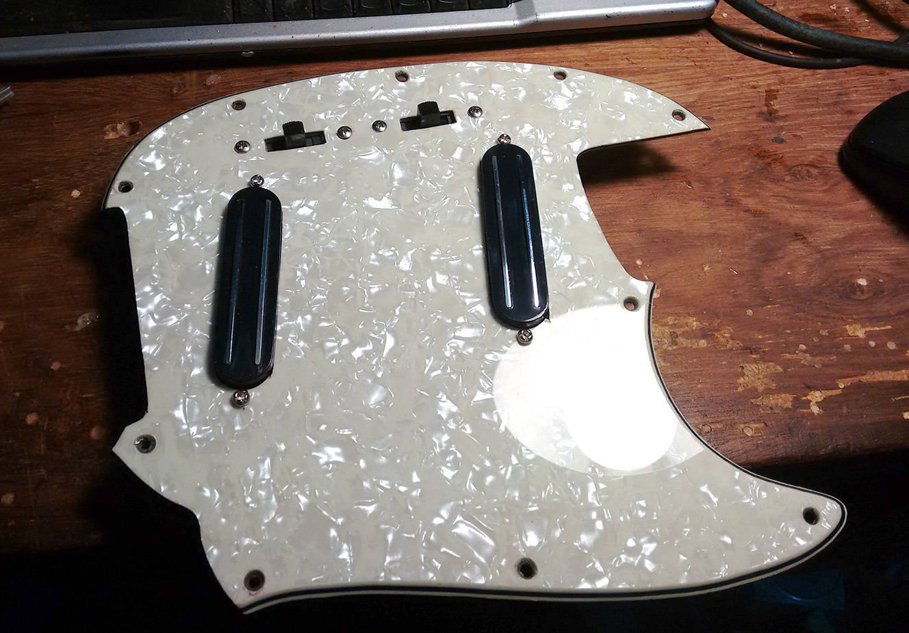

    Finally some progress.
    This really makes you realise that it aint no official Mustang template.
    Working out where to locate the switches.

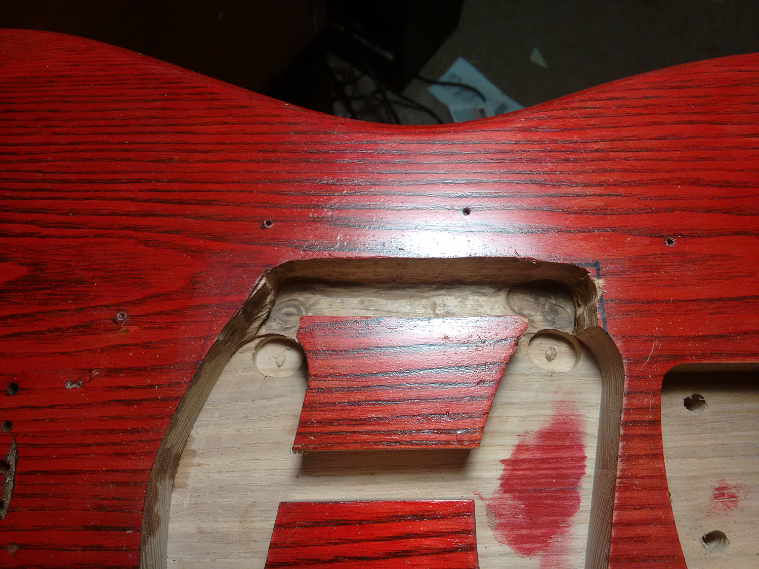

    Out with the drill and trusty Ozito Rotary tool
    Still some fine-tuning to go..
    After this it's back to application of Tru-Oil.
    cheers ,Mark.

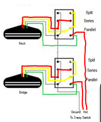

    Quote Originally Posted by OliSam View Post
    If you find a schematic id really appreciate if you could share it here.
    O.K. Oli, I found one that wasn't quite what I was after and did some crude alterations.
    This is only part of it.
    I figure that the 3-way switch, tone pot wiring would be easy to imagine.
Name:	Mustang Humbucker wiring 3.jpg
    cheers, Mark.
  9. #129

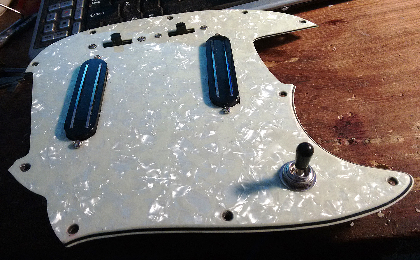

    DHL came through with the NU-X pickups.
    I'll probably install the 3-way switch next.
    cheers, Mark.

  11. #130

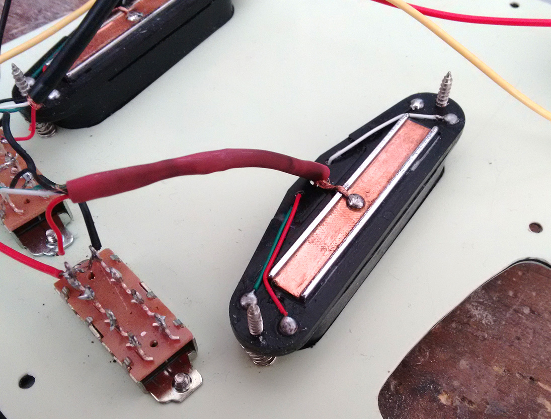

    After conducting some experiments, I have come to the conclusion that these rail humbuckers are not separately wired.
    I guess you have to pay a lot more to achieve that.
    Makes having 2x3 way switches somewhat redundant.
    Meanwhile I'm up to 22 coats of Tru-Oil.
    Bottle is fast running out so contemplating getting another one.
    cheers, Mark.
