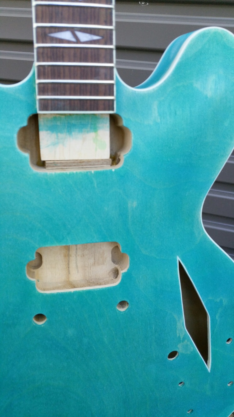

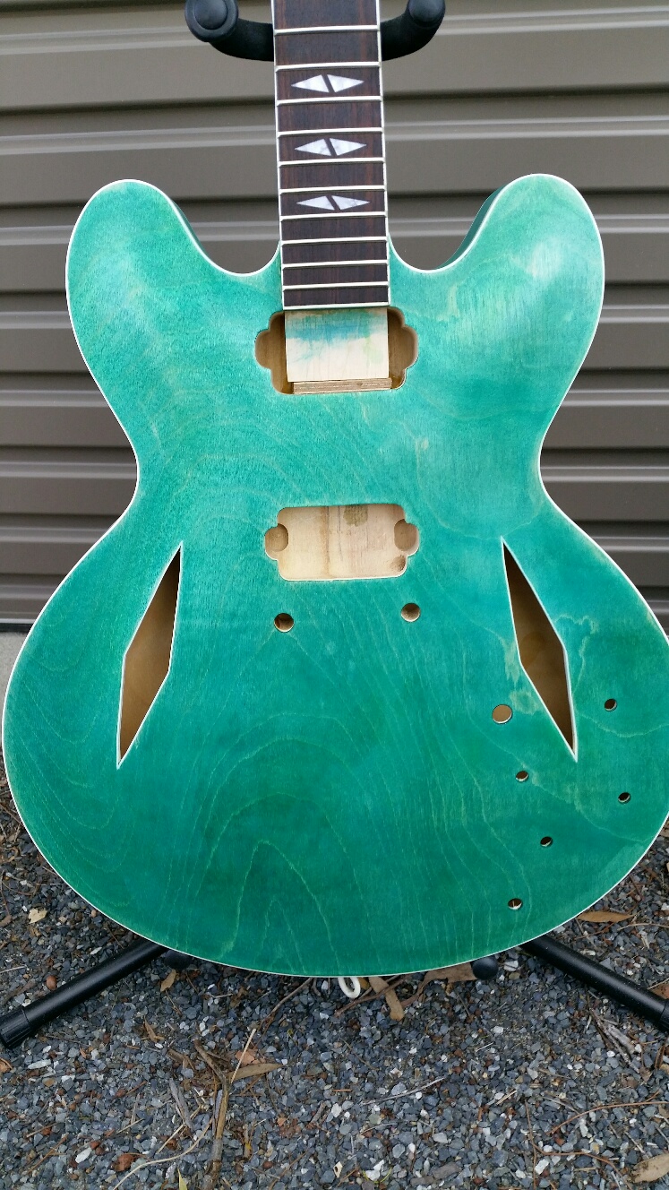

    It came up in another thread and I thought it is relevant to add on this build diary.... setting the neck.
    On most set neck kits I've done there is considerable leeway on the position of the neck relative to the body, but there is only one correct position.
    When setting the neck you are dealing with the body, the neck, some glue, some heavy and awkward clamps, at least two strings and a long measuring device such as a steel ruler or tape measure. Reducing that count by one at this critical and busy time can make a huge difference. In my case it was the ruler that had to go.
    After finding the correct place for the neck in the body (by measuring from the 12th fret to the point the strings land on the bridge) I noticed a gap between the end of the neck and the back of the PU hole. Once the neck has been set this gap in the long run will never change so I fashioned a small piece of wood (ply in my case) to fill that gap as best I could, and glued it in place prior to setting the neck. Now when I go and glue the neck in (setting the neck) so long as the neck tongue butts up against this piece of ply it will be at the correct distance between the 12th fret and the bridge. and thus eliminating the need for a ruler at that busy and complex moment of building a set neck guitar.
    A year down the track I've noticed as a side benefit it does increase the strength and rigidity of the neck-body join, thus helping in tuning stability of the guitar build with varying temperature and humidity. For those who are concerned if negatively affects the 'tone' or the sustain of the guitar I can tell you it doesn't, if anything I think it improves it...
    It's a gawd awful pair of photos but it demonstrates the construction issue point extremely well...
