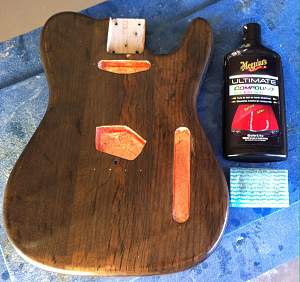

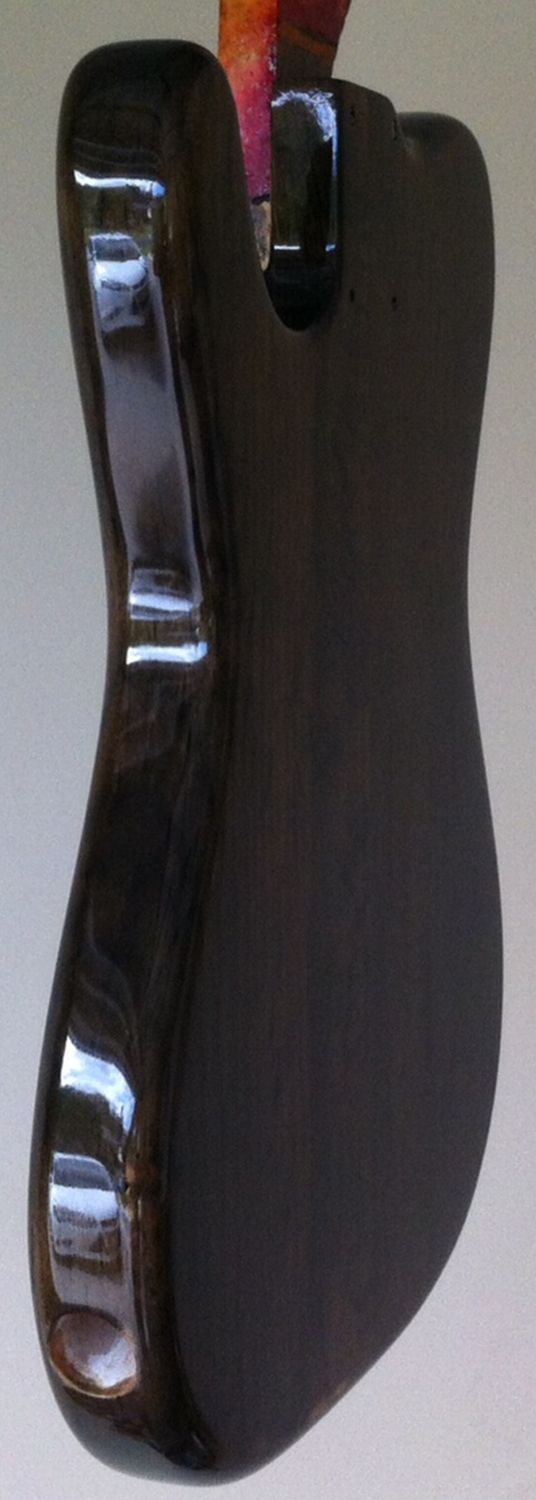

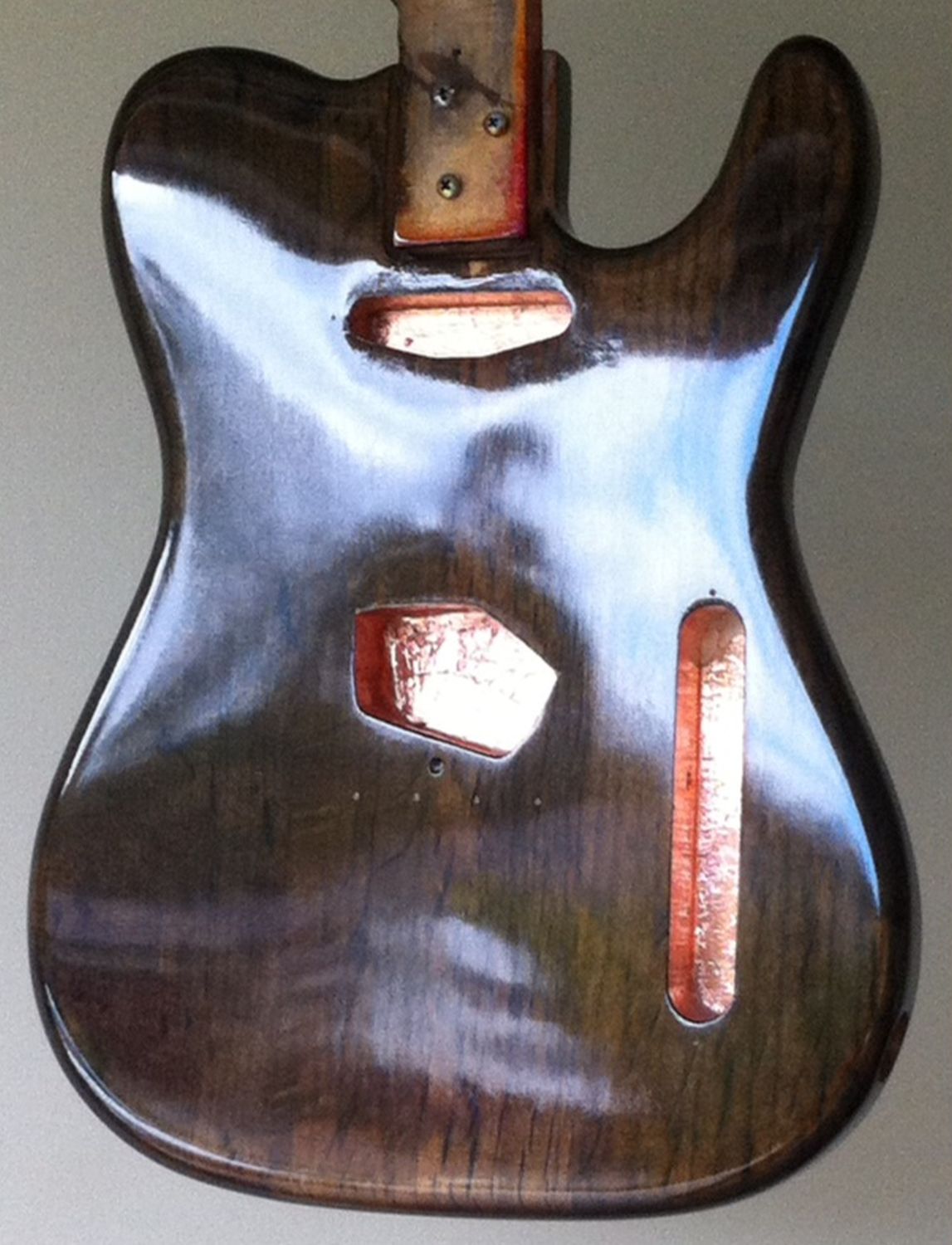

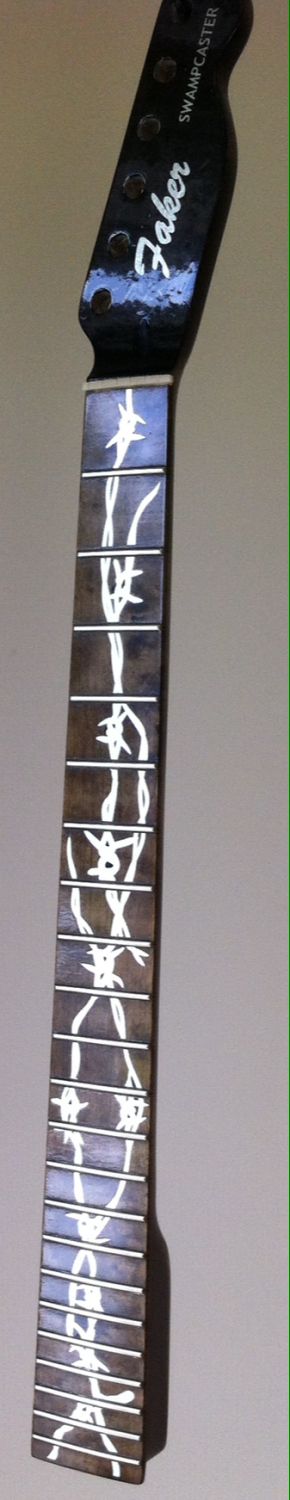

    About 6 weeks ago I was doing the final polish and accidently bumped the work bench and face planted the body onto garage floor. Great if I was trying to do a relic but that was not to be.
    Anyways after having a carefully sanded back and applied god knows how many coats of TO (well past 30 and maybe even 40 coats) I had an RDO today and began the final wet sanding and polishing stages again for the 2nd time. Here is some evidence of today's activities...
ID:	20658Click image for larger version.
ID:	20659Click image for larger version.

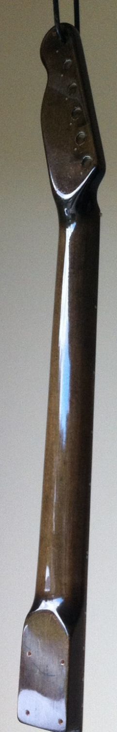

    Neck has been done for ages and side edge of body has same amount of shine without any wet sanding yet.

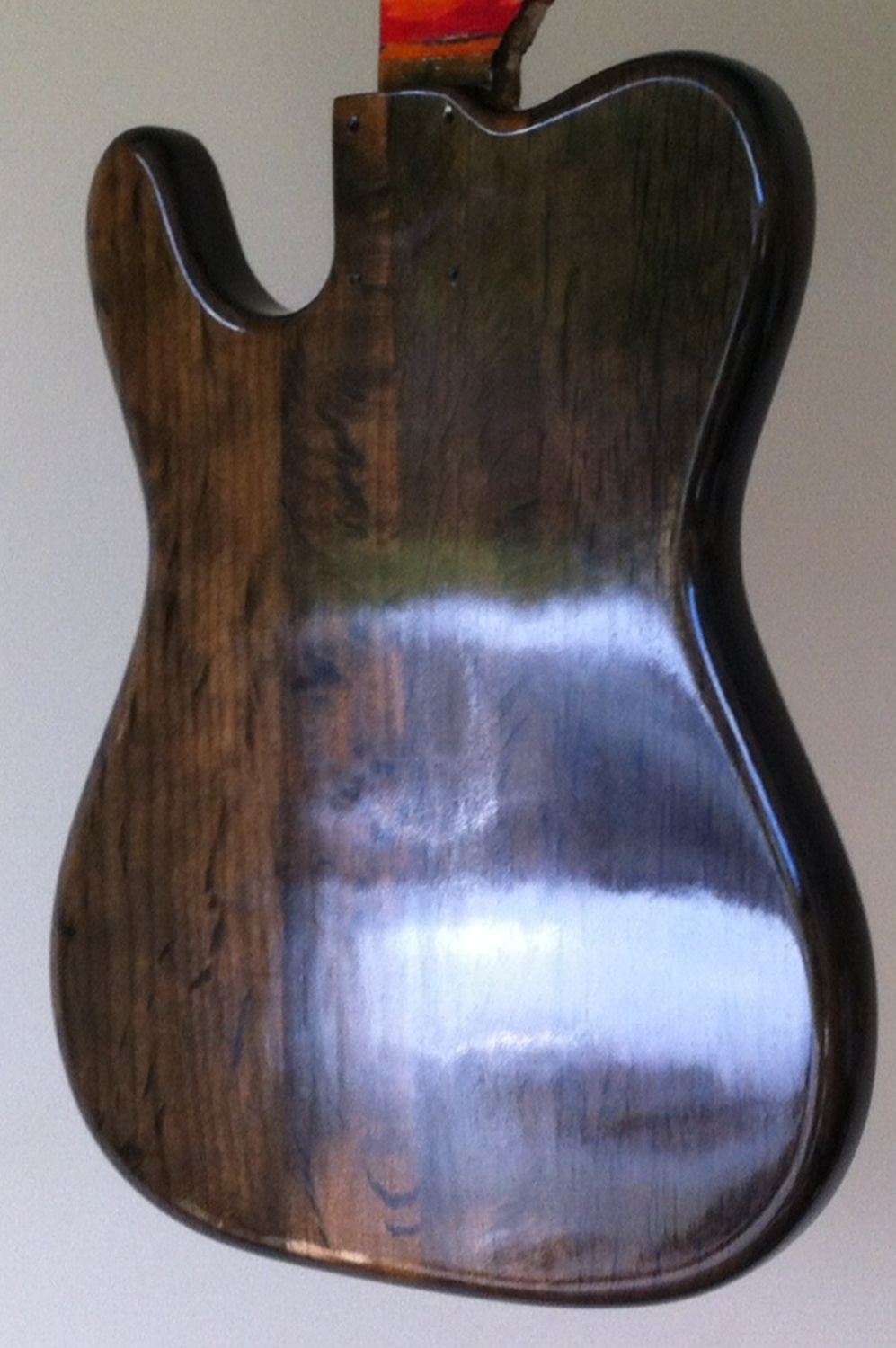

  6. #116

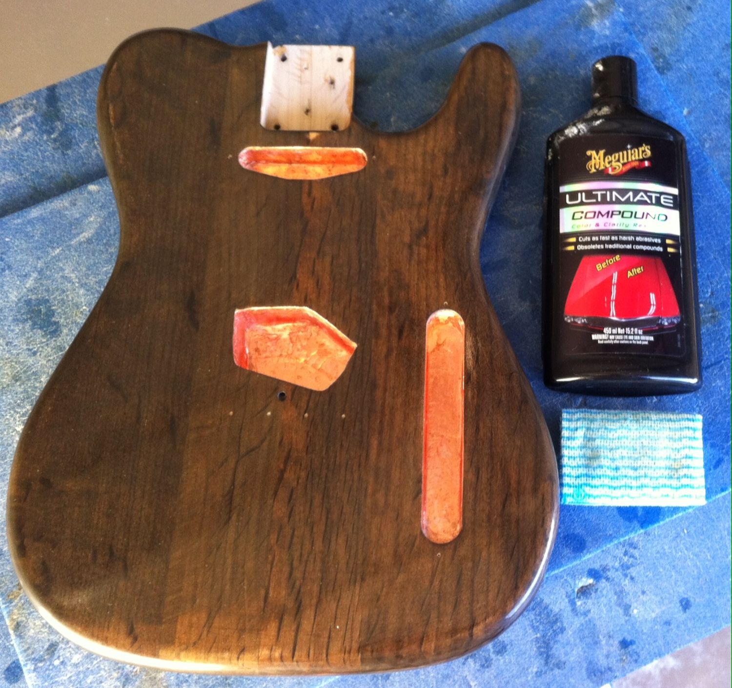

    Here are some front & back shots before starting the wet sanding...
ID:	20662Click image for larger version.

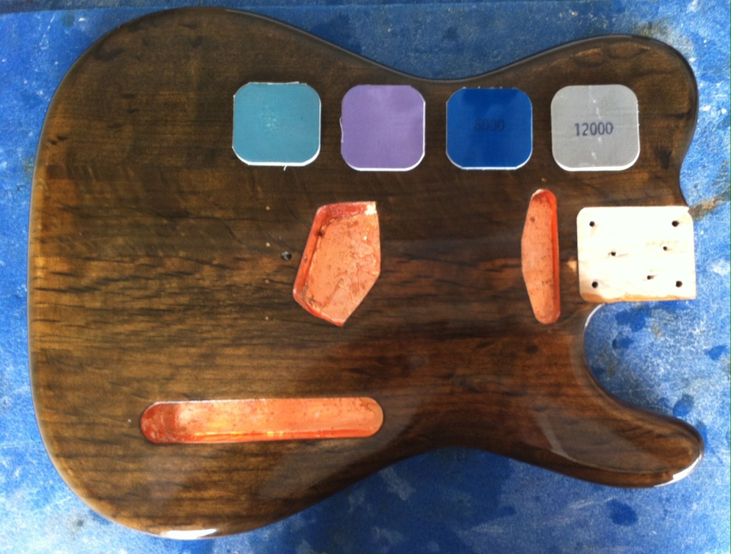

    Now with all the micro mesh pads lined up ready to go...

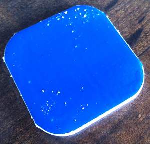

  7. #117

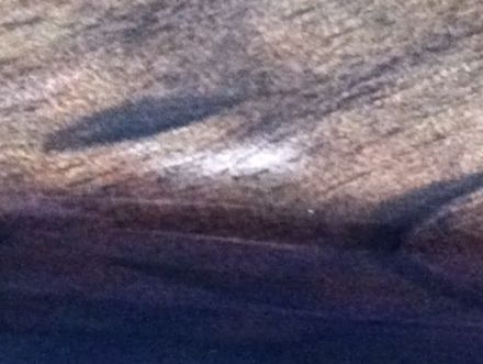

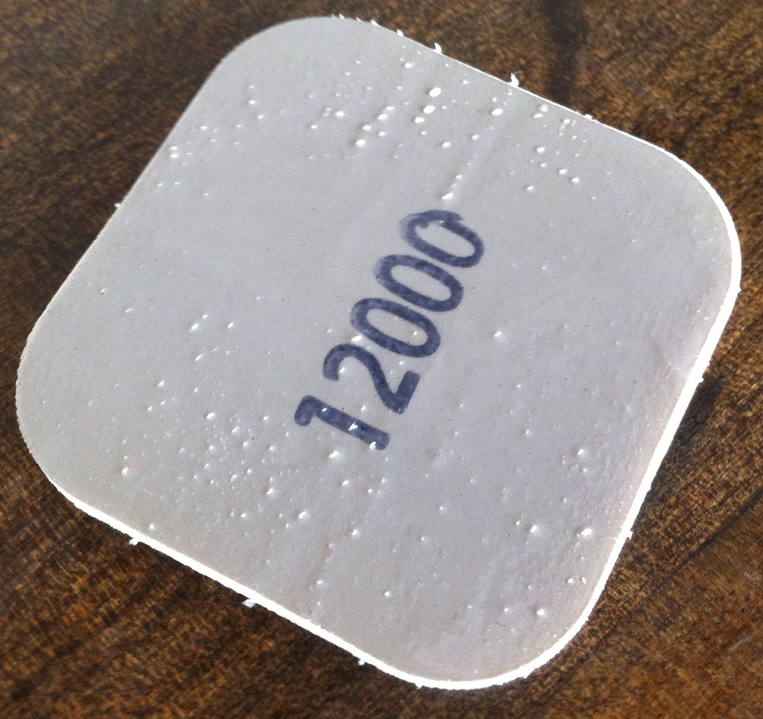

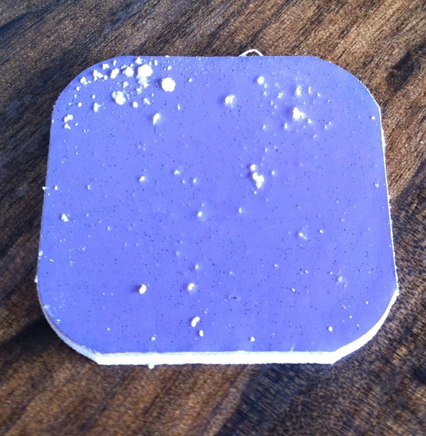

    Some of the numbers have already been worn off the 4000 & 6000 micro mesh pads. Here are some close up shots of the fine grit particles that these micro mesh pads bring up, and this is after wet sanding to the smoothest level possible with the previous level of grit.
    This is the 6000 pad...
    Now the 8000 pad...
    And finally the 12000 pad...
    Surprising how much grit these things pick up from the finish, even up to 12000 grit

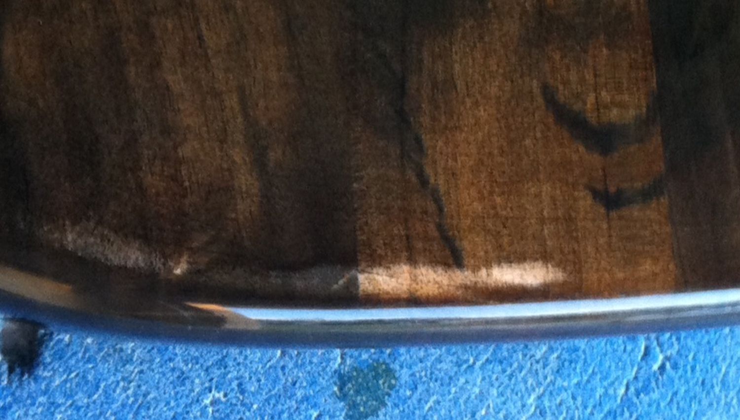

  8. #118
    Next stage was to start using the car polish...
    Unfortunately burnt through a couple of edges that now require touch ups.....a minor set back that will hopefully only take a week or so to get right.
ID:	20669Click image for larger version.
  9. #119
    Bummer Waz those pesky edges it is so touchy they never hold enough clear coat.. you will make them disappear in short order. Looking good.
