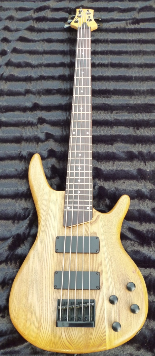

    Hi Toshi I found the build diary to my IB-5, I realised its not finished, I will dig up some finished pics.
    It was finished 2013 so the stain is wudtone Amber, this was before Dingotone was available
    http://www.buildyourownguitar.com.au...ead.php?t=2059
    here Toshi finished pics. I have since removed the speed bumps (frets)

    Thank you for the link and photo, Wok. It is very beautiful and nice golden color, good works! Now feel i would like to try IB-5... by the way, is it your workshop? looks very nice.

    thanks Toshi, I think if you put a active pre-amp in an IB-5 it will sound great. The build diary yes that is the workshop in 2013, it has evolved since then. Its just a pine and mdf workbench I built at the back patio of my house. Was 1.8m long when first built and we outgrew that so extended it to 3m long

    Wok, PU replacement is exactly what i was about to ask. If i go for IB-5, I was thinking to replace with passive pu from EMG or else. but agree Active should be better option. Only complication of wiring might be issue for me. been looking for suitable replacement, but so far, not sure which one can be replaceable... Just in case you have any idea of brand or model, could you advise? The 3m long workshop sounds nice&cozy. i like your tool board with device shape line. easy to put them back their place! As long as i stay in singapore, not possible to have though, once i went back to Japan, I really want to build one.
