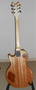

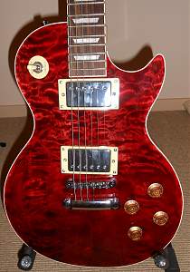

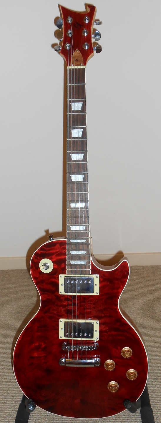

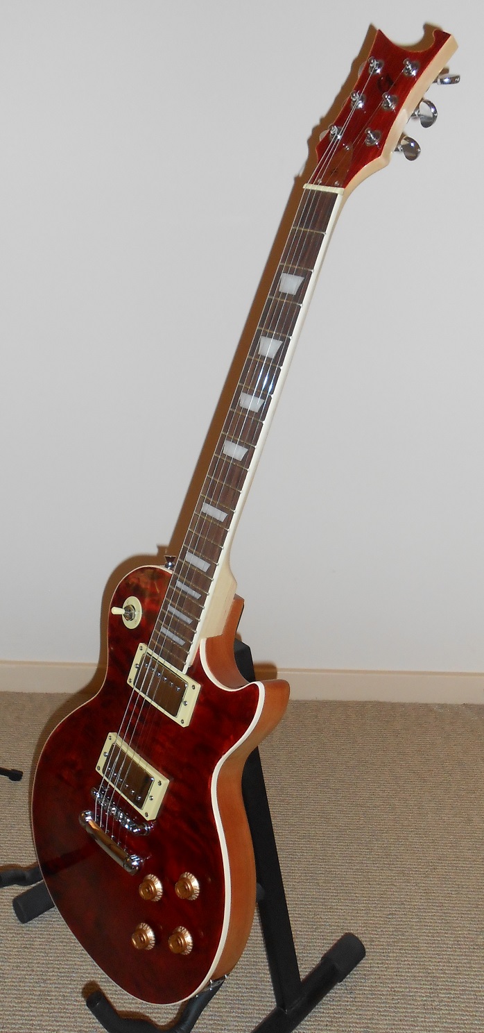

    Done at last. Never thought the time would come. She plays and I am very happy with the finish and the quality of the sound. She it a straight out of the box PitBull guitar. She has assembled and intonated perfectly - for a rank amateur anyway but I could not have done any better.
    Thanks for all your help on the forum. Makes the project so enjoyable and helps to quickly develop the GAS. I will be back soon. The electronics is a whole new ball game so I will need more advice that for sure.

    Missed one

    excellent looking build Greg well done, did you make the timber switch/control covers/truss rod cover ? they look great I never noticed them before.
    Make sure you enter February GOTM, this is a definite contender !
    Damn it I love quilted maple so will have to add one to my to do list ! haha
    if the only problem with the electrics are the knobs are in reverse you can live with that for a while !
