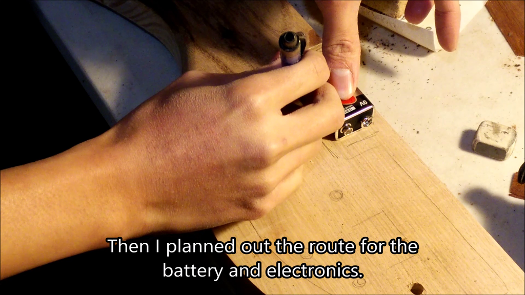

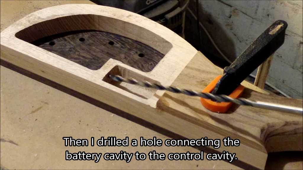

    With the cover all settled, it was time to route out the electronics cavity. I drew out the layout I wanted for a volume, pickup blend, passive tone with a passive switch, and a 3-band active EQ.
    Then I made room for a battery compartment and for the preamp to sit. Having a larger control cavity means lesser weight and more room for any cool mods to be done in future.

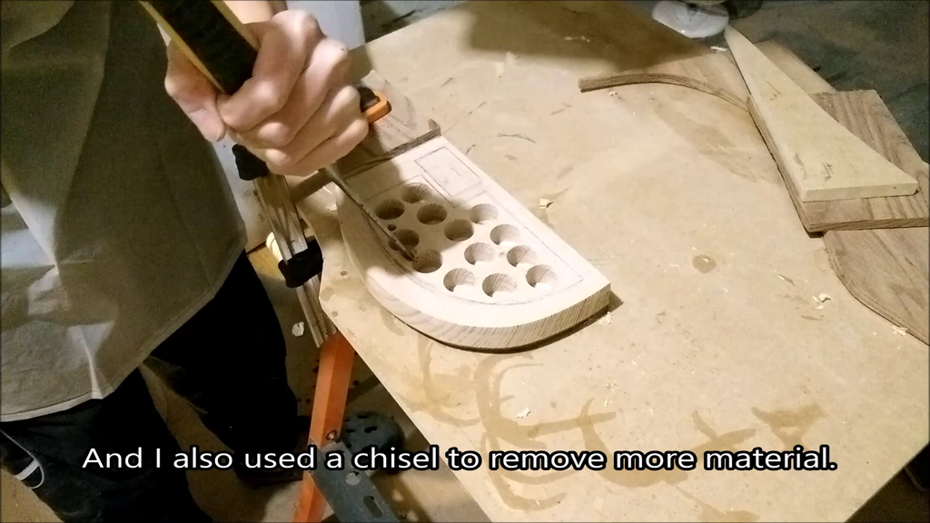

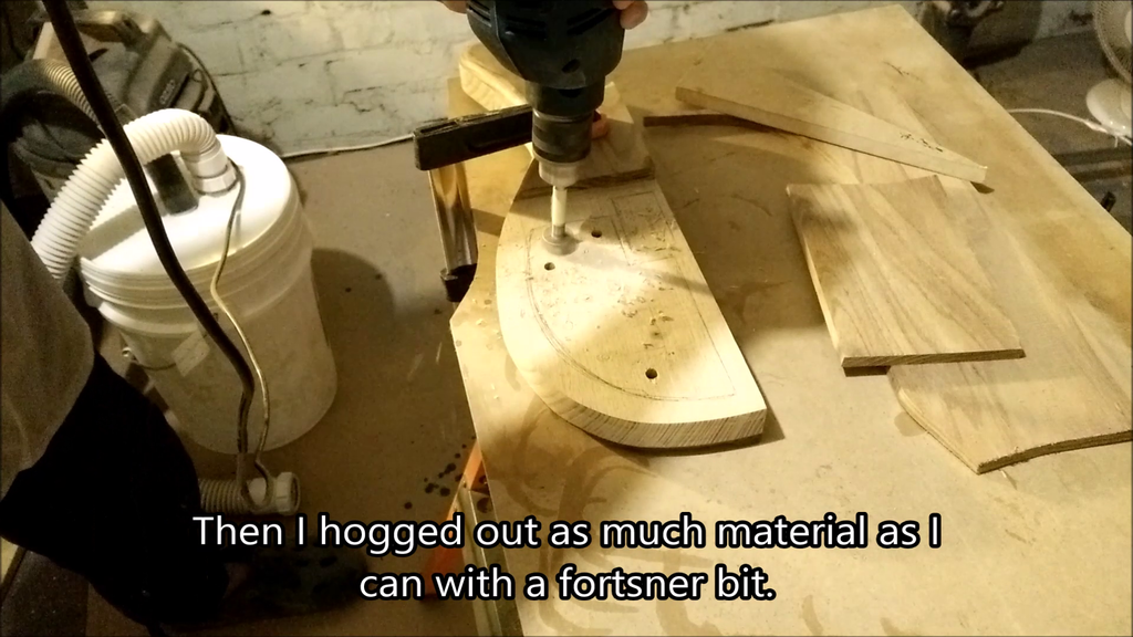

    Then I proceeded to hog out as much material - this is standard for routing any cavities. This helps relieve the stress on the router bit.
    Another smarter way would be to precut the cavity shape on the Vic ash itself, but I didn't do it because I hadn't planned for the layout way back then.

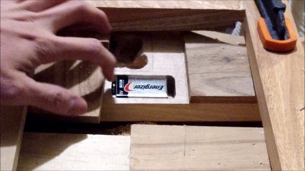

    The battery sits nicely and there's plenty of room for the battery snap plus some cushioning foam.

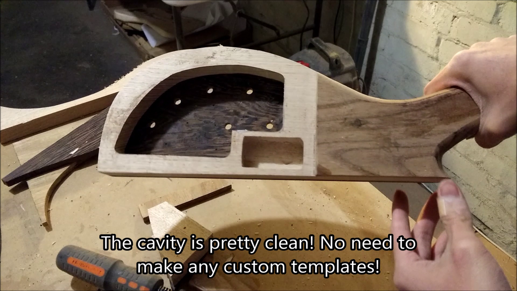

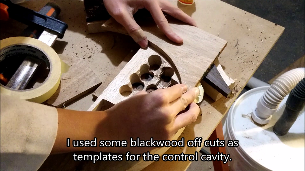

    It was tricky to route the control cavity because the piece of blackwood which was glued on severely restricted the movement of the router. The smarter way would be to precut and preroute the Vic ash before gluing on the blackwood but this was done some time ago.
    I then used some blackwood offcuts as makeshift, temporary templates for the control cavity. Didn't want to make anymore templates!
    It came out looking nice!

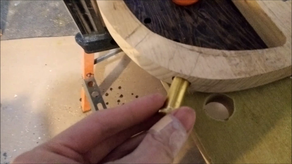

    Then I connected the cavities together.

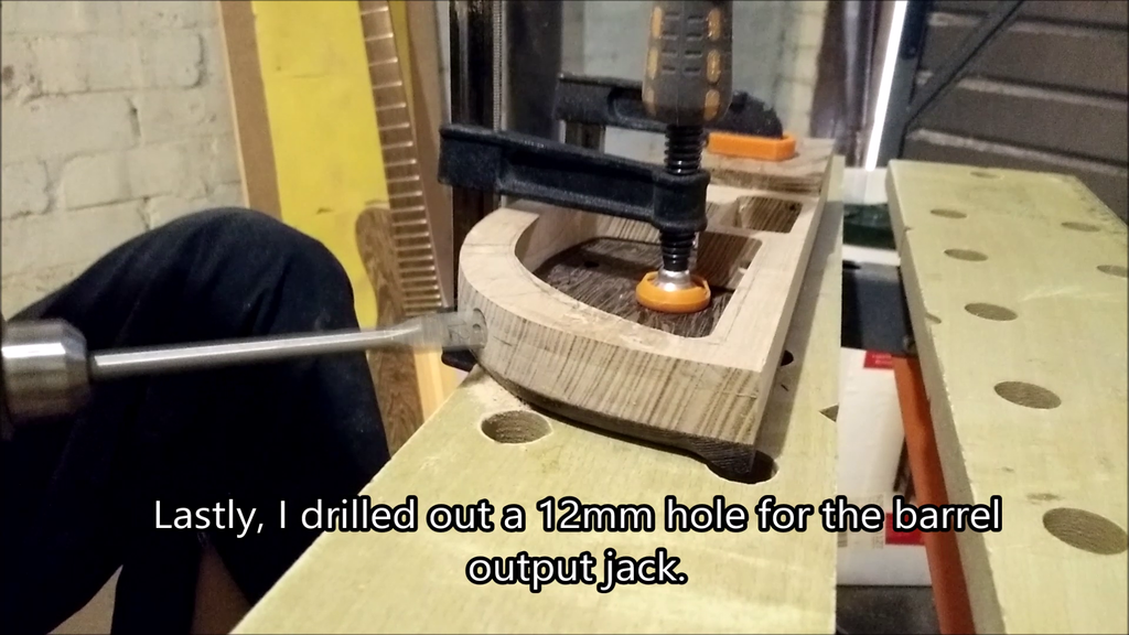

    And finished it off by drilling the output jack hole.

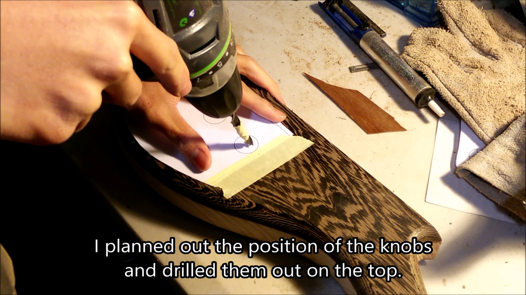

    Thanks woks. I drilled through the top for the pot holes.
    ah ok Simon all good mate, I had a moment where I wasn't sure if the holes were there for a reason ! great stuff
