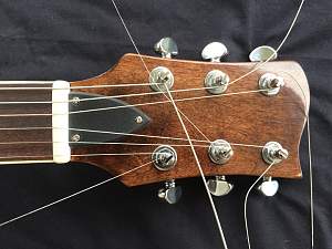

    Well after months of not knowing whether I was wasting my time or not I finally got to hear her. And I am so relieved that she works. Tuning was somewhat of a problem, as she wouldn’t play in tune anywhere on the fretboard. As it was a PBG neck I knew that wasn’t the problem, so it had to be the nut and/or bridge saddle.
    I had already cut the bone nut fairly low, but tuning problems over the first few frets is usually nut related so I got into that and lowered the slots by about 1mm but it made all the difference.

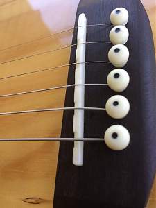

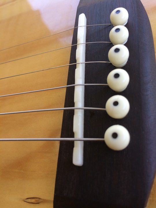

    Next, intonation, and (a first for me) to compensate the bone saddle. The original position of the bridge was spot on (phew) as the “e” and “G” strings intonated perfectly, but the others were out by anything up to about 10+ cents.
    I then began the painstaking process of filing a bit away from the nut, bring the string up to tension, check intonation, loosen the string, file a bit more off the saddle, re-tension, check intonation, loos………. Well you get the idea. This is done with each string. With the amount of times I have loosened and re-tensioned the strings while cutting the nut and saddle it’s a wonder that the strings have any tone left in them.
    But I finally finished and intonation is good to within 2 or 3 cents at the 12th fret measured on an iPhone App. Its not perfect but as acoustics are mainly played below the 7th fret its as good as I could get it. Bottom line is I am REALLY happy how she turned out. I can always cut a new saddle at a later date if I end up not happy with it.
    I used my 12” radius block to rough out the shape of the saddle

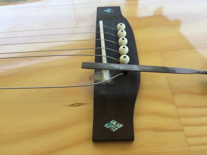

    Then strung up the guitar and worked on each string until I was happy with the intonation. For a noob like me this was pretty time consuming, as I had to "sneak up" on the scale length for fear of filing away too much.

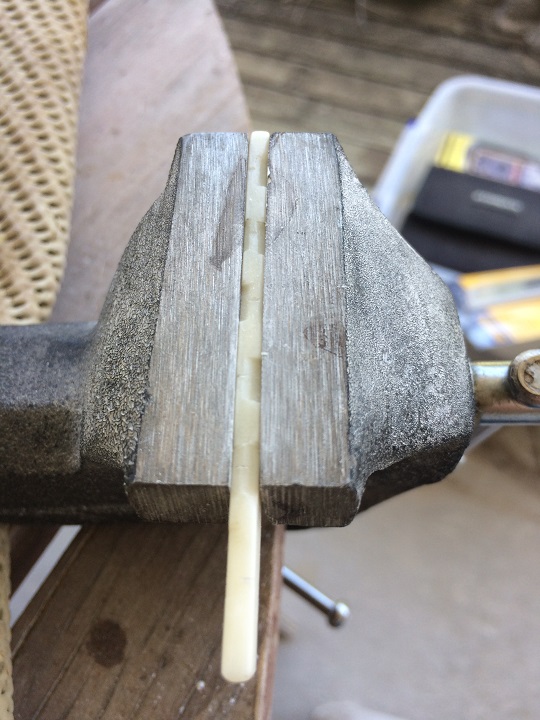

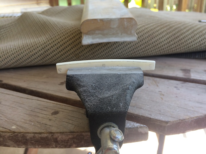

    Once I was happy with the intonation I removed the saddle again and finished up shaping the saddle in my hobby vice.
    Done!

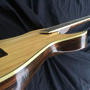

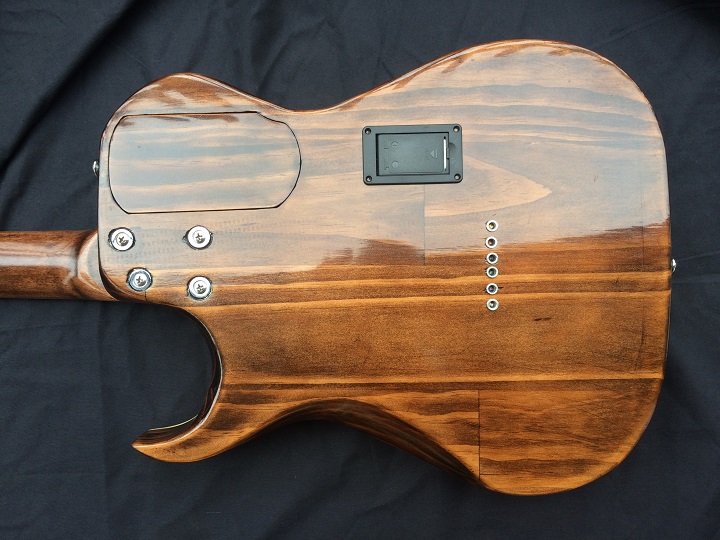

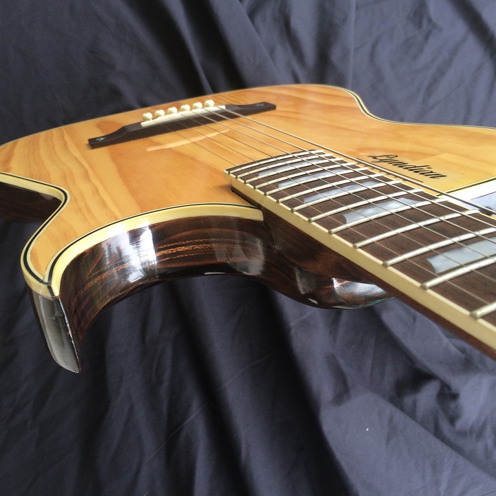

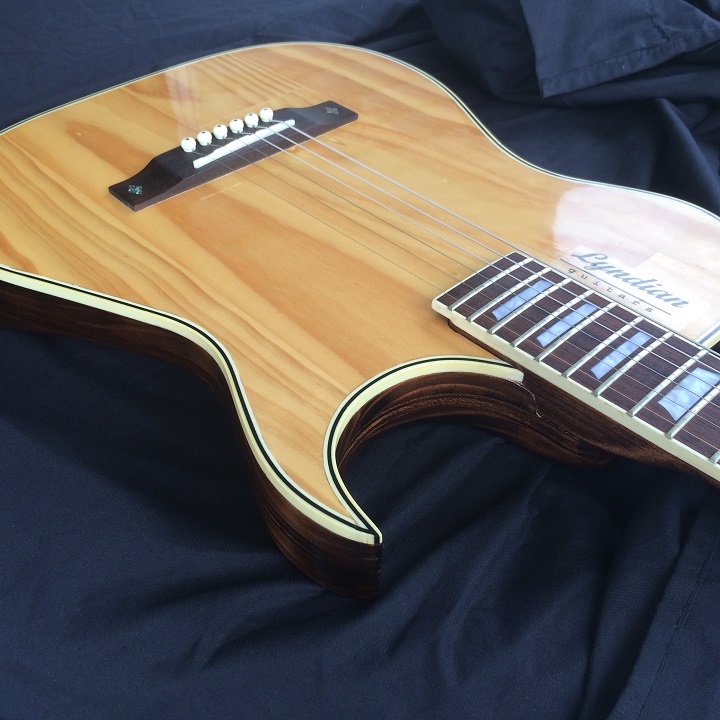

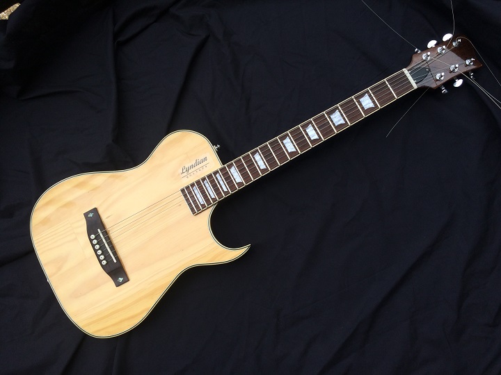

    I never expected it to sound exactly like an acoustic, but to my tired old worn out ears she doesn’t sound too bad. I’ll be using her at church but will be playing with other electric guitars so she should add a bit of jingleness to the overall sound. I also hope to use her in future home recordings where I can tweak the sound a bit so it sits nicely in a mix.
ID:	15592 Click image for larger version.
ID:	15594 Click image for larger version.

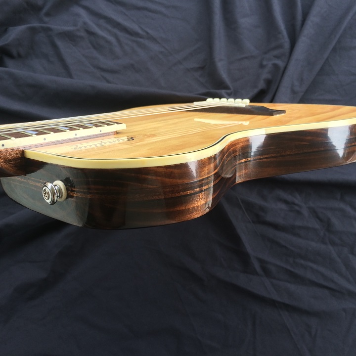

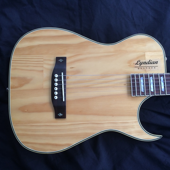

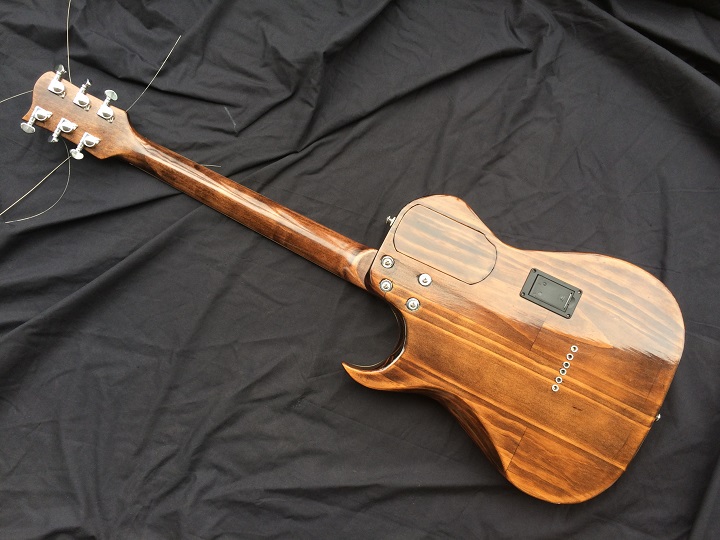

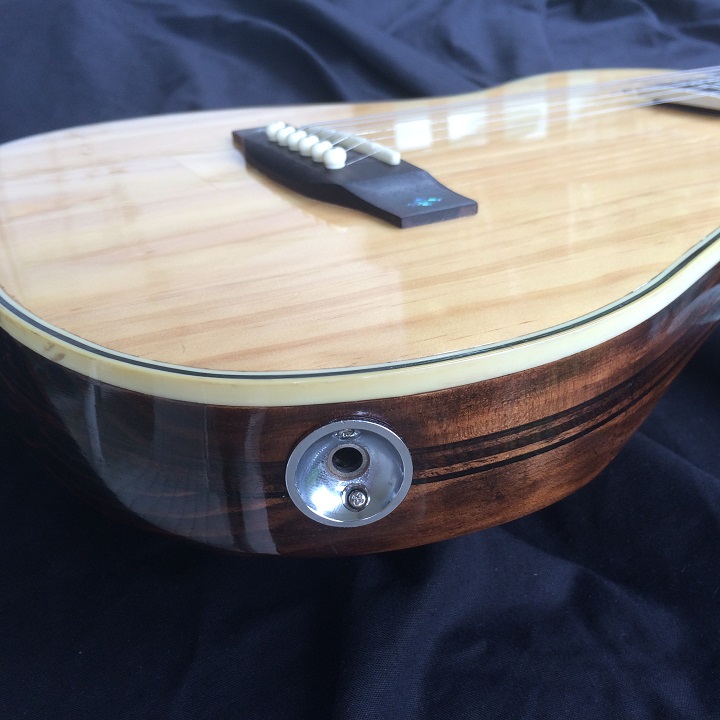

    And now some close up shots
ID:	15603 Click image for larger version.
ID:	15605Click image for larger version.

    Dang it Robin! If it plays half as good as it looks you've got a winner.
  8. #118
    Beautiful well done
    Sent from Android N
  9. #119
    looks unreal Westie ! Are the equaliser controls in the back cavity ? Couldn't see them exposed. Love the simplistic look of the front with just your logo and bridge. Top job mate and glad it will fit will in the church band
  10. #120
    Wonderful bit of work Robin. You've created a beautiful object, really looking forward to hearing a sound demo of it.
