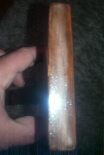

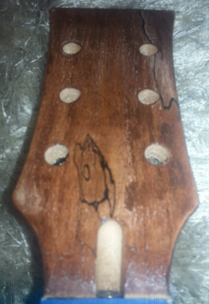

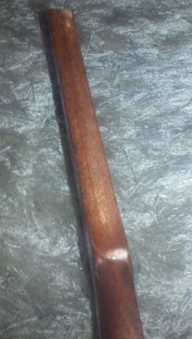

    Here's some images of the neck with similar issues. You can notice on the corners I have over sanded. I was thinking of sanding back to the wood and staining again to cover up those lighter parts:

    Over sanded on the corners here and lost the cedar stain.

    Hi Alkay, yes I agree think it's worth sanding back the neck and re-staining. Looks like there is tru oil on the neck ?
    While you are doing that be a good chance to shape the top of the headstock.
    Yes, 9 coats of Tru-oil as well. I think its just mainly the sides of the headstock that look the least appealing, although the spalted front has some over sanding. Maybe I could just re-stain the sides, top and front of spalted head stock?
    The rest of the neck from the head stock down to the neck heel is super super smooth. (I know not to apply TO on the flat surface that bolts into the neck pocket).

    Hi Alkay, sure you should be able to patch up the lighter stained areas but you risk having trouble matching the stain colour. See how you go. You will obviously have to remove the tru oil on those parts. If the patch up doesn't work that well you may have to sand it all back and start again.
    Up to you if you shape the headstock but to me it will personalise your build and get rid of that butt ugly square top !
    Stain in the neck pocket and neck heel is only a problem for set (glued) necks, as this is a bolt on it won't make any difference.
